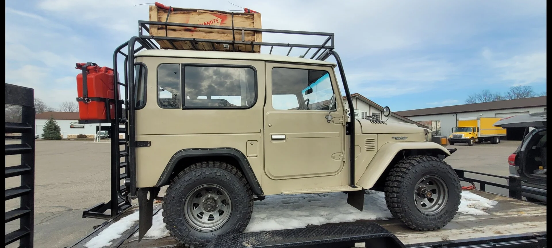

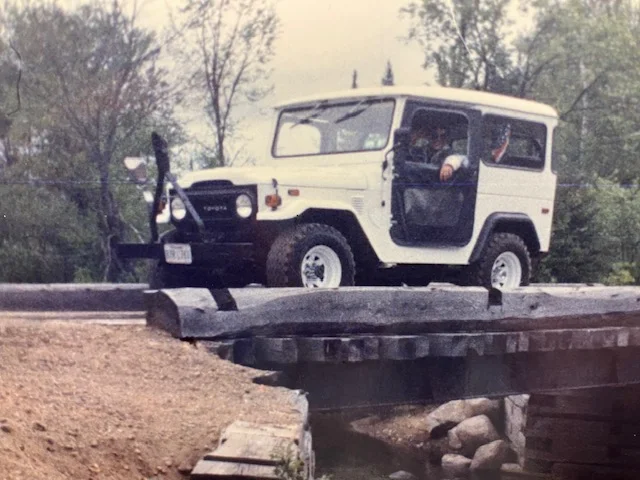

for comparison.... my truck 30 years ago 31x10.5 stock saggy springs
and fjguru with 33x10.5 stock suspension
both cut rear wheel wells ... the width is what kills it... thats why cruisers like the pizza cutters

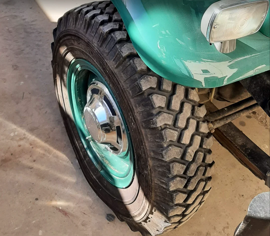

Even here they are very rare with the clips, only 1974 and 1975 got the clips (but never the caps).
Had to replace the rings to save them, as they were too rusty, but in good Toyota manner the ring partnumber supersedes all the way up to today 70 series split rims! (And a lot of 5 holes 70 series split rims float around and no one wants them so I scavenged 5 of them).

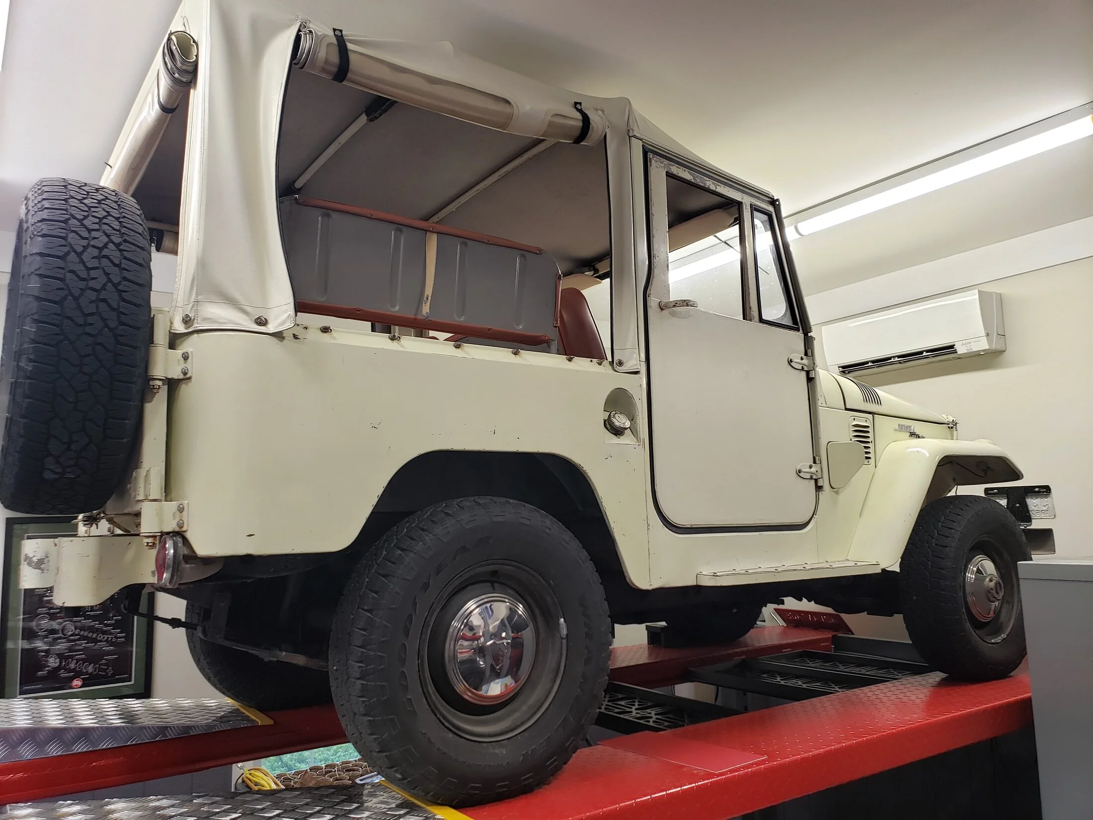

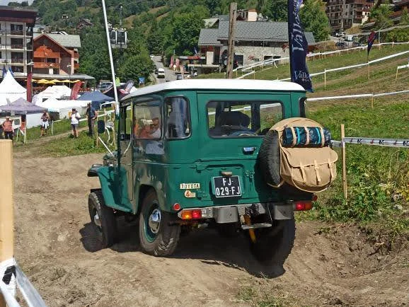

Demonstration that even lifted the tire will enter the rear wheel well (and of my caps still shiny :angelic:).

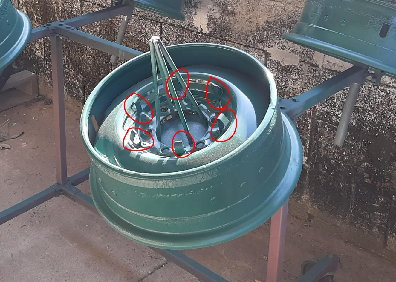

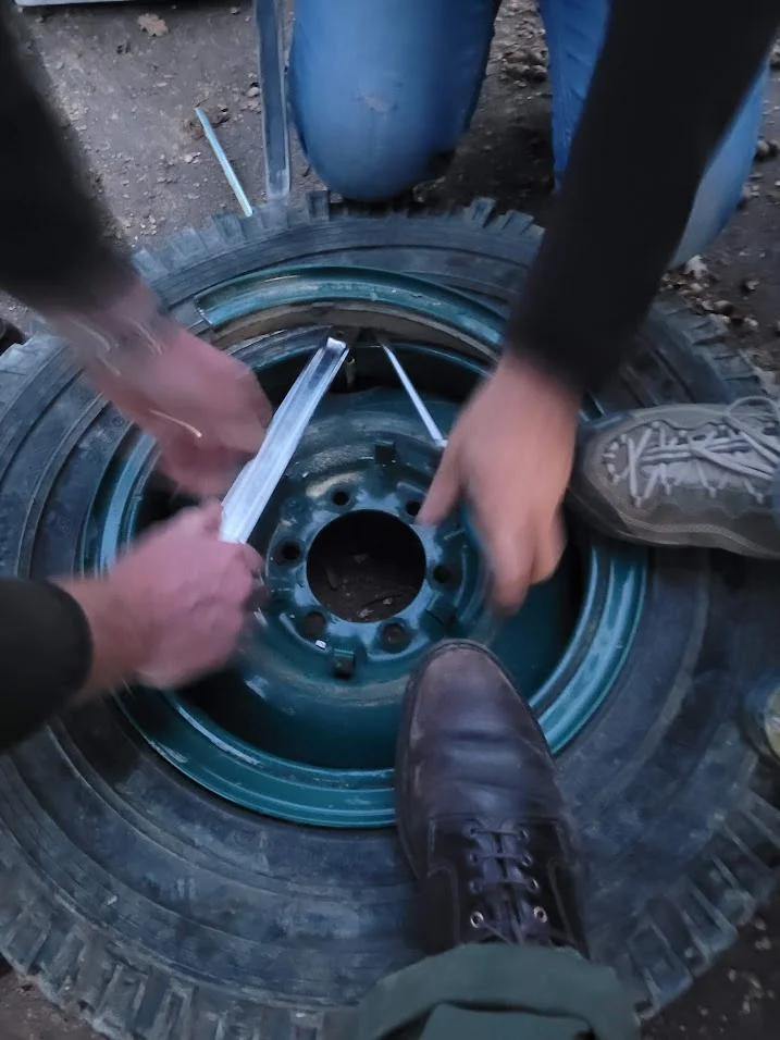

By split he is referring to the fact that my rims can be "split in 2" to install the tire (technically this design should be called locking rim more than split).
In the US the 40 were delivered with a plain rim without this removable ring. The ring allows to install stiffer tire with very basic tools anywhere.
The clips are those little clips which the only function is to be able to install the decorative hub cap.

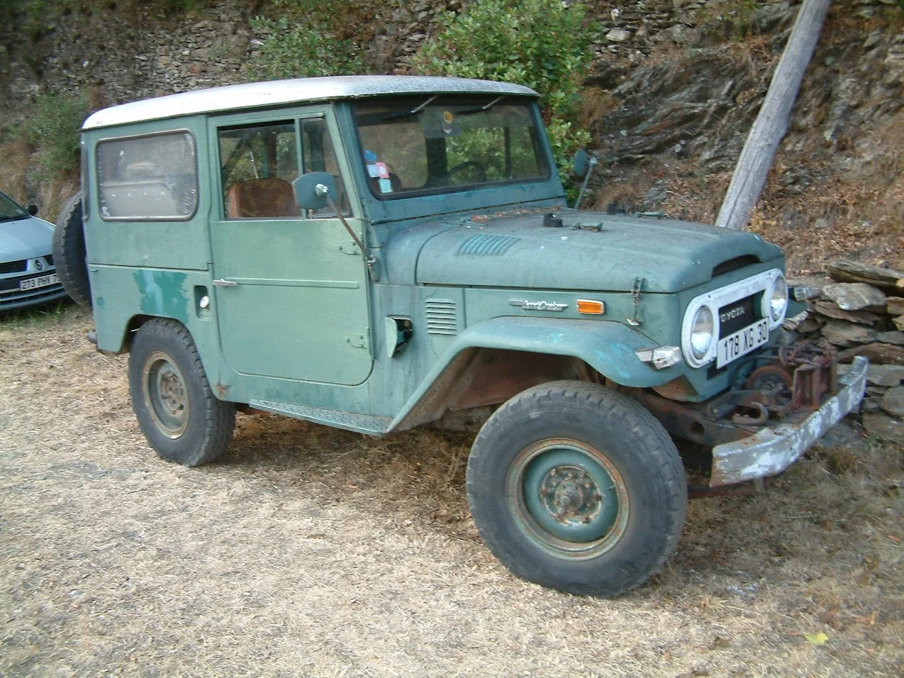

In comparison those wheels don't have the clips:
And this is the only (decorative) utility of those clips:

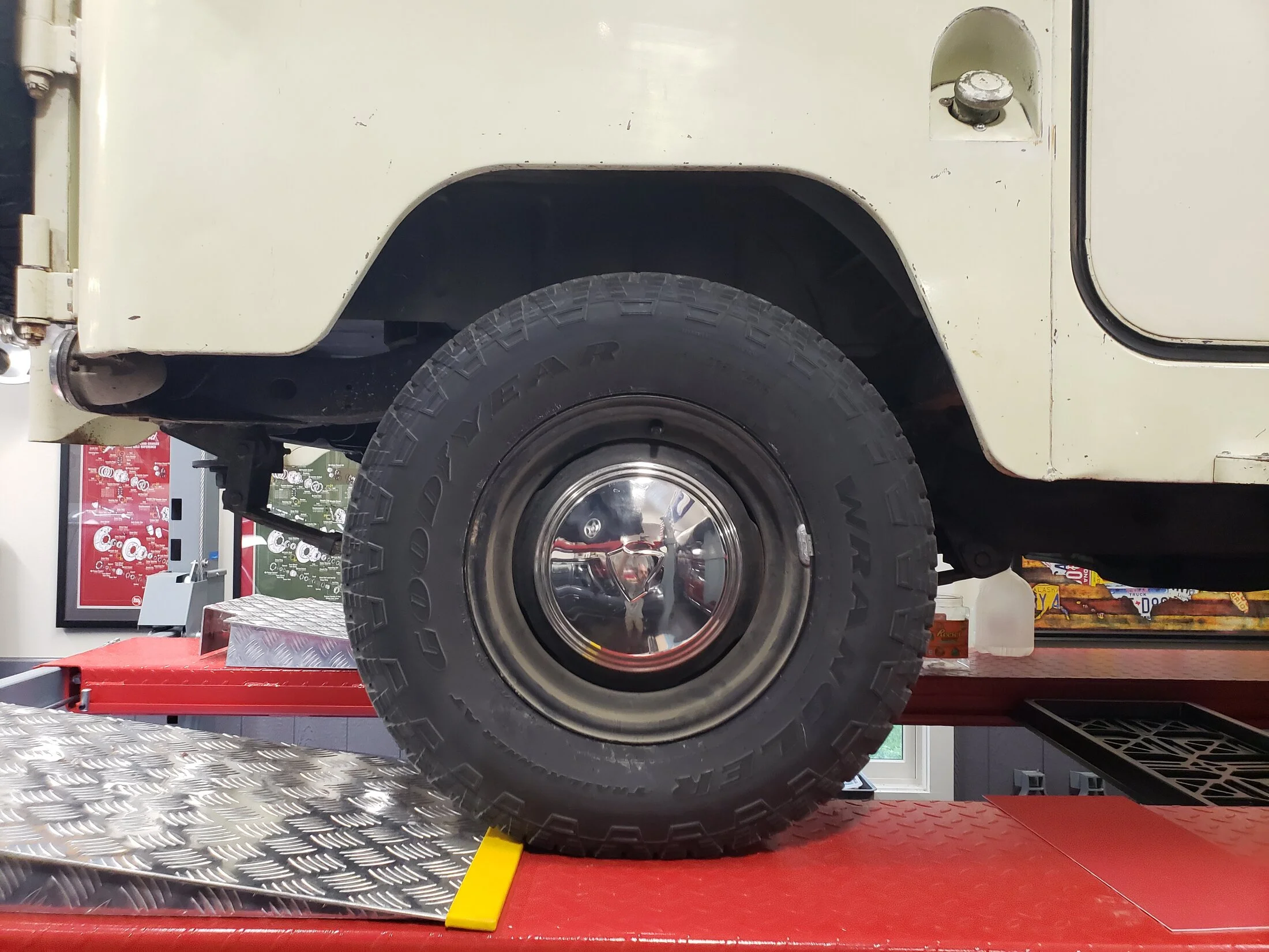

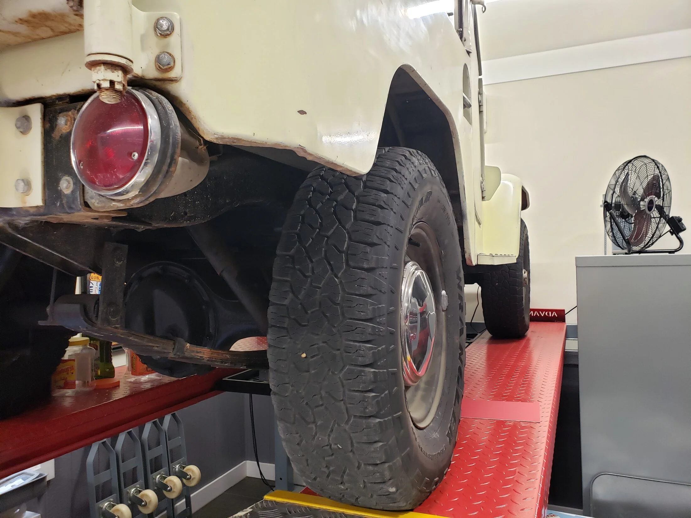

For what it's worth, this my '67 FST sporting some new 235/75R15s. They're super-cheap Goodyear Wrangler Trailrunners.
I believe the springs to be original.
That's a ~29" tire with a 9.3" crossection. A 31" would fit, but I really didn't want to go any wider for fear of possibly damaging the body.
