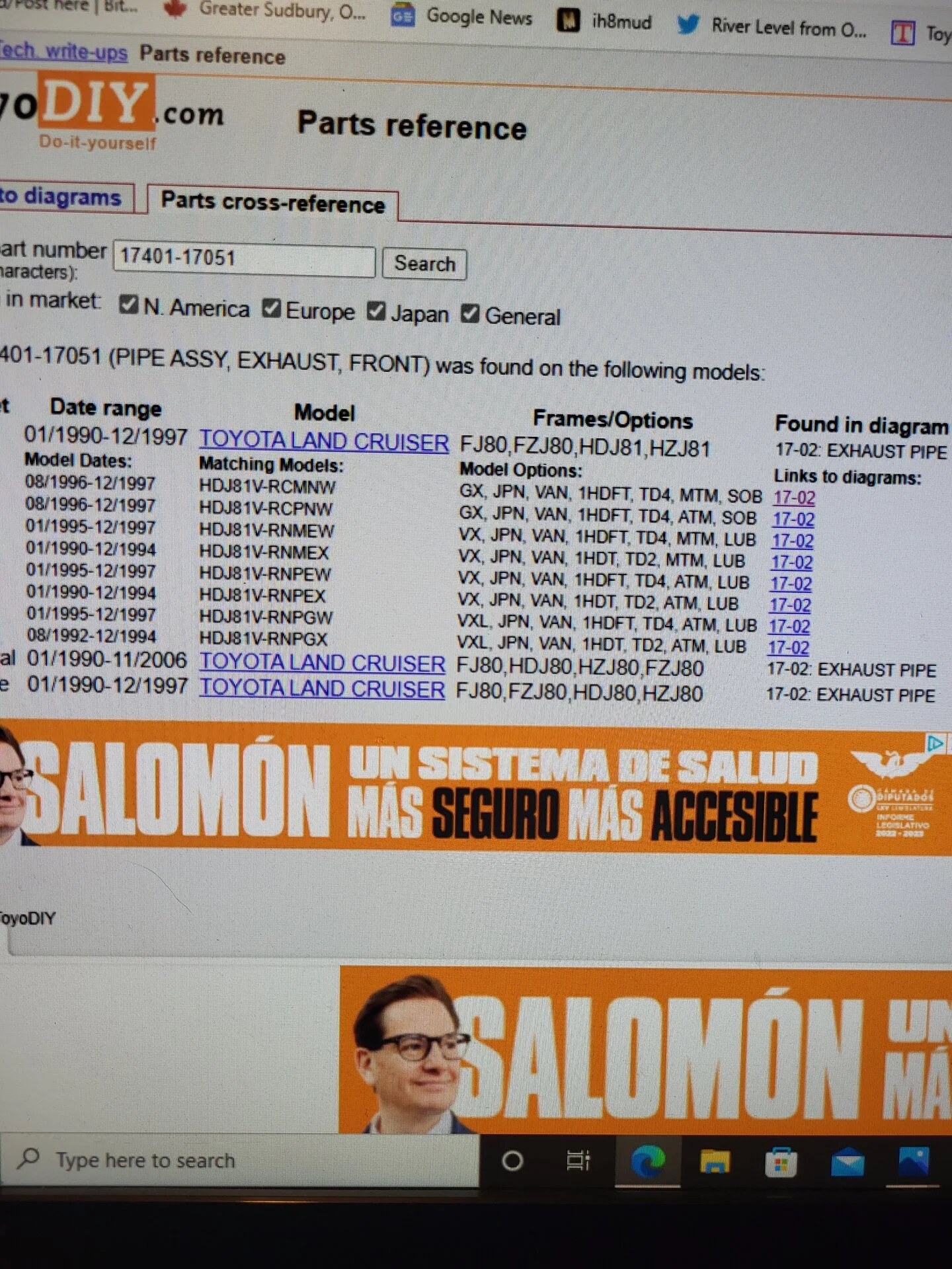

Note: Same part fits the 1990 and runs on into 1997 for Euro versions and 2006 for the General market.
I've run 2 hdj81's and also have a 1995 hdj80. Never seen a cat on either.
