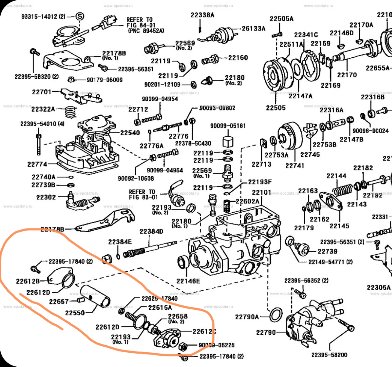

I also found a small leak for IP,

That adjusts the timing advance within the pump.
Not sure if it can be removed/replaced without disassembling the pump
How many miles/KMs on your injection pump? Has it been rebuilt? It may possibly need rebuilt.
