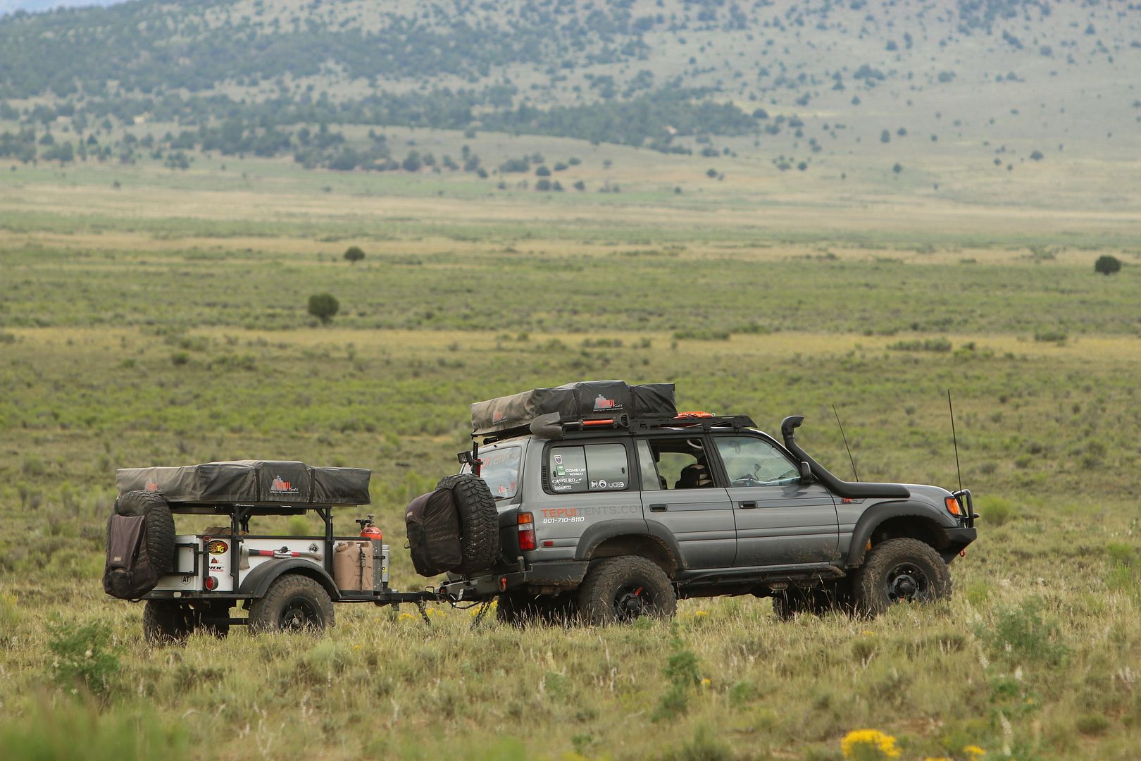

The trailer with the tent is pretty cool. I could see that as my preferred option for many reasons.
If I like the RTT style this will eventually be my route. Funny thing. Had a trailer for the intended for this reason for some time. A RTT just wasn't in my future ($$$) and sold the trailer. Sure enough a used RTT comes along at a price I could chew on and now no trailer. :doh:

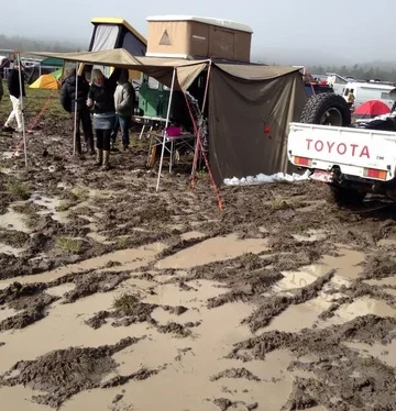

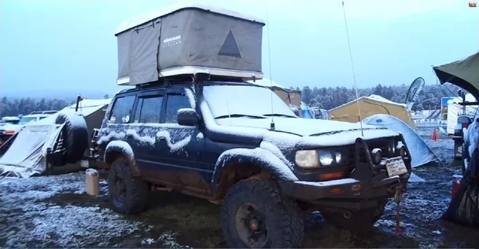

or if you've gone to overland expo west :) ground tenters had indoor pools
[ATTACH=full]1426200[/ATTACH] [ATTACH=full]1426201[/ATTACH]

Well, there's a compelling argument.
