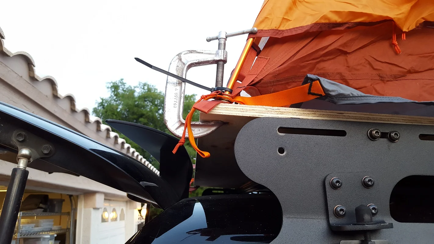

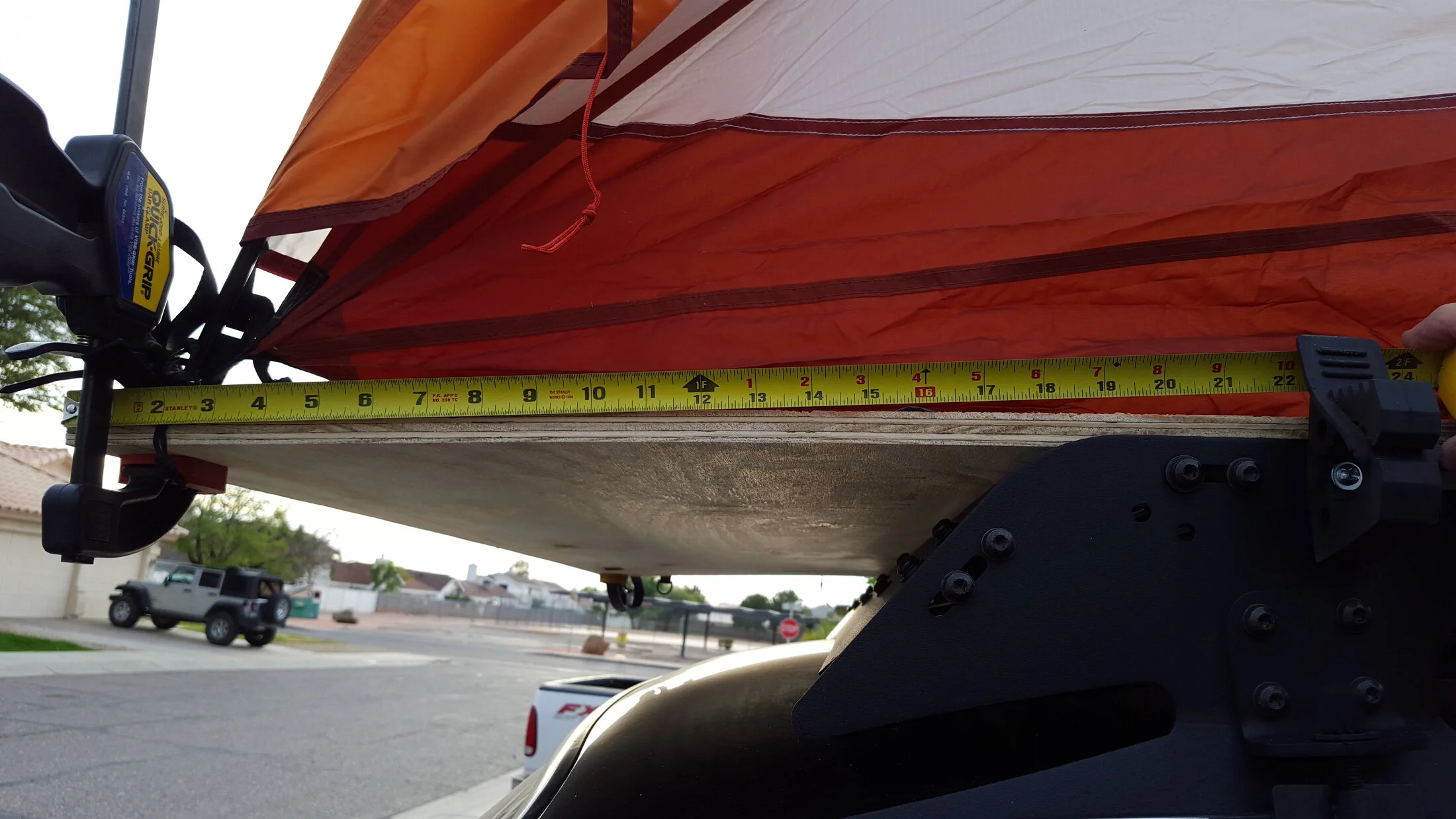

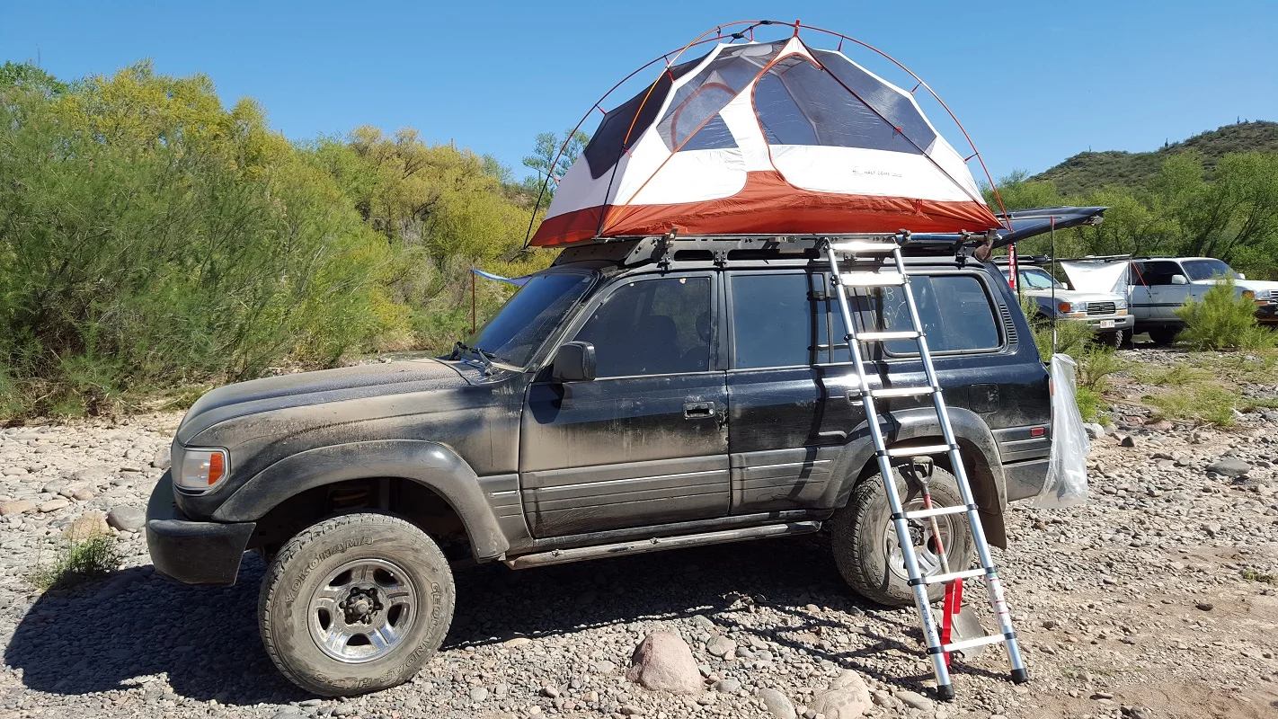

I had the tent out for some reason and decided it would fit on the top of my truck so I tossed it up there and it seemed like a good idea to keep going with it. I had a couple of warped sheets of 19/32 inch plywood cut to use as the base (it's all Home Depot had and I was in a rush for an upcoming run) which I laid up on the rack and moved around for a few hours to get the tent settled before I painted them, installed hinges and bolted them down.
Nothing was working and the tent was very floppy and messy.

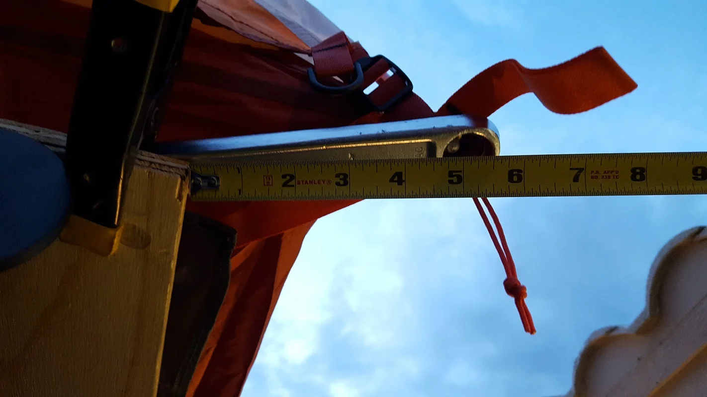

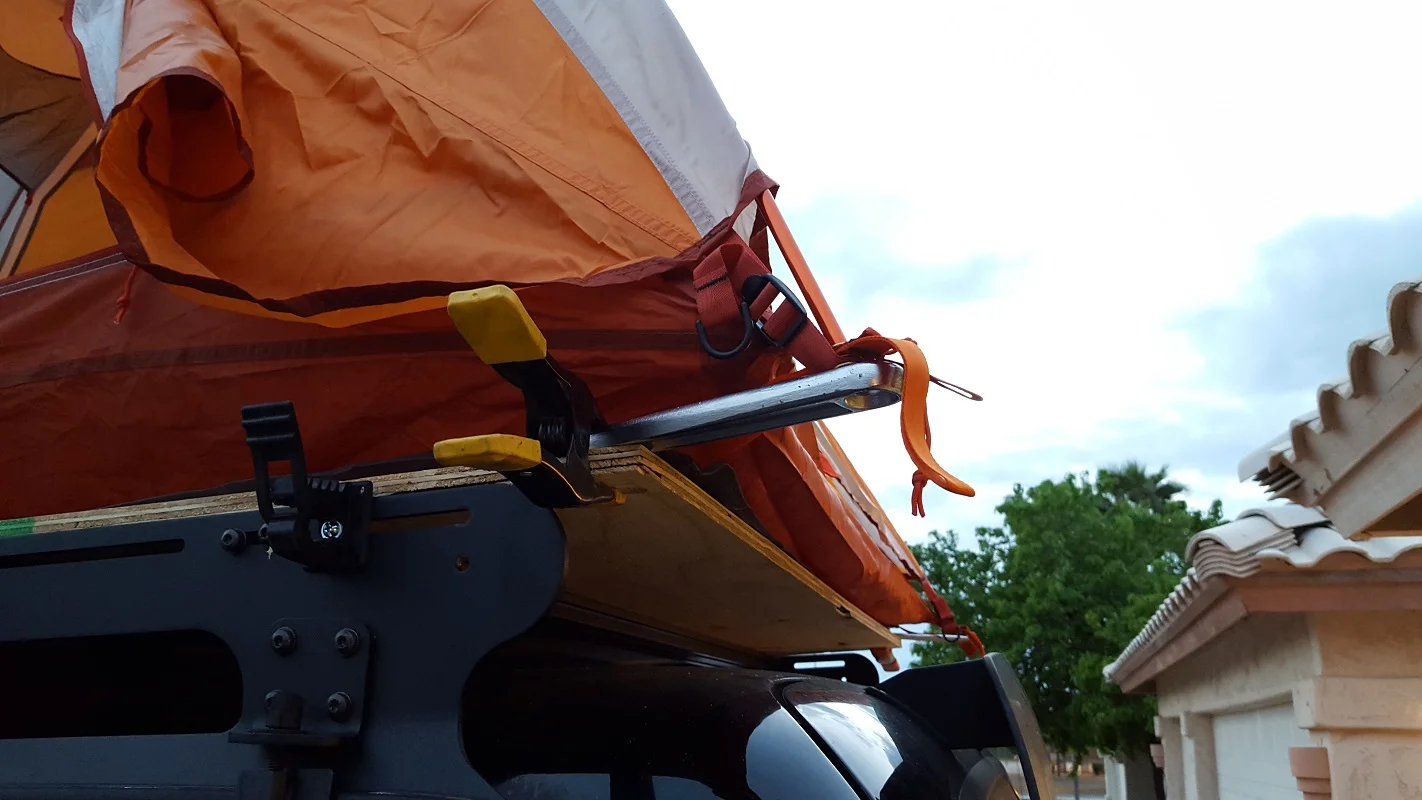

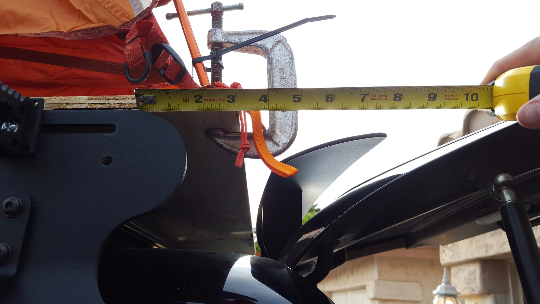

I hadn't considered that the tent poles were protruding another 5" beyond the tent floor.

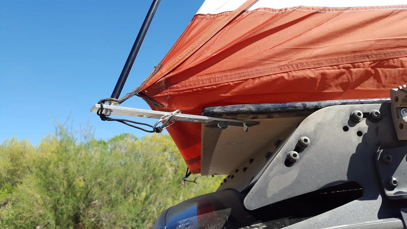

After a couple of more hours, I clamped a crescent wrench to the wood at a 45 degree angle on each corner and used the hole in the handle to wedge the mushroom shaped tent pole tip.
Eureka! This was the solution that I had been looking for! I clamped on 3 more wrenches and the tent came to life. It was taught, secure as heck and due to the mushroom shape, the poles wouldn't pull out of the wrenches.
I picked up some beefy 10" straps from Home Depot. They are about 1" wide and have a series of 1/4" holes staggered along them. These attach to the platform with a couple of thumb screws on each corner secured into "t-nuts" inserted in the plywood. When the brackets are screwed to the platform they are rock solid.

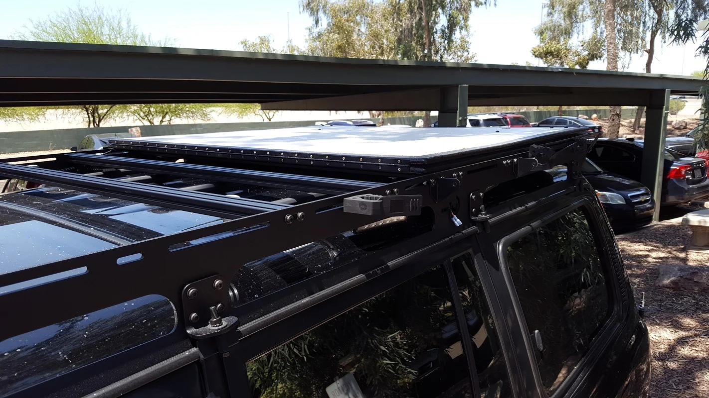

The platform fits the tent floor perfectly and the bathtub shape of the tent floor sweeps upward just as the edge wants to lay on the 3/16" lip of the rails. My daughter and I slept up there with a couple of Big Agnes air mattresses and the floor was perfectly flat and we fit very well.

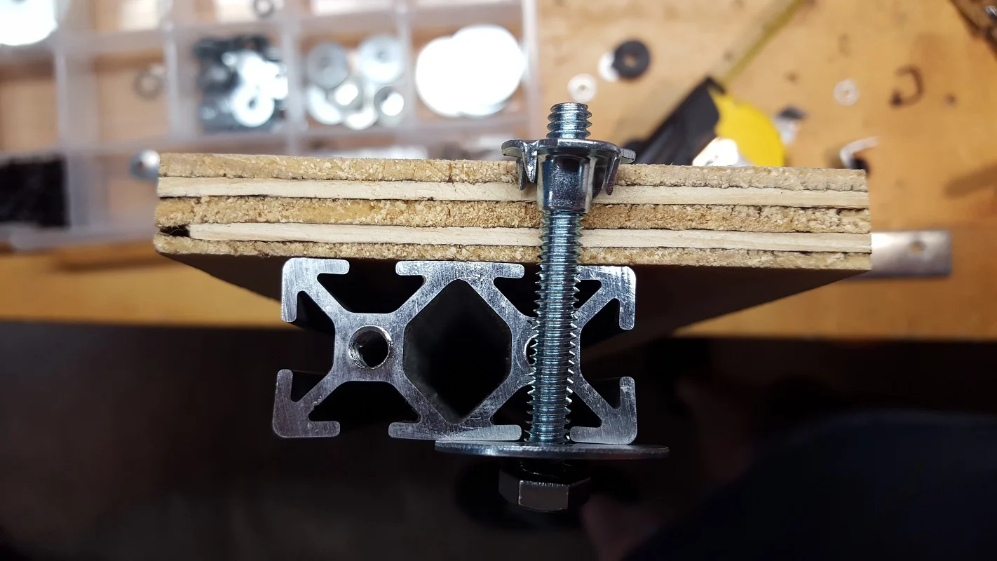

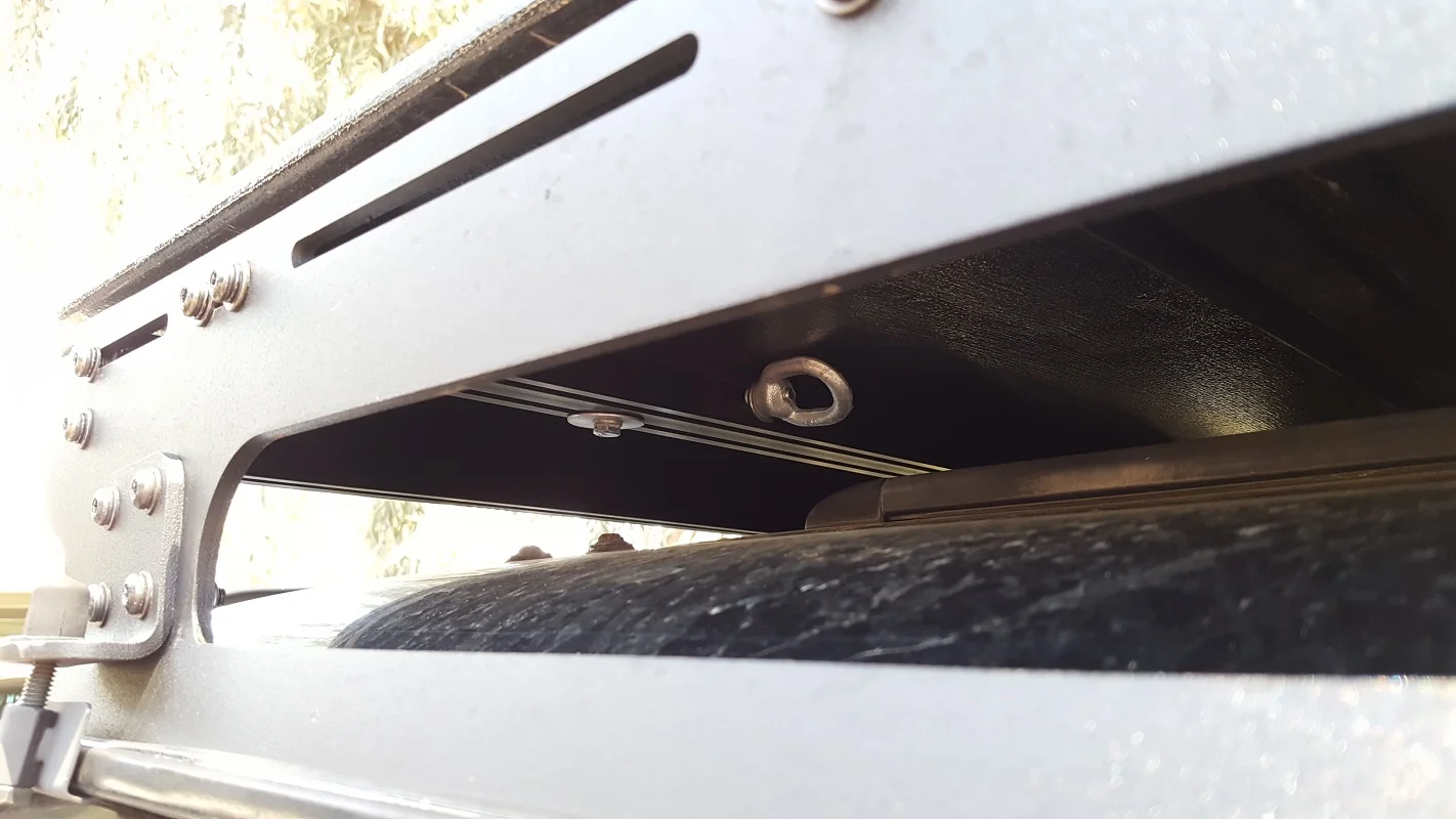

I drilled holes and mounted "t-nuts" to reach up through the sun roof to secure the front of the platform to brackets on my crossbars but after deploying it, the platform is pretty heavy and the tent shape actually exerts pressure downward so it forces the wood down and negates me having to secure the front half of the folding platform. In extreme winds it may need to be secured but I doubt it.
Entry and exit is done using a Tepui tents telescoping ladder. This is the same type of telescoping ladder you can buy at Home Depot but it has the bolt on connection brackets at the top. I use a 1/4" clevis pin on one side and a TSA approved padlock on the other to keep honest people honest. The ladder is pinned to Tepui brackets that bolt on the Prinsu rack and live up there permanently. No holes had to be drilled thanks to the expansive slots on the rack. The ladder does block my rear driver's door but in a pinch I can remove it or just lift it up and hold it while the door is opened then it can be lowered. Not a big deal yet. The ladder leads perfectly to the large side entrance (there's an mirrored large entrance on each side) of the tent so the ladder could go on either side. One other great advantage of having a removable ladder is I can finally climb up those big trees to get the huge pinecones! Securing the tent was the most challenging in my mind but once I found the bracket trick, it's so much more solid than I had imagined. By inserting the tent pole into the bracket straight then letting it angle naturally to maintain the tent shape, it locks the mushroom tip in and will not come out unless brought straight up once more. It's easy to bend the flexible pole to insert each corner. I learned to be mindful of the wind and always secure the upwind side first to prevent the tent from blowing over and bending the tips. Once secured, I then pull the stake loop around the tip of the 10" bracket and secure with a carabiner. This adds some peace of mind should a tip break off or something, the tent is securely fastened to the truck.

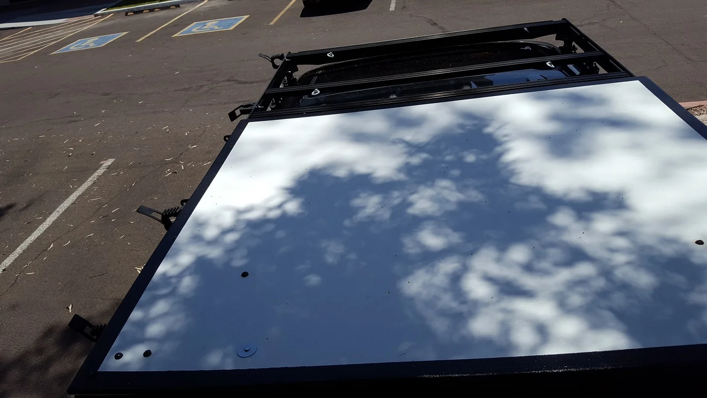

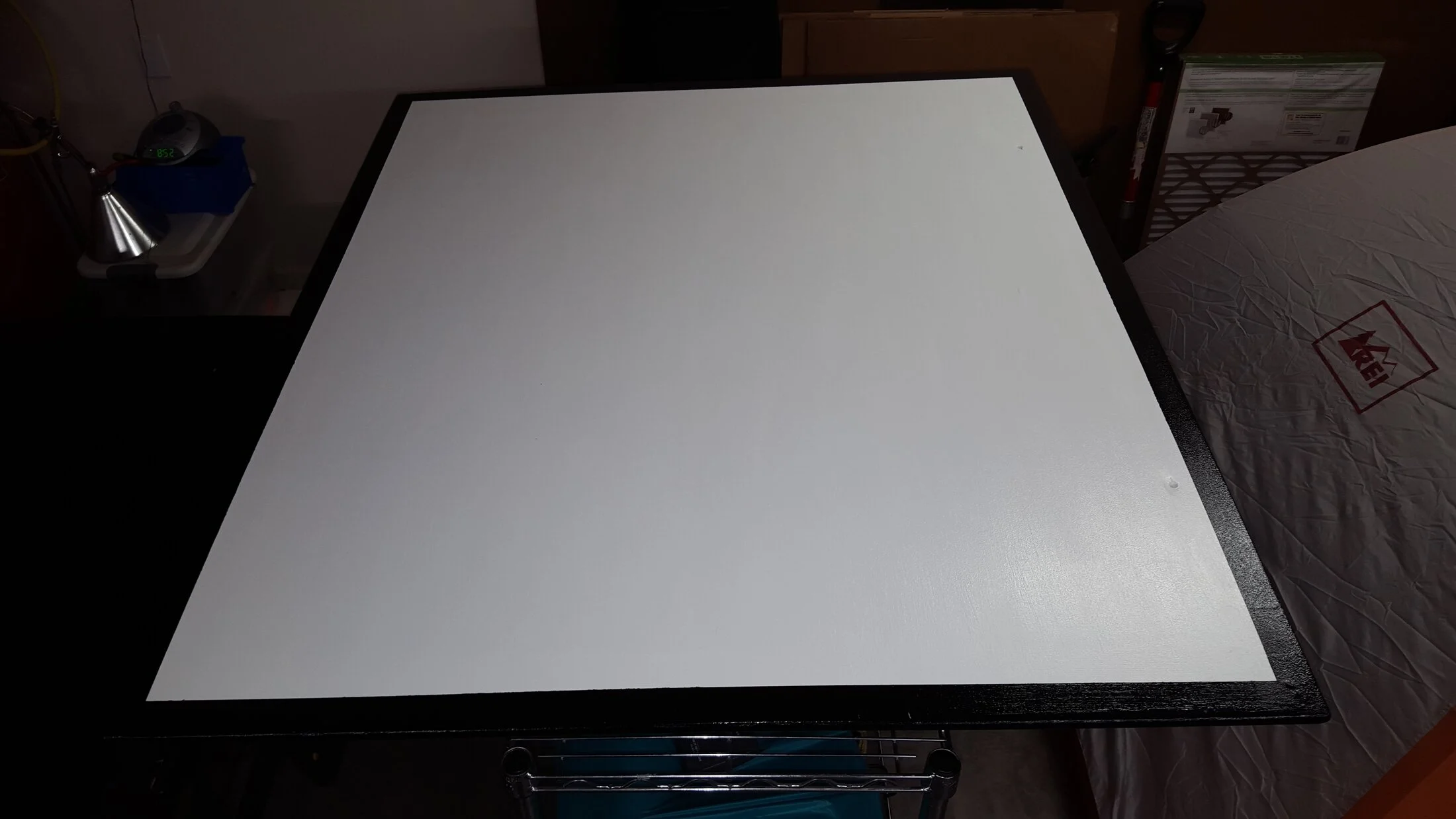

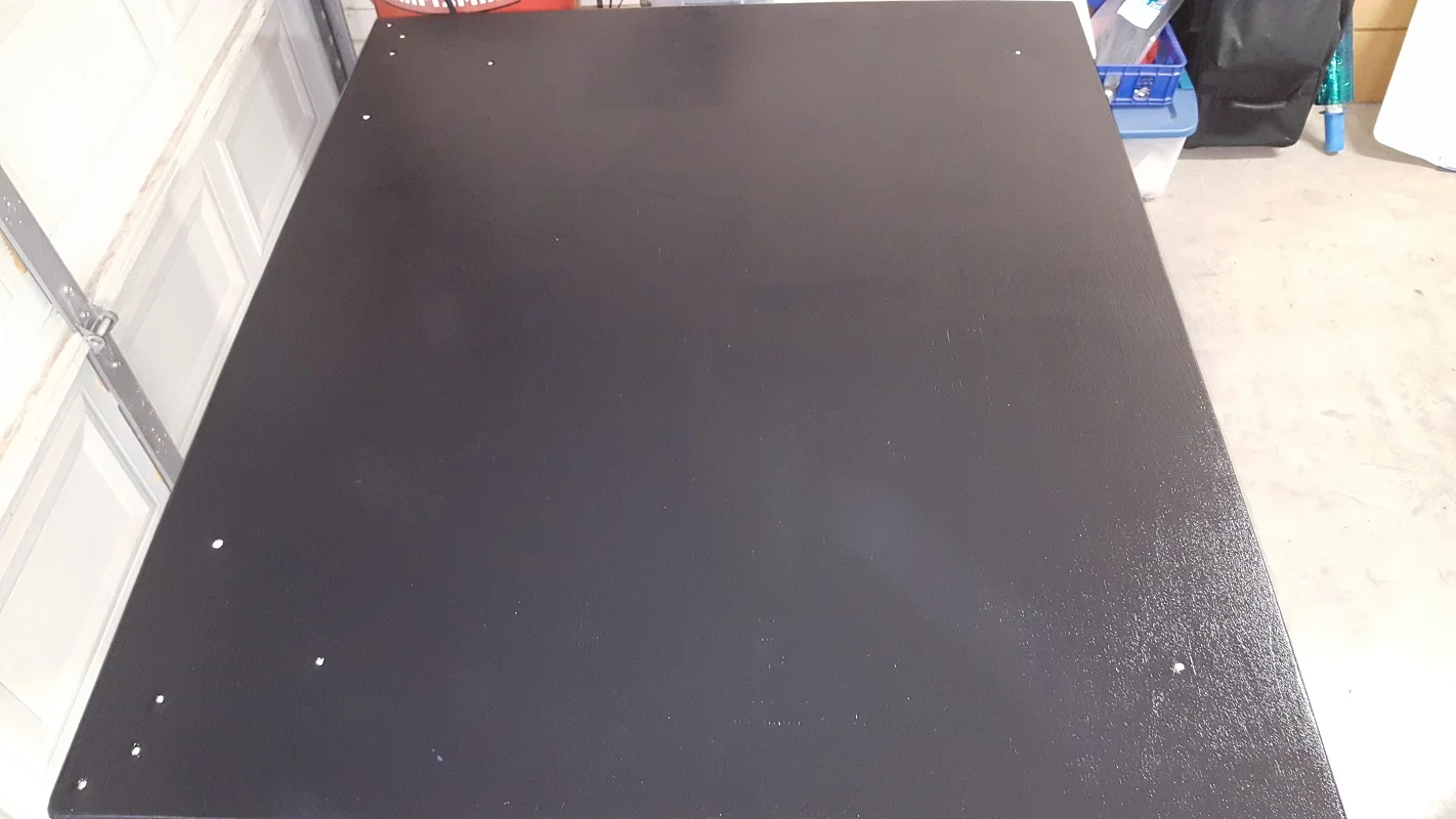

The platform measures 88x51 inches. Each panel is 44x51 inches. I have a nickel plated 4" piano hinge from Home Depot securing the two pieces. I painted the piano hinge black to match.
The platform is painted with Acrylic Latex gloss paint which should weather the best. The underside is black and the sleeping surface is all white. When closed, the exposed surface is white. All white surfaces have a 2" black border to keep it invisible against the black Prinsu rack. I figure the white would be a better option to reflect the desert sun and heat. The black is to match the black truck.
Referencing the black panel pic below, the far left white holes by themselves are meant for the 2x rear pins to secure the 2 panels when stowed. The grouping of 3x angled holes at the upper and lower left corners are meant for the corner braces; 2x angled holes for deployment and a third which was meant to swing them in and secure with the thumb screws for stowage but they hit the rear cross bar and I was afraid they would rattle loose and I'd lose the screws. The additional white holes on the black panel inboard and on the right side are to secure the panel to the Prinsu cross bars.
This leaves me with a 4'x4' white background just begging for some sort of graphic that can only be seen from high rise buildings...TEQ logo, Punisher (my son), My Little Pony (my daughter).

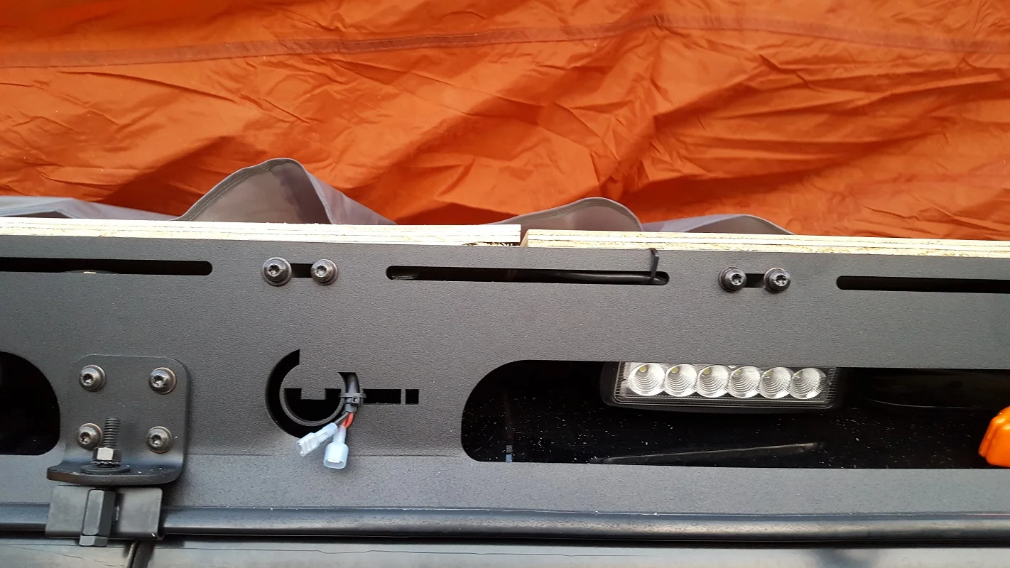

The black screws below are plugs to keep water out, the corner is for the brackets, the top ones are to secure the panel to the front cross bars when deployed if needed. The pins are the silver bolt/washer on the bottom.

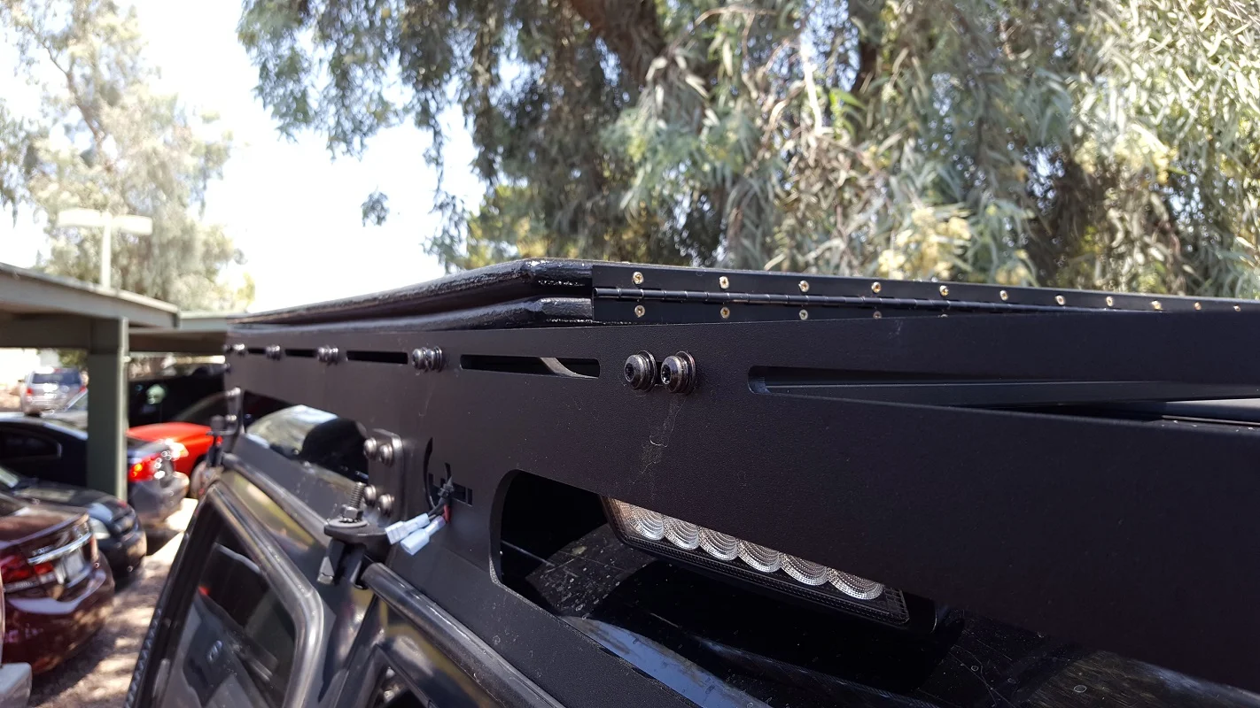

The platform is bolted up through my Prinsu load bars into "t-nuts" that are sealed on the tent side, none of the bolts protrude through the "t-nuts" as I cut them all to length. This caused a small issue with the front mounts when stowed so I just plugged the bracket holes with extra black screws and neoprene washers. I can easily remove the 8x end screws from both Prinsu cross bars and remove them along with the folding platform for service. I'll need to do this to get to my plugged OEM roof rack foot holes to run new wiring for solar, lights, etc.

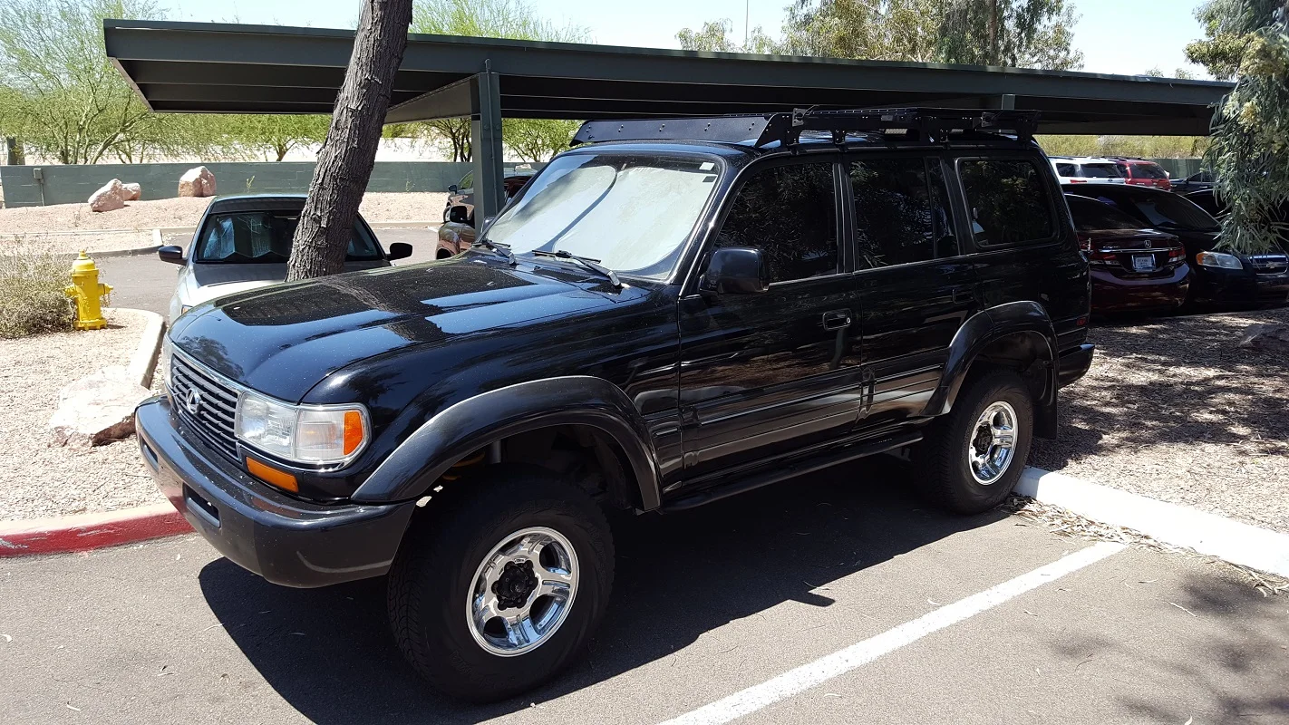

The flat profile of the wood platform only sticks up about 1" above the Prinsu rails so it's extremely low profile and I can still load up the entire roof rack for the trail run which is a big disadvantage for the real RTT.
I've been asked why I went with a folding platform that that is because the Prinsu rack only measures 80" long and my tent needed 88" inches. The platform extends rearward about 4" but since I have McMaster Carr struts and an extra 1" of lift on my rear hatch, I had to position the platform about 1/4" forward of the hatch spoiler.
This put the front of the platform extending about 7" beyond my Prinsu spoiler which won't work while I'm driving. The folding platform also helps keep the tent side cleaner during a dusty trail run which I had an opportunity to try out as the maiden voyage.

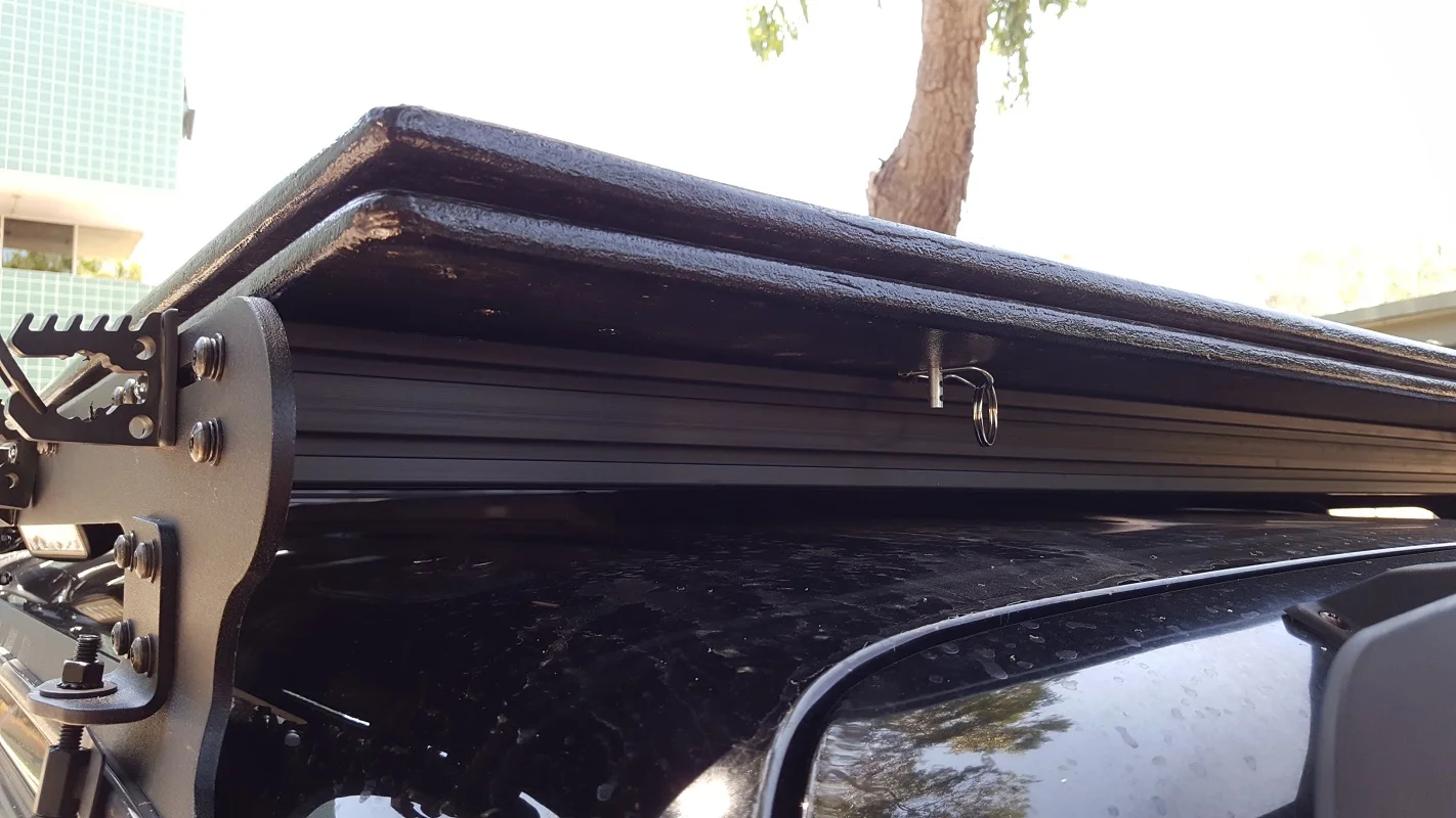

Stowed

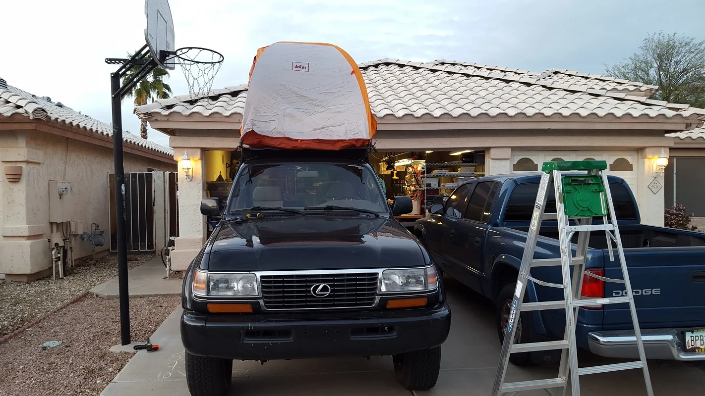

Stowed, it's barely noticeable on top of my truck.

Setup takes about 6-8 minutes by myself, about 1/2 that time with a helper:
First, I assemble the REI Half Dome on the ground without the footprint. The footprint is VERY loose on this tent and makes it impossible to get it on the truck. (3-5 minutes depending on rain fly usage)
Next I unpin and unfold the platform. (30 seconds)
Then I unscrew my waterproofing screws and attach the sturdy 10" brackets (3 minutes)
Then I lift the tent by grabbing the poles at one end and lifting it up onto the rack (5 seconds)
Then I insert each tent pole tip into the bracket and attach the safety lanyard (20 seconds)
Finally, I pin on the ladder and extend it to the ground (30 seconds)

It's been 3 months since I build this and to this day the paint is still tacky causing the two plywood panels to stick to one another when stowed. You can push on it with a finger and it feels sort of dry-sticky. An easy fix is to keep parchment paper between them where they contact. I will probably rebuild with 1/8" or 3/16" anodized aluminum or at least better wood and paint one day but the platform is only used a few times each year so it's no big deal right now. I've read that sticky Acrylic Latex is normal but usually clears up after a couple of months. It could also be bad paint. Not sure why it's still tacky.

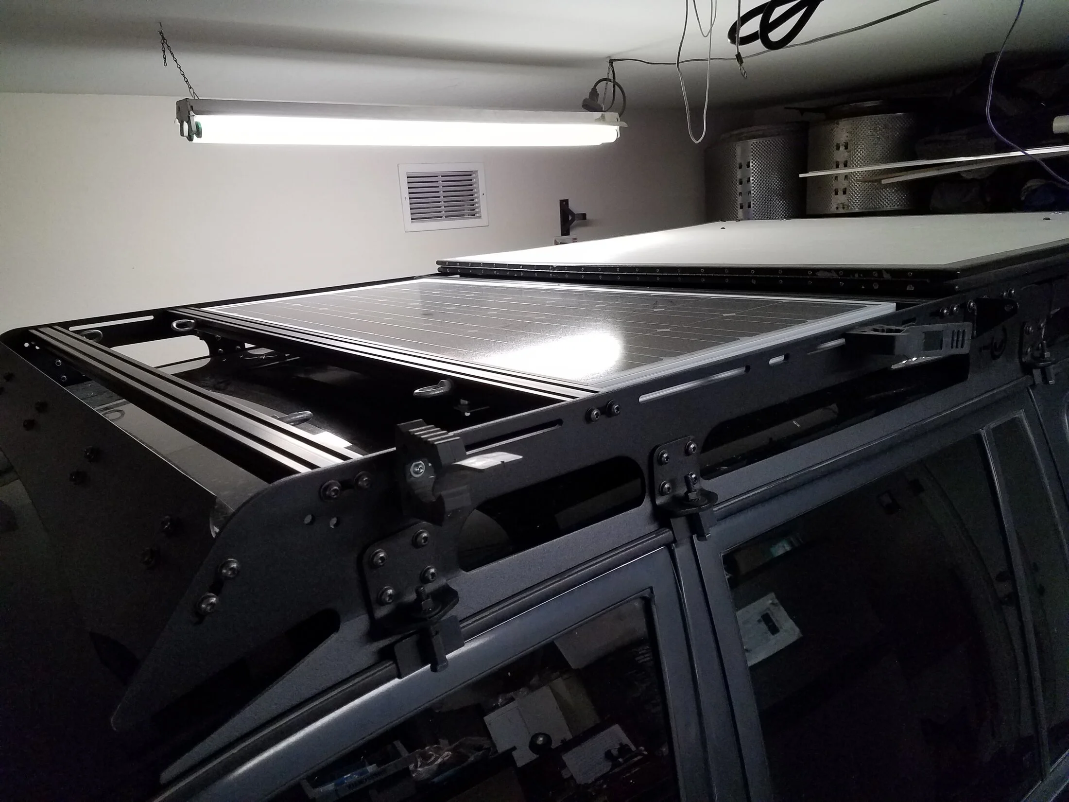

I want to setup a solar panel on the roof for daily driving, storage and camping. I've selected one that will fit perfectly between two rails on my Prinsu rack but when the platform is opened for camping, it will block the solar panels. This will be alleviated by buying a second panel that will be portable for camping. I figure the rack mounted solar will work around town to keep up with the slow charging city driving and auxiliary electric fan as well as when the truck is sitting outside a long time without being driven and then the portable will work for camp as I would probably be parked in the shade anyway so I'll use an extension and stick the panel in the sun. Easy fix.

I did add a 100W solar panel that has been up there for 13 years now and I do have a folding 100W panel with an extension cord for when I deploy the platform. The platform always sat just above the solar panel and with Prinsu load bars on either side, it never affected the panel, even with me sitting on the platform directly above the panel.

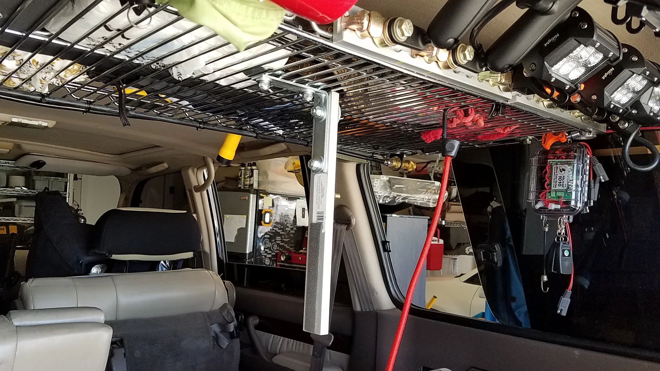

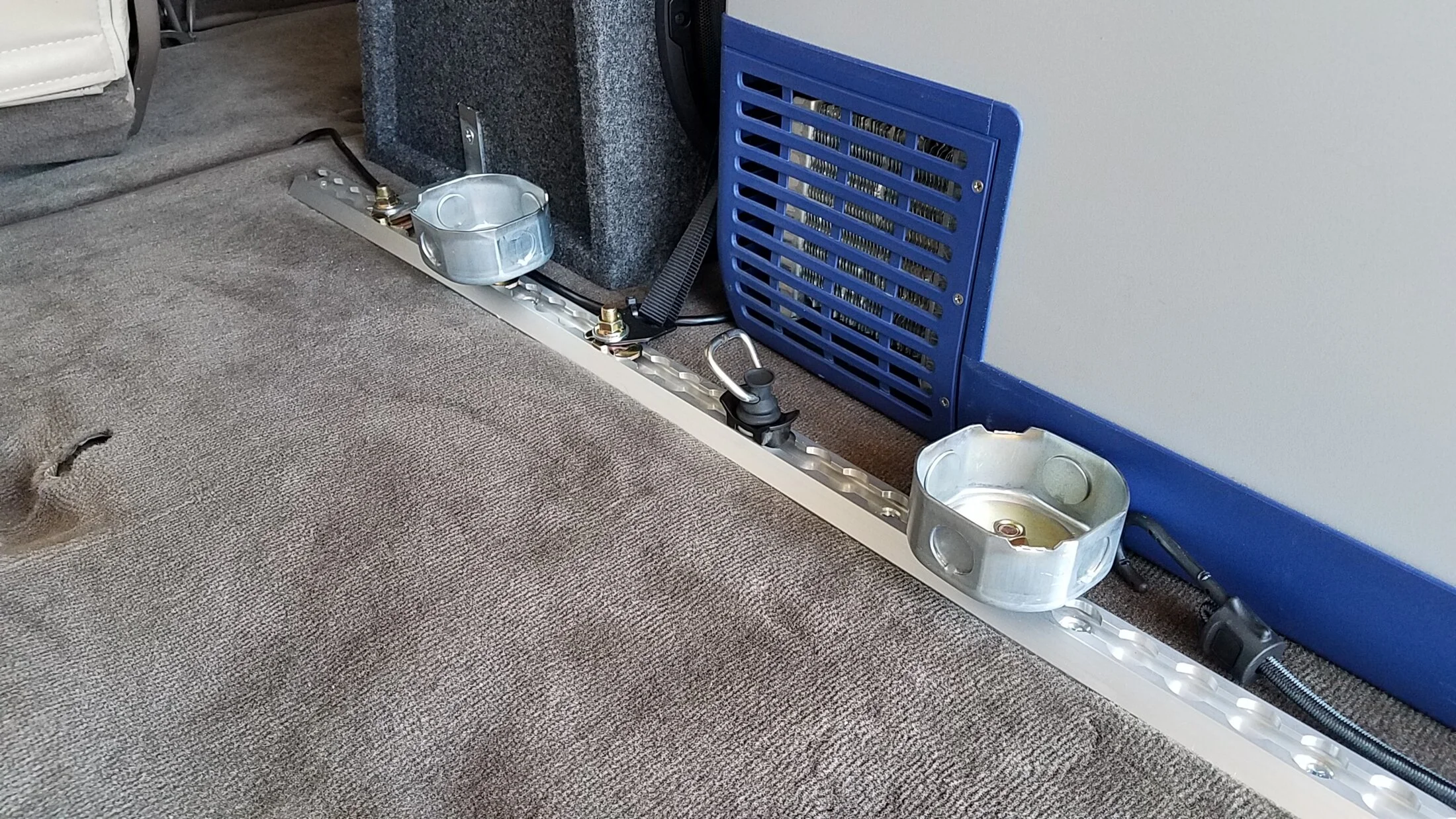

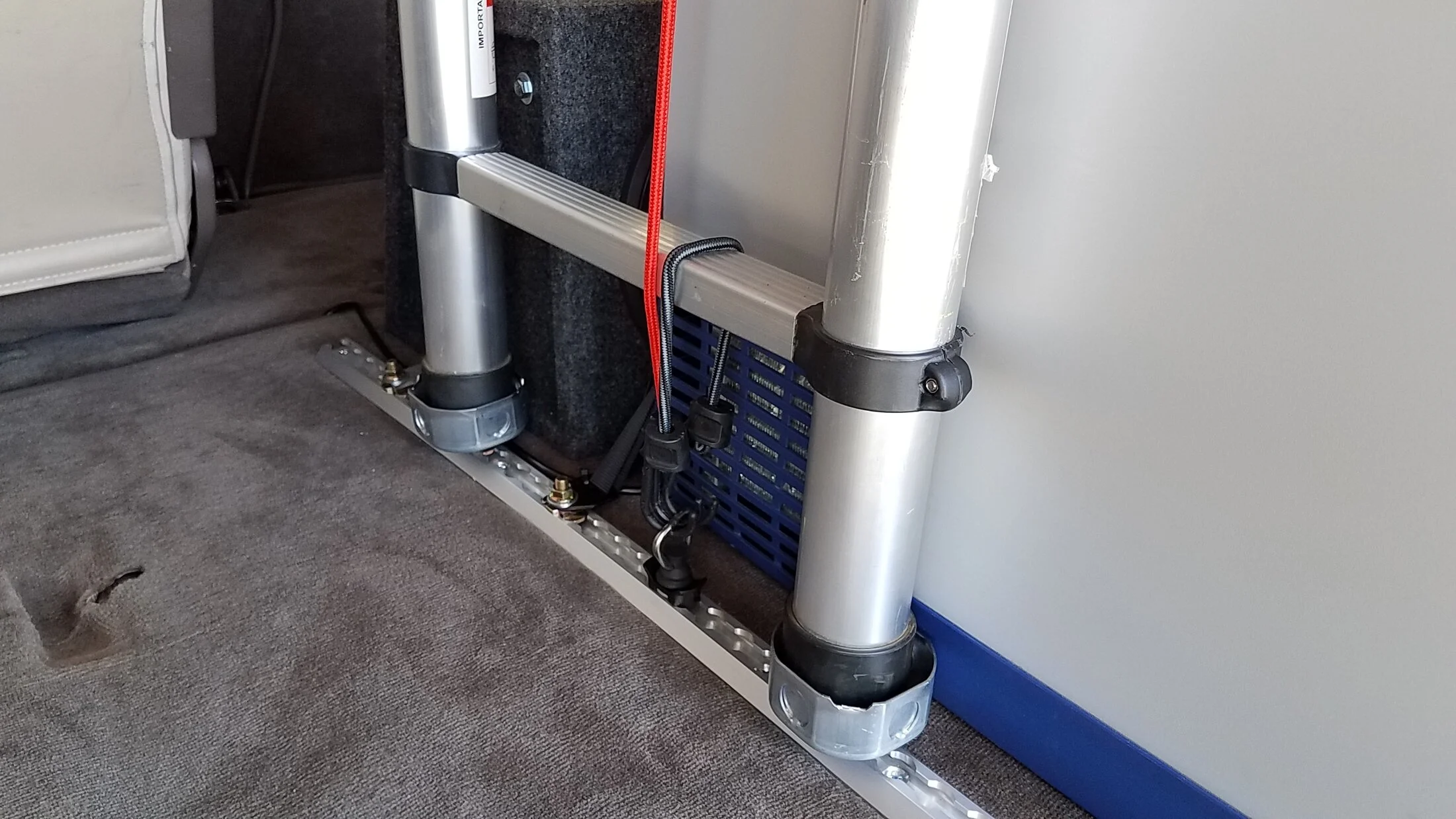

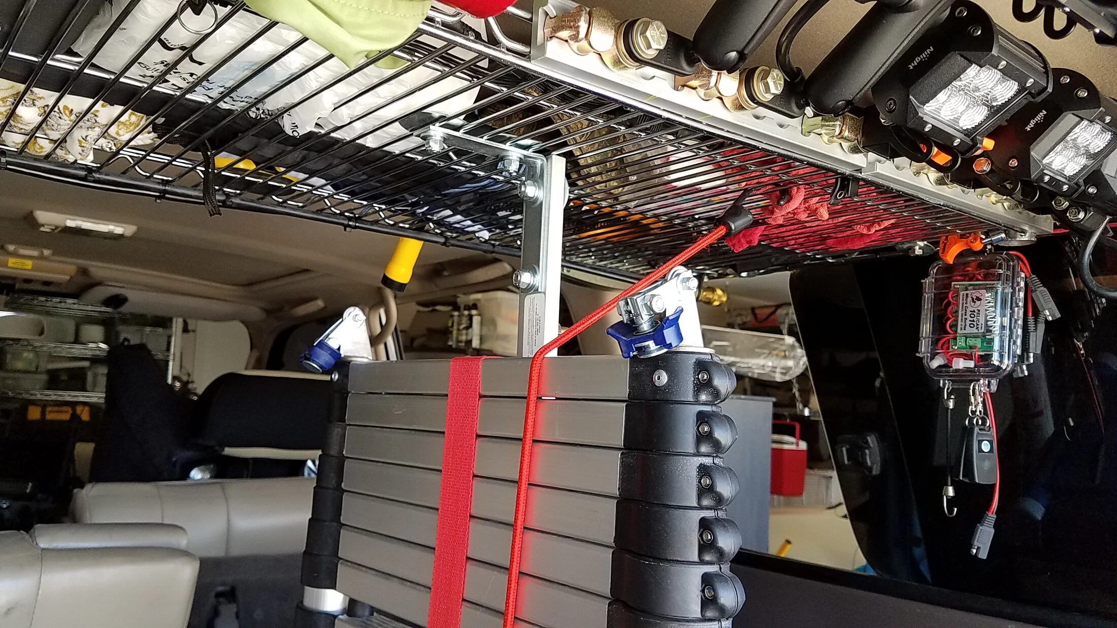

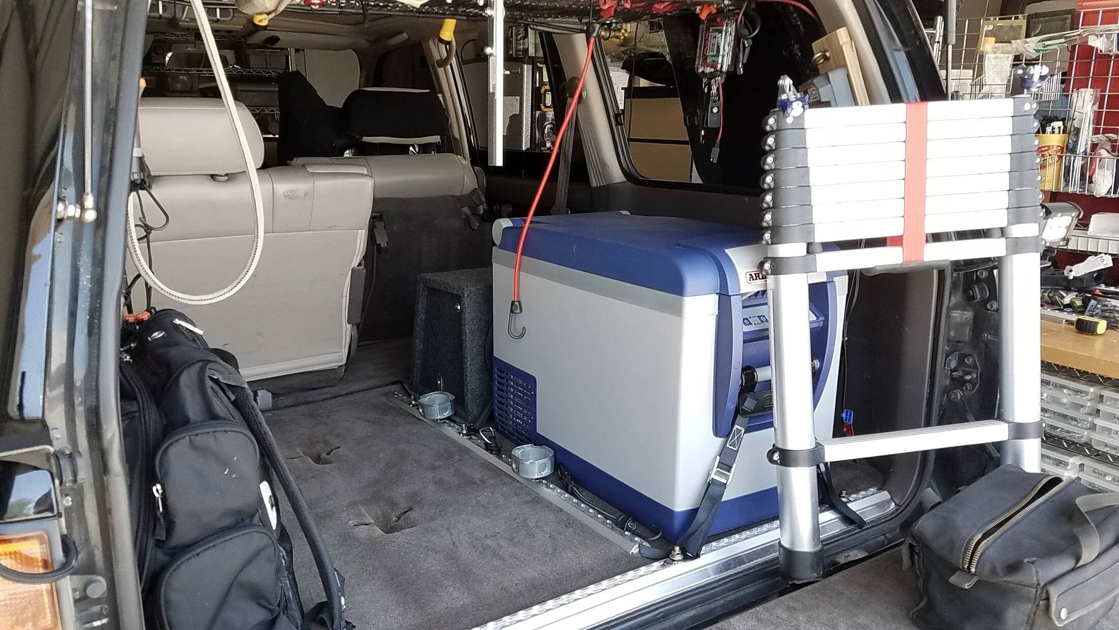

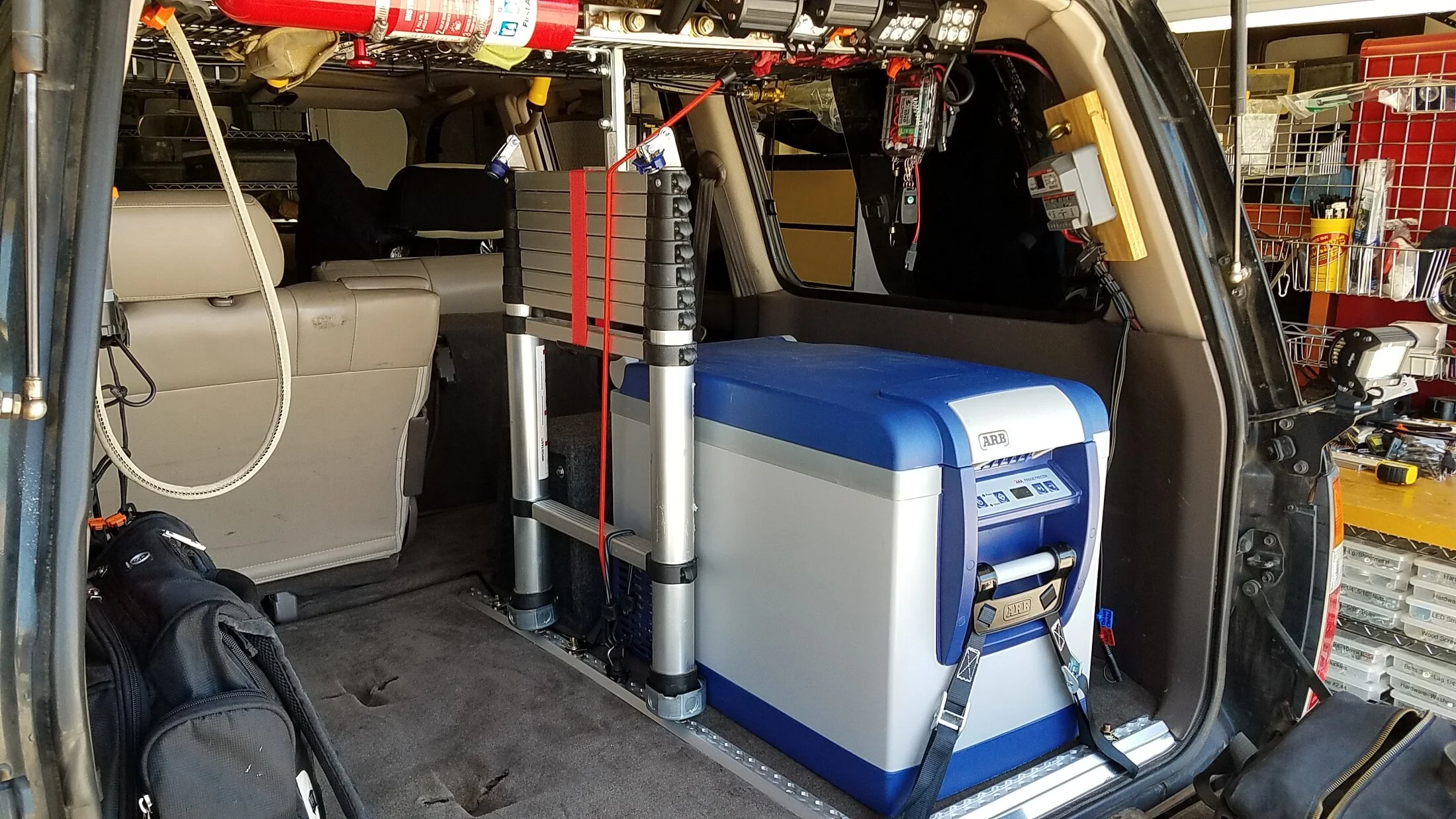

I fashioned up a contraption to carry the ladder that I never posted. Since I have L-Track everywhere in my truck, I leveraged a couple of 4" octagonal electrical boxes, a large "L" bracket, a bit of L-Track and a bungie cord to make the most secure ladder holder. I plan on re-building this contraption when I build my PMRTT 2.0.
