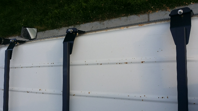

To the OP, find some gutter mount feet from somewhere like Trail Tailor or Gamiviti that are tall enough to clear the factory rack and buy yourself a couple 4' pieces of 1x2" rectangular tubing and bolt them to the feet. Easy and simple and inexpensive as well as stronger than the Thule or Yakima bars.
Here's a few pics of a local guy that did just that on his BJ70 and again on his FJ60. He had a Tepui tent mounted to it and it was very solid.
Painted 1x2 tube
Gamiviti rack feet
Mounted
Top
that's how i've had my maggi mounted for almost a decade

Gamvity mounts are really nice and well made! Use what ever bar you can and done!
