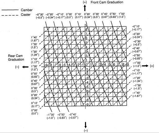

This thread has some posts on how the camber/caster is adjusted and how they are related:
Post Lift Alignment
If you're out of adjustment, you can either dial back the torsion bars until you have enough adjustment, or go to aftermarket UCAs that add caster.
