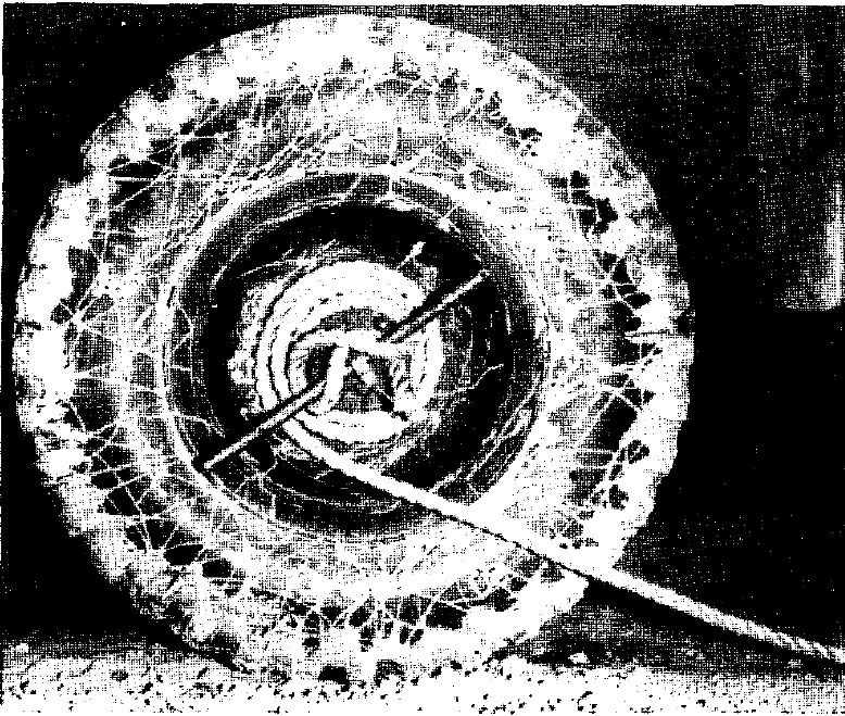

Some old school military axle flanges had holes in them for a breaker bar that allowed you to winch this way.
I don't have an overwhelming need for that kind of option, but that rings true for most of the **** on my truck. I'd consider a set if they were available.

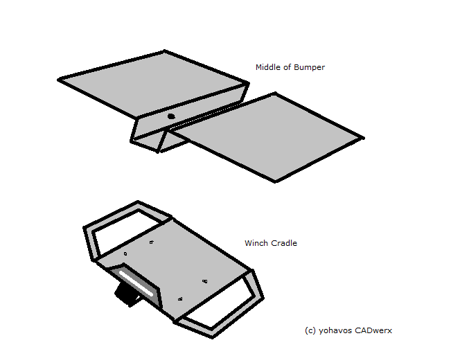

How about a channel integrated into your bumper that the winch cradle can sit in?
