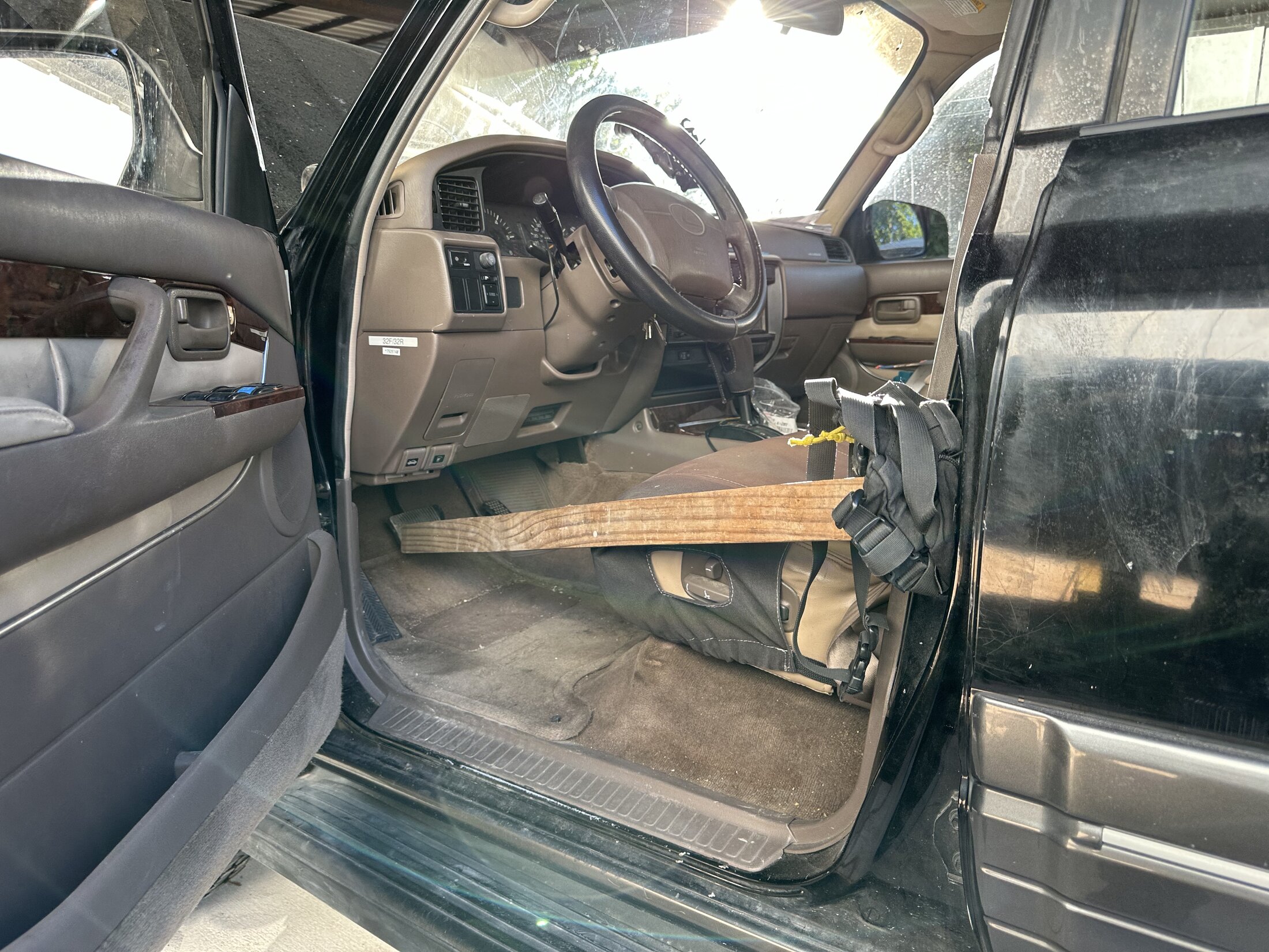

anyway i went back as rick said and i basically cracked the bleeders one at a time, pumped three times and then shoved this slightly curved pallet piece in the jamb and let it sit like this for a minute and a half or something. then closed the bleeder and went onto the next one.
