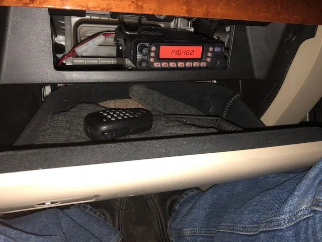

Ok one more. I also used the CD changer spot to mount the unit. I also stow the face plate and mic there when I don't feel like having the radio out or exposed. More of a stealth install.

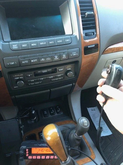

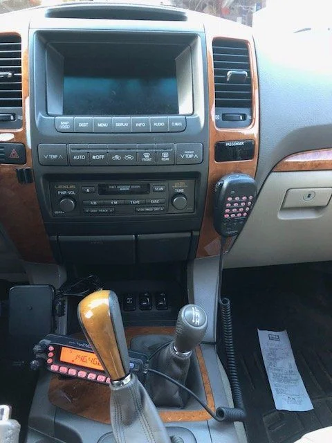

I bought a suction cup mount off Amazon and have been pleased with how it works, if I clean the surface really well. I stick it between the shifters any time I'm on a run, or just want to listen to the local repeater rag. There's enough cord with the remote kit to also put it on the windshield, but I haven't tried that yet. Kinda dig it down low, where I can rest my hand on a shifter to make adjustments.

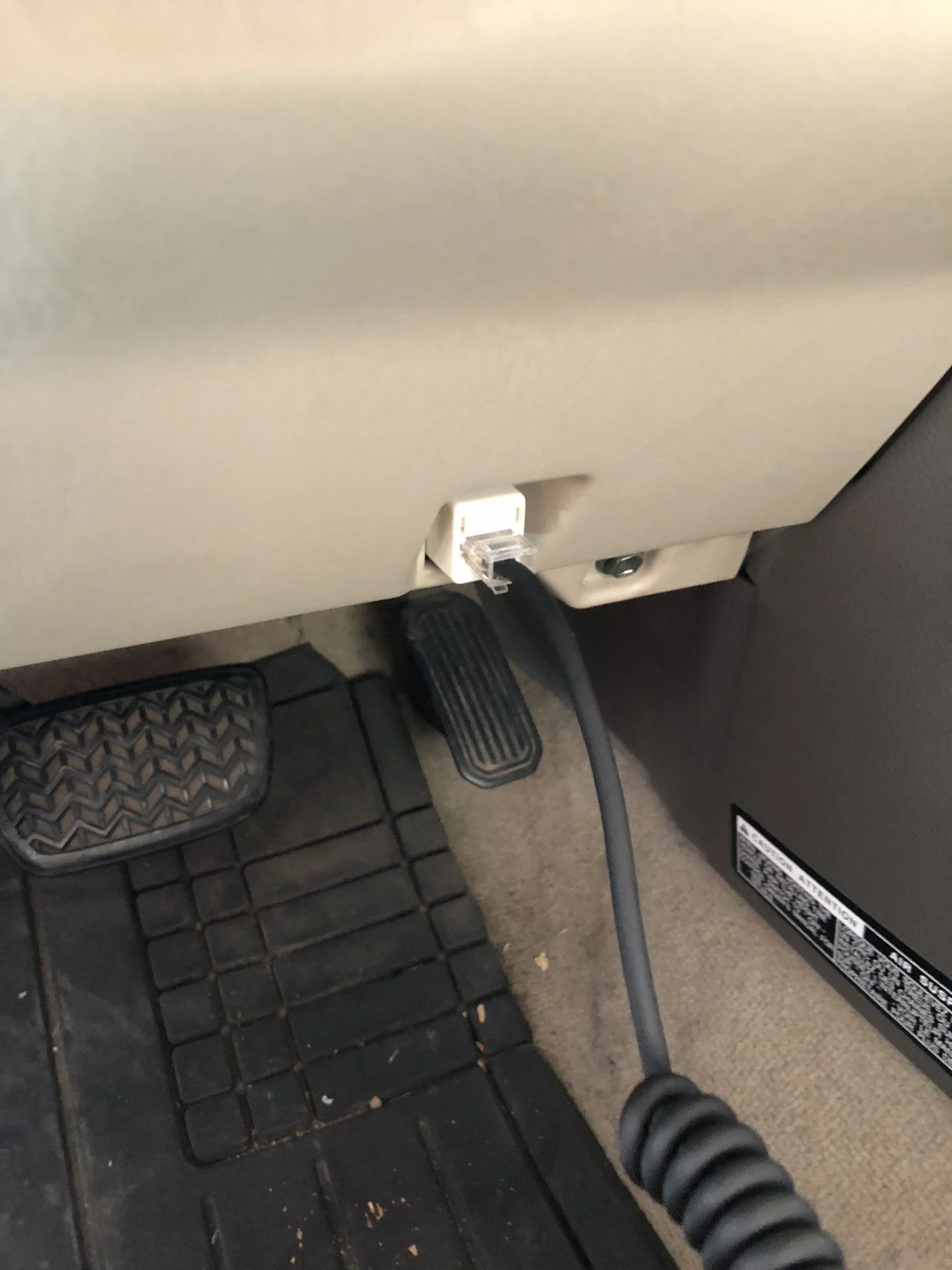

This is where it all goes when I don't want to see a radio

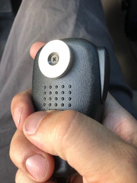

Pretty slick. Do you have problems with the mike bouncing off when your bumping around off road ?
None. I did 2 disk magnets inside the dash, it about rips the mic out of your hand when you put it back. I wanted it a little on the strong side in case a knee hits it.

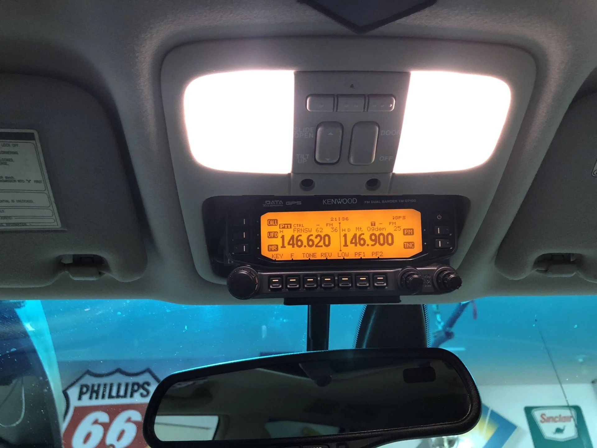

Finally taking the plunge! Have been slowly researching and found a good deal on a 2980:
Haven't decided on hood vs rear hatch mount (also haven't decided on an antenna!) but I have plenty of time to think while I study and get licensed. Mud has been a super helpful place to research.
