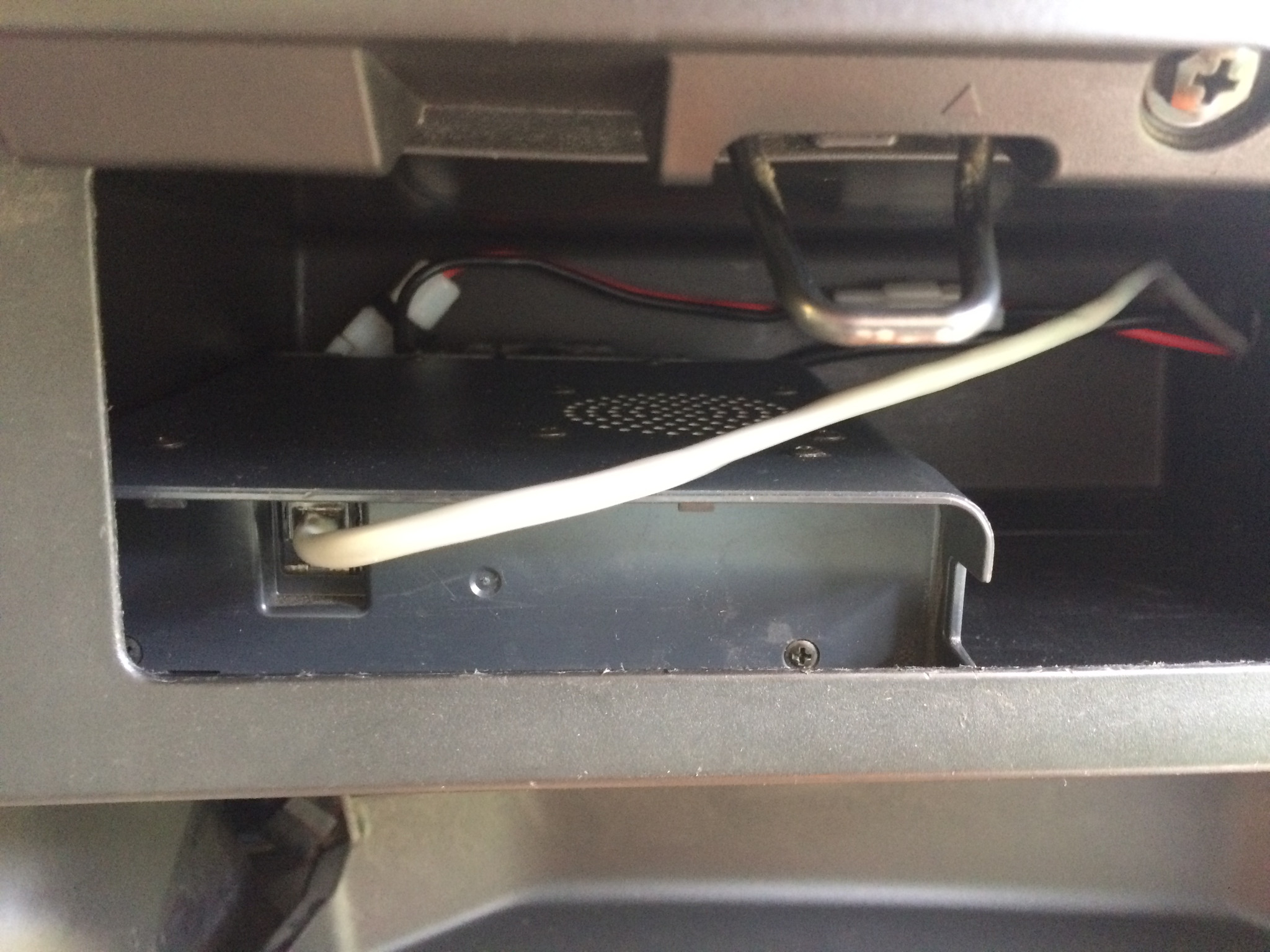

Installed unit in the upper tray of my glove box. My GX didn't have a CD changer.
My install is in the glove box and pretty similar to what others posted other than I am running an APRS ready Kenwood D710. I also used a mini ball mount on the head unit to get a better viewing angle.

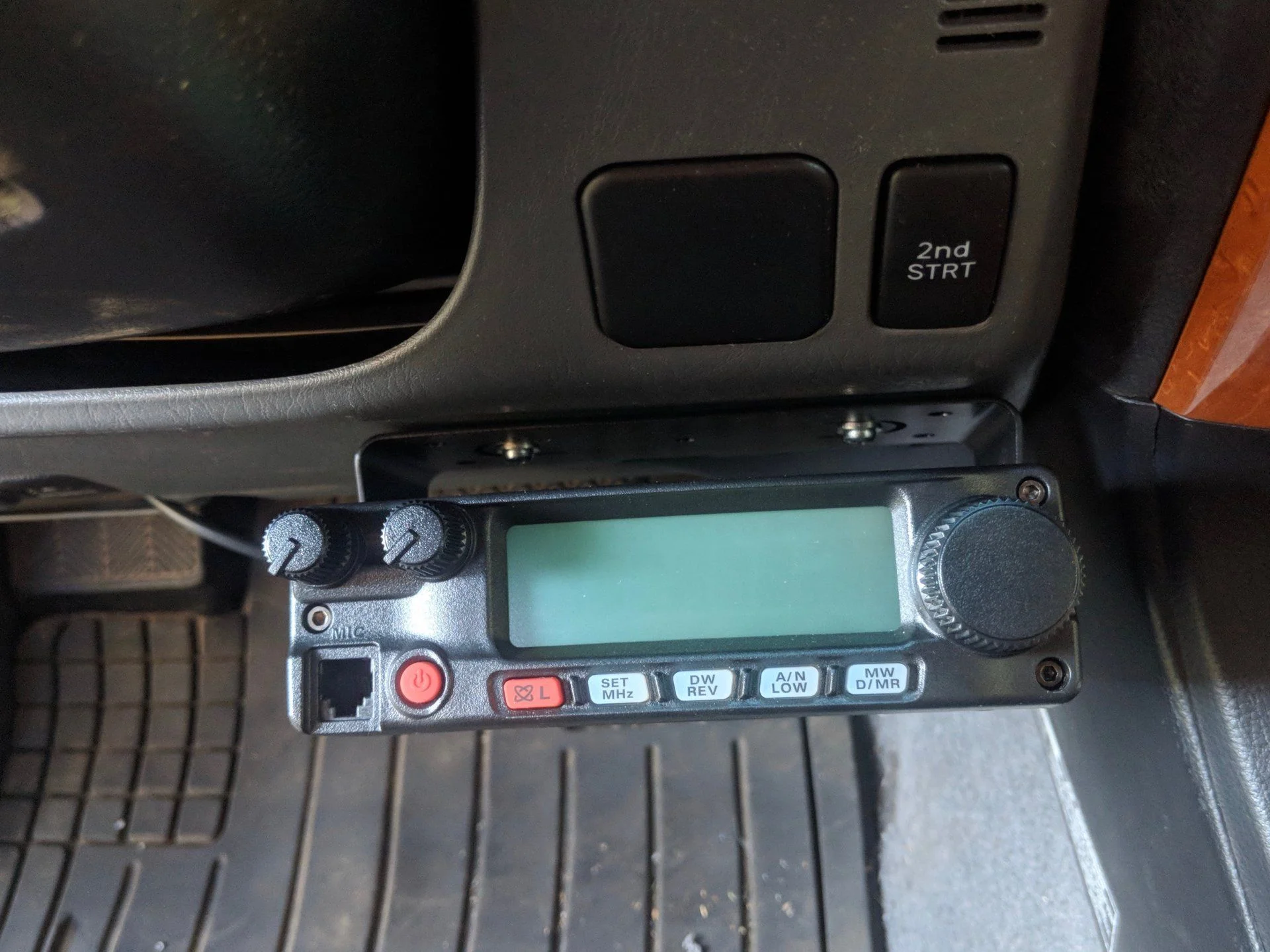

Mounted the radio and antenna bracket and ran the coax cable through the firewall. Radio still needs power but I can only handle one firewall battle per day.
Radio under the steering wheel:
Bracket up on the fender - any issue with it being that close to the windshield?
Not from our preliminary testing, but if it becomes a problem it will be out of there in a hurry. I was originally planning on mounting it to the driver's side of the center console but it was going to be in the way of the seat moving all the way forward, which we do for sleeping in the back.
