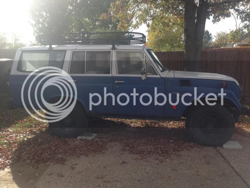

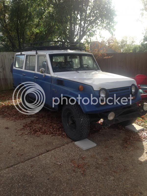

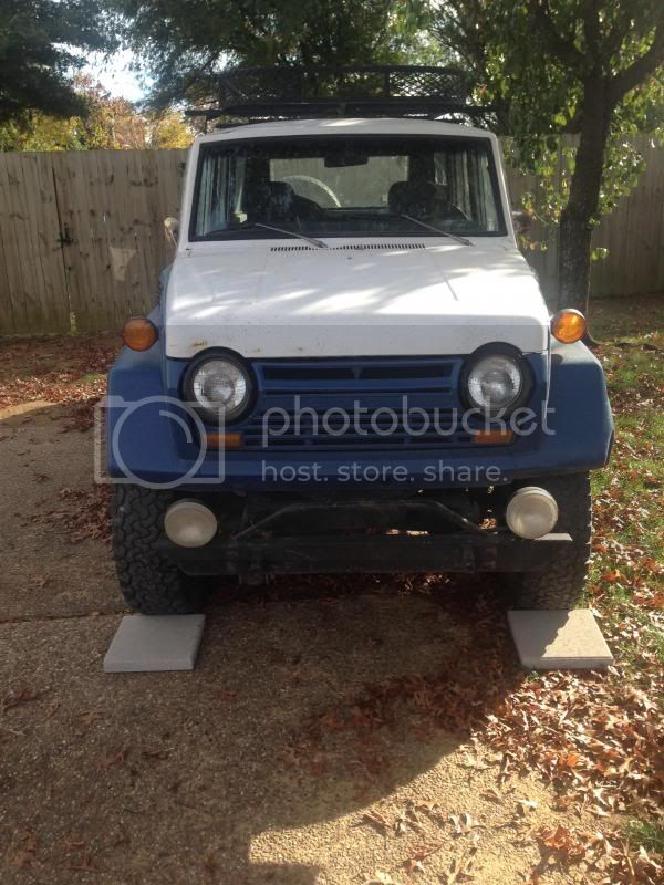

Thought I'd start a build thread to document what I believe will be my slow (or maybe not so slow) decent into madness.
Here are pics of my pig right after arriving from Montana courtesy of CarmMontana

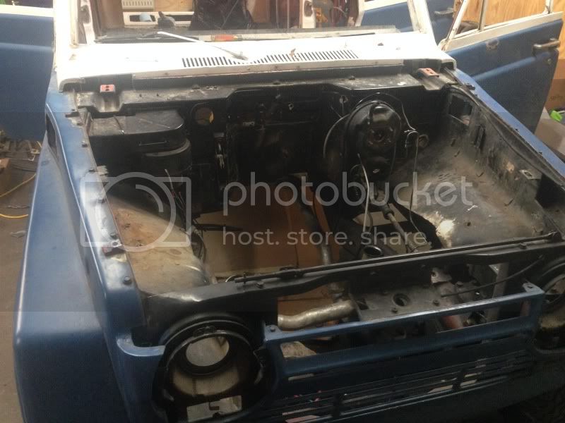

The engine wasn't running and after looking it over, it was going to take a full rebuild to get it running so I made the decision to go ahead with a 4bt swap.
Carmon had warned me some rust was beginning to show through, and that there was bondo in the body. We pulled the engine and stripped the interior. While the body is sound overall, there was some rot and structural problems, so I decided to go with a full frame off restoration.

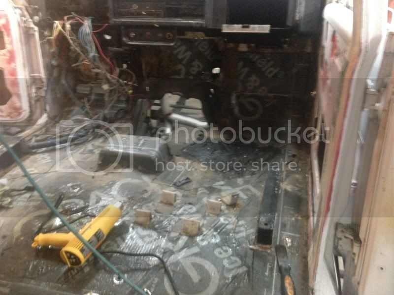

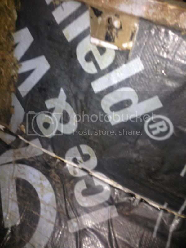

We began removing the dynomat when we ran into our next problem...
This is tar paper from hell! It's lining the entire floor of the vehicle and it appears to have bonded with the metal. No easy way to get it off, so I'm going to go out tomorrow and try out a suggestion Carmon gave to me tonight.

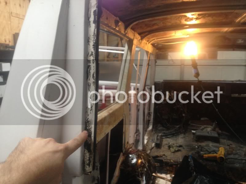

Front door window frames starting to separate from door up front on both sides. Several small areas of rot sowing through on the roof.
All rot will be replaced with new sheet metal. The initial focus will on getting the frame and body pristine, then box frame and powder coat it, prime an spray the tub inside and out. Once that's done, we'll be swapping in new axles so the suspension will be the soul focus until complete.

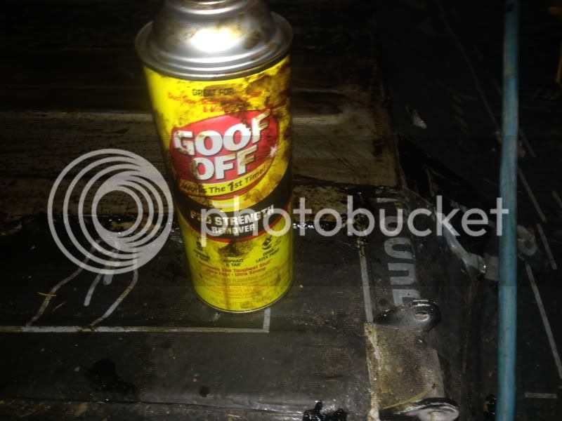

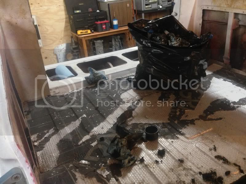

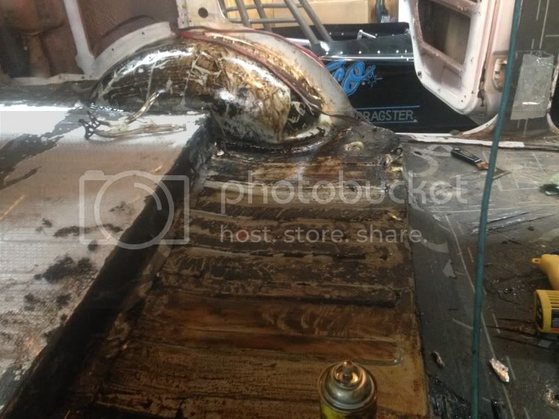

So spent some time tonight trying to remove the ice and water shield from the floor of the body. This is a roofing product found at Home Depot and apparently is supposed to serve a similar purpose to dynamat extreme. This stuff practically bonds to metal and is a nightmare to remove. I'm not man enough to pull it off and a torch just made a mess that was no easier to remove.
Carmon was able to give me a link to a video of a guy using heat to remove the bulk of it (video was actually for removing dynamat extreme), followed by goof off for the residue. This method was easier but still a painfully slow process made only slightly easier by using a box cutter where the material meets metal
IF YOU EVER ENCOUNTER THIS STUFF OR SIMILAR, HERES THE IMPORTANT PART!
Forget the heat. Once you get an edge up, grab it and pull firmly then spray where the metal meets the adhesive with goof off and it releases quite easily. Each time you encounter resistance spray the edge again. Once it's up, respray the surface with good off and scrape with a putty knife. Once this is done, respray and wipe clean! It's just that simple. A complete floor pan should only take about 4 cans of the stuff and 2 people can do it in about 10-12 hours! (Sadly, not a joke).
