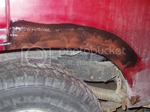

Heres what I have so far.
Before
Cut
Welded
I'm going to POR15 it, put a little filler in to smooth it out and the POR it again. Hopefully it wont rust again for a very long time.

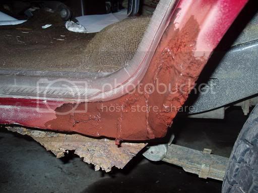

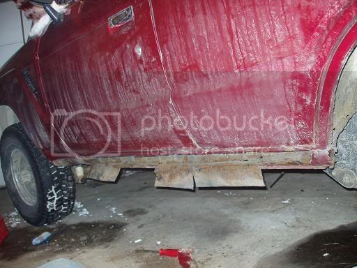

Heading to Lowes to pick up more discs so I can continue cutting before I second guess myself more then I already am. To those who have already cut their rockers. What line do you follow when you cut them? Could you also post a pic or 2 of them?

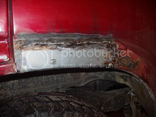

I got the lower wheel arch to rocker fixed today. I'll get pics up in a bit. I did it with 4 pieces of metal then beat on it with a hammer until it looked decent then pored and primered it. I need to finish cutting the rocker off tomorrow and then turn the cruiser around so I can work on the other side. I'm planning on doing a little bondo work to smooth stuff and then herculine it so it looks real good.

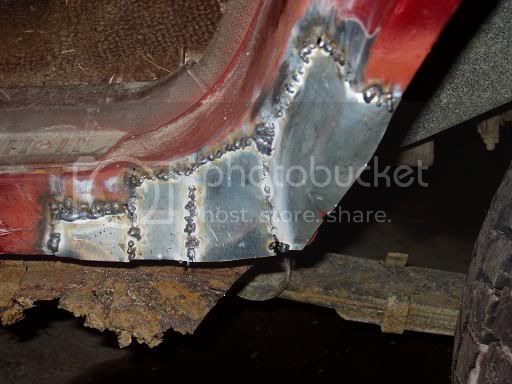

Here are pics. It doesnt look that great but its better then rust...right? Plus I think with a good coat of herc it'll look really good. Plus with some sliders you wont even see it.
During
Pored and primered
Ignore the crappy looking welds. I cant weld sheet metal to save my life!
Just get a flapper wheel (sand disc) for your angle grinder and smooth down the welds. That's what body guys do, weld, grind, weld more to fill in holes, grind, and over until the holes are filled in and the lines are smooth. Oh and smooth out with a little bondo and sand.
