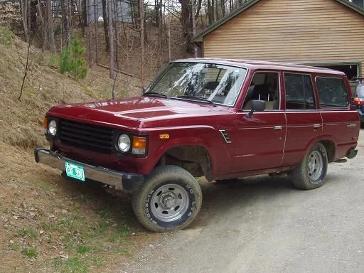

DONE!:bounce: Well mostly done there are a few things I still need to do but its close enough!
From this
attachment.php
To this
Thanks, I think the black and red looks pretty good, now I just have to lose the rest of the chrome.
