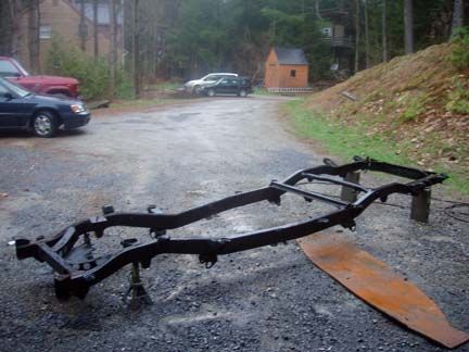

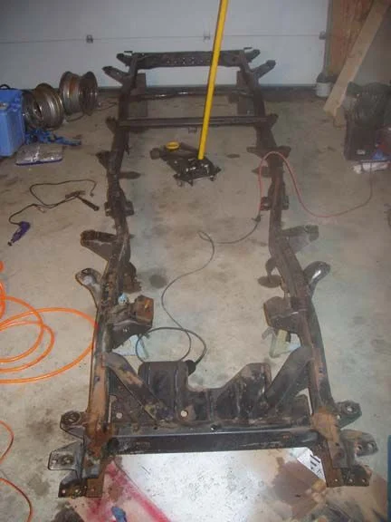

Well after driving my cruiser home I took a really good look at the frame and came to the conclusion that it needs replaced. So I bought an almost rust free cruiser frame from cruiserparts.net. I went and picked up my frame on Friday and started running around picking up some tools and stuff on Saturday. Today was the first day I started doing work.
Today I pressure washed the frame and started wire brushing the paint and rust. I had to buy a new grinder because of course with my luck nobody around here stocks wire brushes for a 4.5in grinder. So I had to down grade to a 4in. I was going to get a 5in but nobody has them in stock. I also picked up one of those cheap sandblasters for $15 from Homedepot. I hope that will make the paint/rust removal go faster. But you know Home Depot they dont stock the sand, so whats the point of selling a sandblaster if you dont sell sand? Luckily I know a place that sells sand they just were closed after I bought the blaster.
My plan is also to do some upgrading as I go. I plan to do an SOA custom bumpers.
I will post some pictures after I get my silver star.
Here are some pictures of the new frame.
right on!
be careful with those wire wheels... I had them shoot wires many times. I always wear safety glasses and a shield if possible. with out the shield I have had wires come zinging off and stick in my forehead a few times. If one hit your eye your blind.
If your painting with POR no need to remove all the rust. As the rust will help the por stick better.
Sandblasted is great too for pOR..
Those cheapie snadblaster can really test your patience thou. I have never had luck with a suction sandblaster. They always get clogged.
I used a pressure tank one lately and it was pretty good to use.
If all fails take it to sandblasting business and they will make short work of cleaning it up.
Yeah I wear safety glasses, I would use a full shield but they always fog when I use them. I was looking to get a pressure tank sandblaster but everyone was out of stock and the best they could tell me is that they would get more in a couple weeks. I might just buy one over the internet and bring back the suction one. I would bring it to a place to be media blasted but I dont have enough money. I know that POR bonds to rust but does it bond to paint? There is more paint on the frame then rust and that is what I am really trying to get rid of.
I think you have to rough up the paint pretty good with 36 or 40 grit discs. Then clean it all. Should hold fine. No need to remove all the paint.
In fact since your doing POR, just clean the frame, then rough up the painted areas, knock off excessive rust and spray/brush some Por on. no need to sandblast it all clean. IMOP anyhow.
I think they rust from the inside out more soo. So before you install the frame try to get lots of rust inhibiting oil inside the frame. Spray it in there.
Oh thats good I really didnt want to have to clean the whole frame. I was planning on spraying some POR or something else in the frame. I guess I wont bother with the sandblaster.
phishincruisin- cant wait for you to get here, we are trying to do a year of work in a couple months.
I would sandblast the frame if it was all rusty I guess. Or I was going for a show car look. I dunno.... up to you and your wallet.
POR needs a rough finish to stick(it's a really slippery paint) and rust is a good surface for POR. But heavy sandblasted is good too.
I sandblasted my doors with 100% recycled glass, then painted POR-15 on them. It really did stick well.
You can still you the sandblaster. Just sandblasted the areas that have paint lightly. Then they will be rough enough for the POR.
