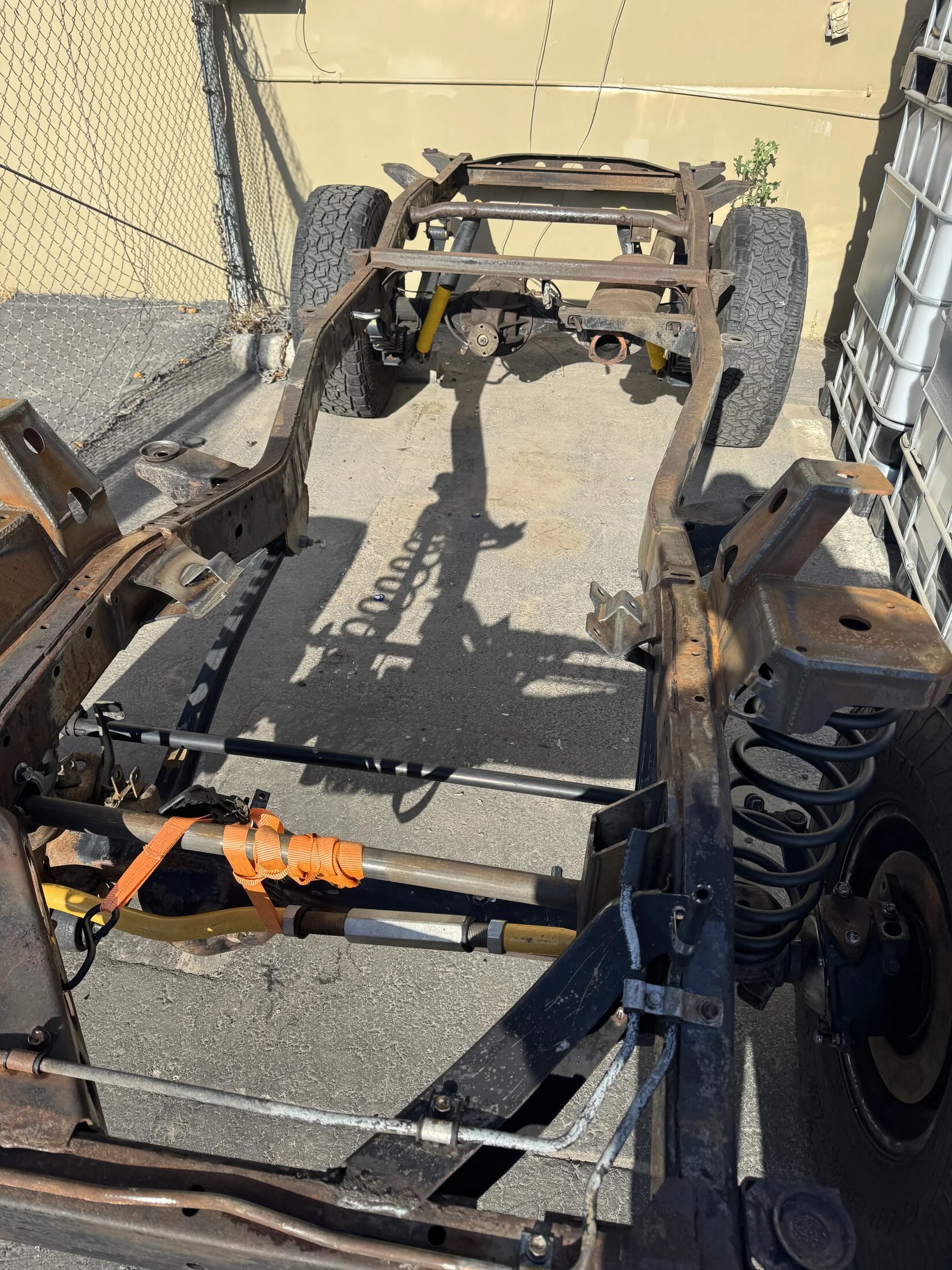

Just noticed the other day that my frame doesn't have the metal cup that retains the bushing on all the Frame/body mounts. Any experts out there can tell me if this is normal or not. Doesn't seem like there was anything there other than the rubber bushing.
The front two mounts and the last mount have the cups but the middle 3 mounts do not.
Need to make sure I am all good before I take to powder coat.
All of them should have cups, some are different sizes. I'm in the process of replacing some of mine that were damaged or rusty. Matt @cruisermatt is helping me get them sorted with some from a 70 series I believe.
