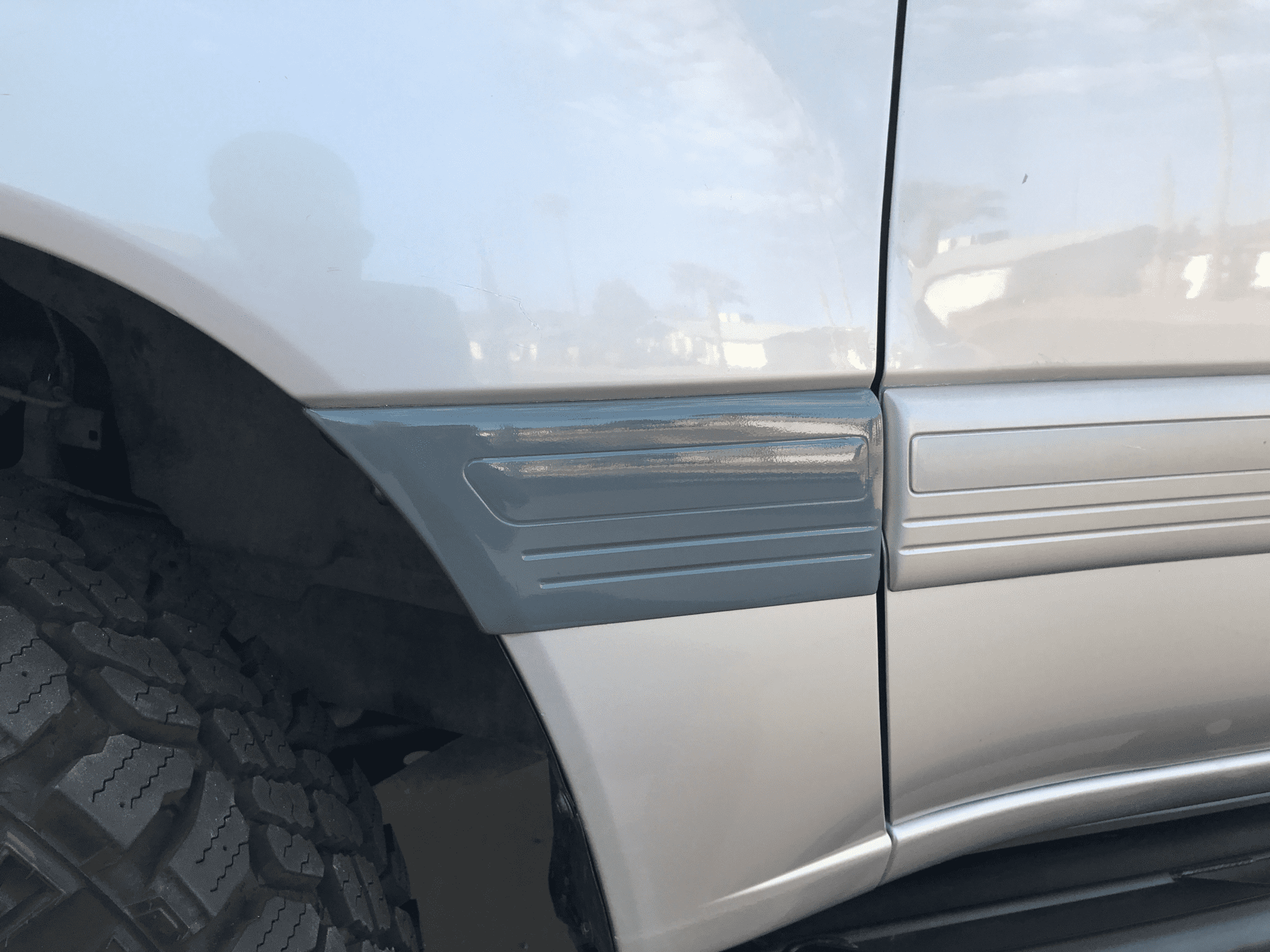

Oops, pic didn't attach. Here is the one small piece I wrapped. I will definitely keep you in the loop, if you do it yourself, it is super cheap. You can get enough to wrap the entire vehicle (and screw up some panels and have extra) for about 400 bucks...
After about two years in the AZ sun, the vinyl wrap is definitely NOT a long term solution and would advise against wrapping anything considerable. The trim was easy enough, but I am REALLY glad I didn't wrap the whole rig. The vinyl has gotten brittle and the surface likes to hang on to dirt now. Keep that in mind if you plan on going this route.
Glad I didn't spend $600 in materials and 3 days of my time trying to wrap my LC. Mine would probably hold up a little better due to living in a garage, but still brings the question of how long will it really last.

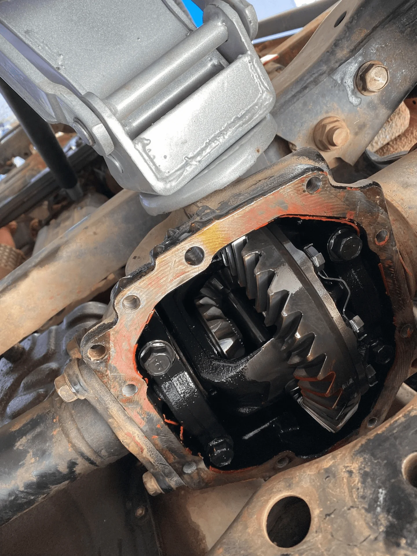

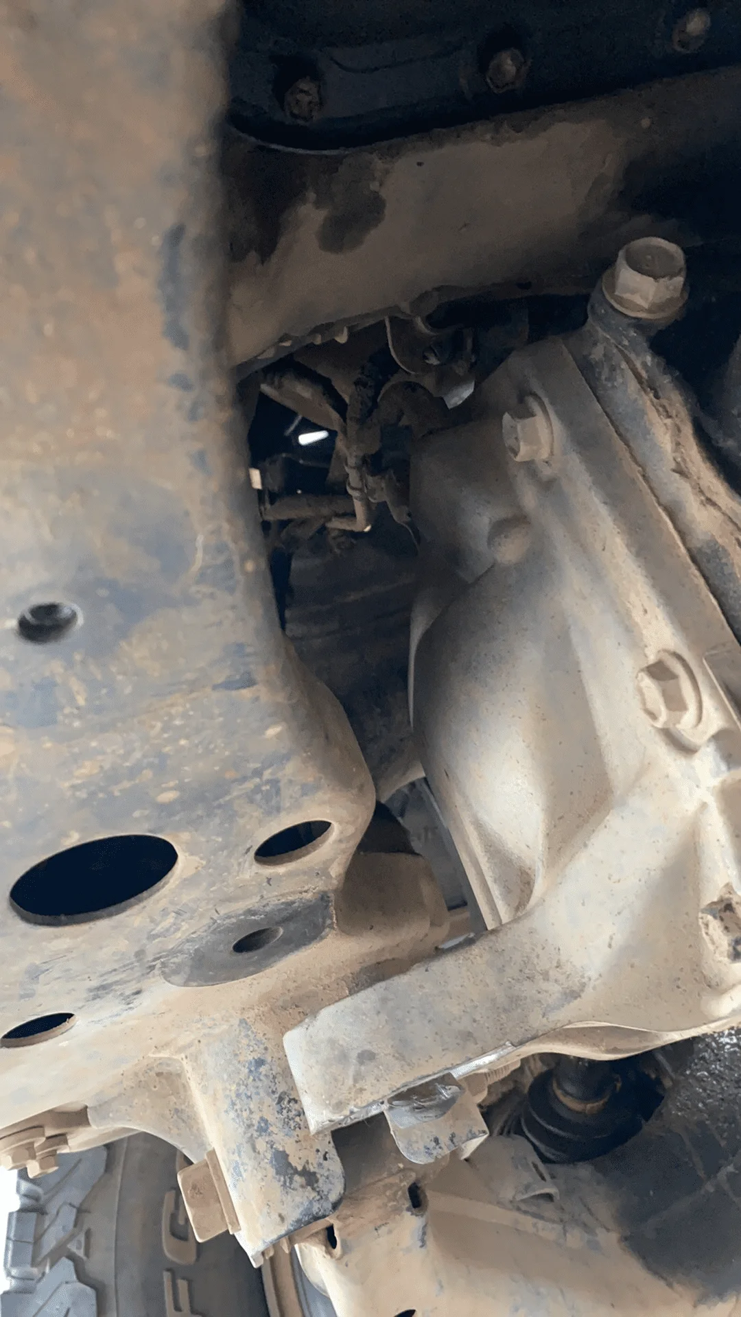

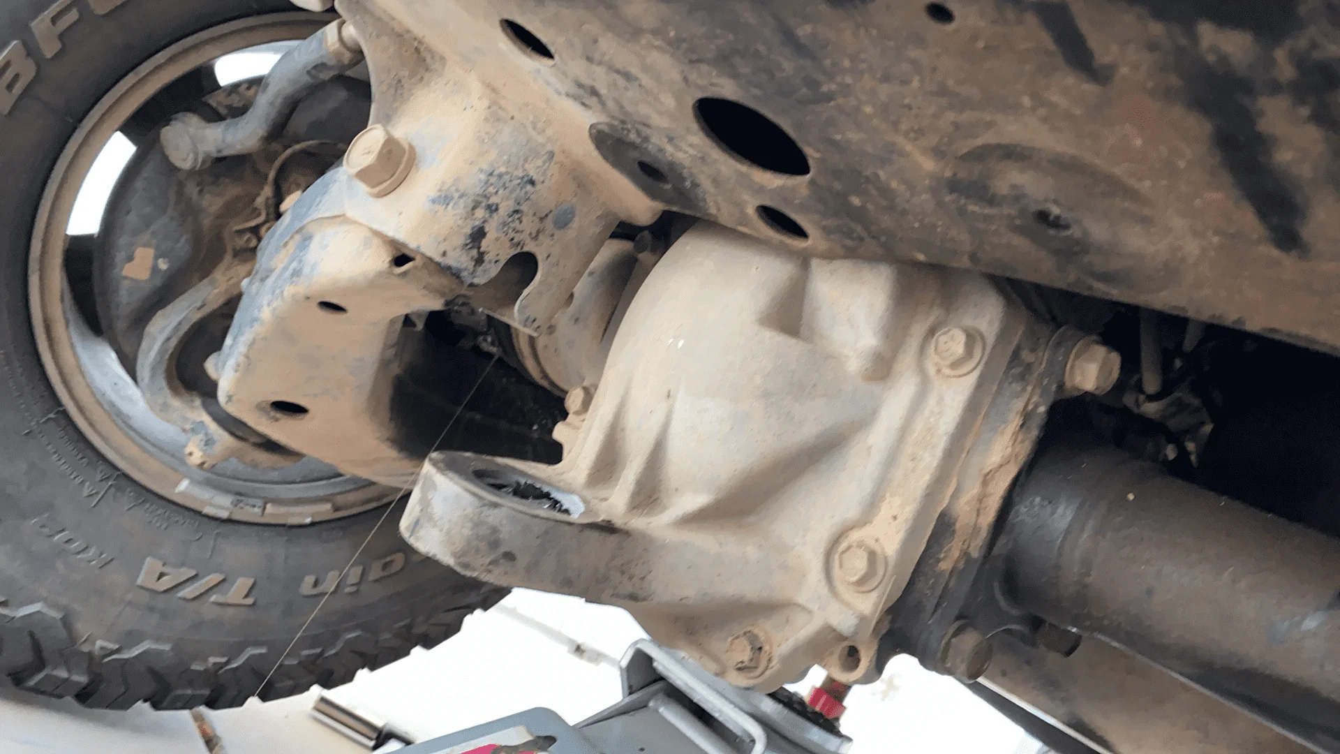

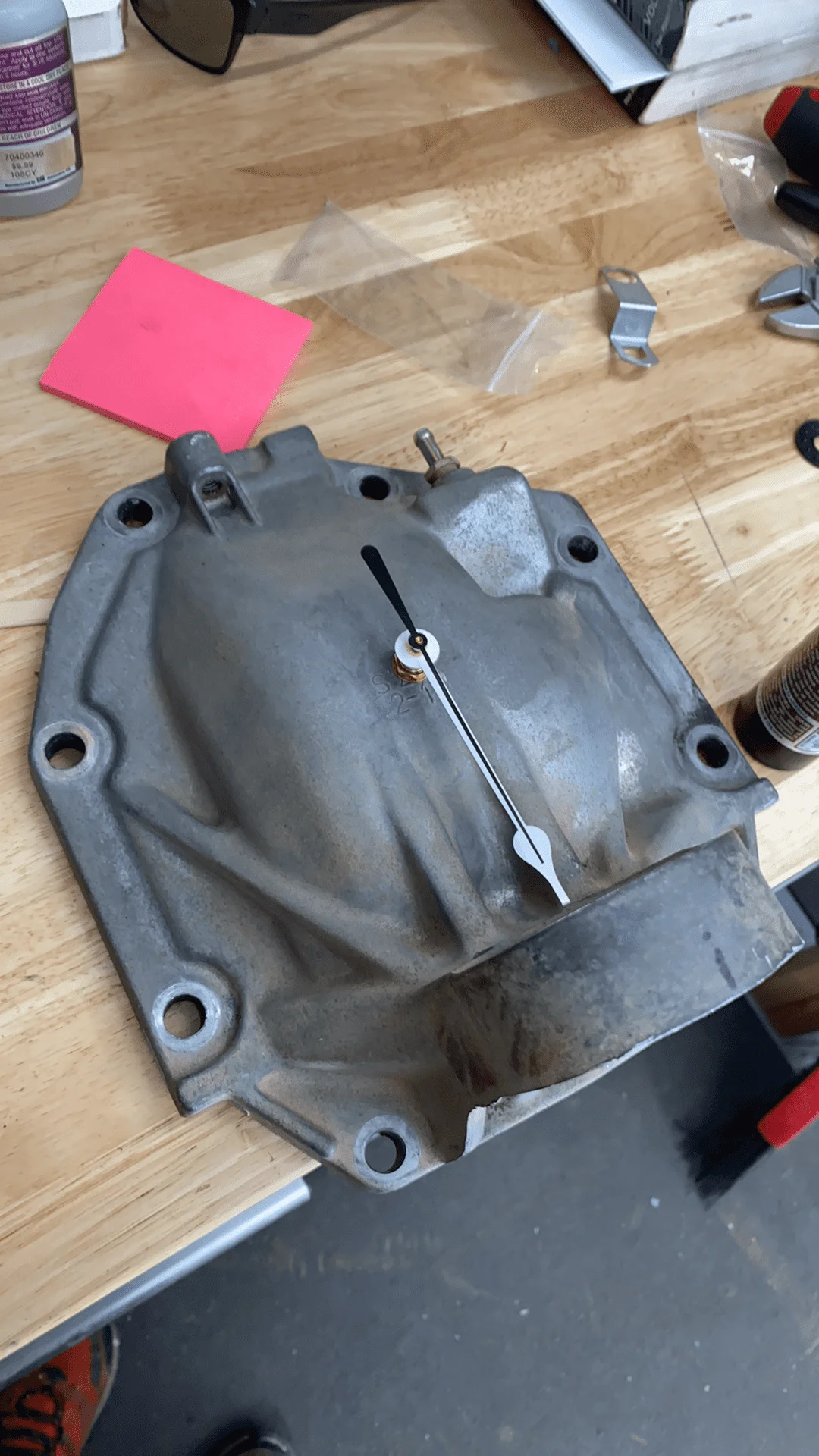

In case anyone is curious, you can get the front diff cover off with the diff still in the truck:
- All three mounts need to be removed, I left the aft upper bolted to the frame but removed the two bolts that fasten into the diff. This helped get the diff to rotate, exposing more of the cover.
- Front Drive Shaft needs to be removed so that the diff can rotate and be pushed away from the forward crossmember
- Was helpful to use a floorjack to lift as needed and let it move around
some pictures:
(ignore the stream of grease as my cv pukes it's guts out)
And to commemorate my massive failure, turned the old cover into a clock:

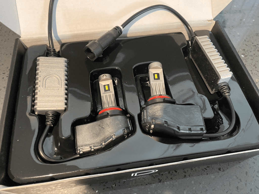

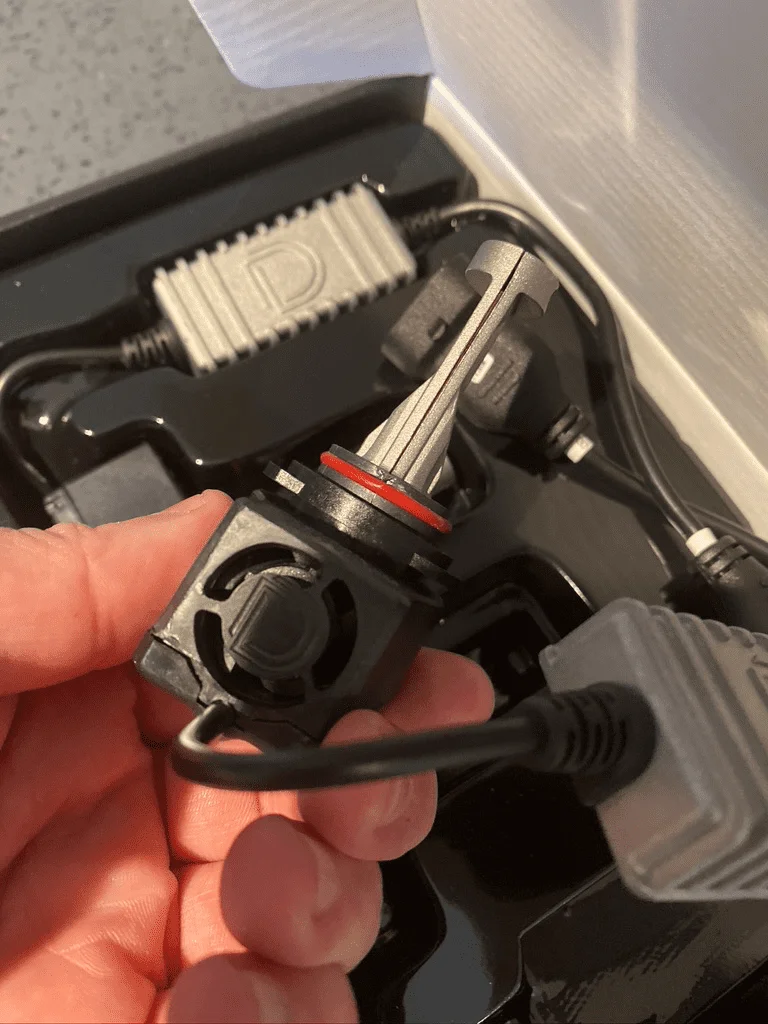

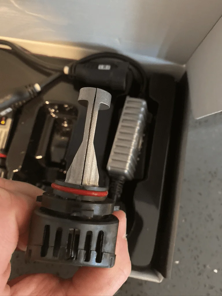

The 100 got some new bulbs: Diode Dynamics SL1's
After a lot of discussion, @knewstance convinced me to give these a try instead of doing a full projector retrofit. So far, I am REALLY glad I went this route. If you aren't familiar with the process of a full protector retrofit, have a look here:
These were $150 for the set, plug and play... sure beats the few hundred for the projectors and the risk of disintegrating headlight housing, which I antipiate after a long life in the AZ desert. These bulbs each pump out 1.6k lumen and are designed to output the light like a halogen bulb, that way the beam pattern stays true....they don't blind everyone like most of the cheap LED's do.
