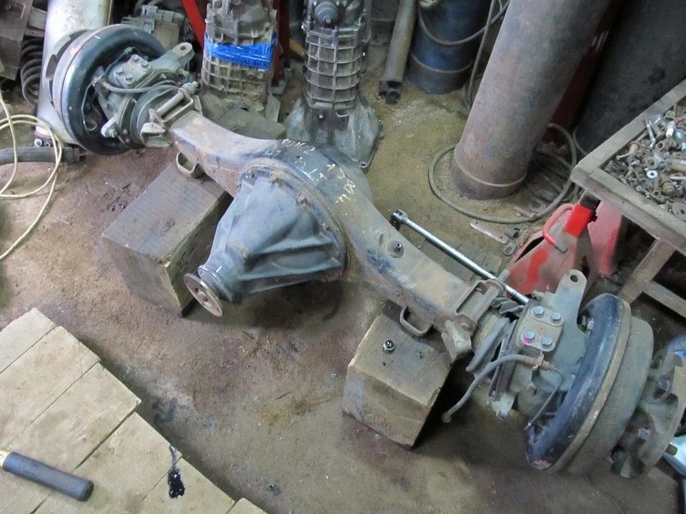

Are the 80 axle housings just doomed or can they be made durable? I see they make gusset kits that you can weld to the balls. Would that fix the bending? What about cryo treating? Then they'd just crack instead of bend, right?

There is no constant statistics, some bends, some cracks, there were cases of shattering like a glass. Which tells that Toyota's QA on metal treatment is at very very poor level.

Some people do, I did not, as I was assured that nothing can break the weld seams made by hi-tech equipment. But it broke on the metal right along the weld seams.

I think there is something more happening here with the bent front housings....
Looking over some of the pictures, it looks like the outer part of the axle assembly is perhaps leveraging off the lower coil mount, specifically this is where the front bumpstop is located.
The 80 series isn't a light weight to begin with. It has a very heavy engine that is fairly far forward in the chassis. It is fairly routine, also evident in these pictures, that people are installing heavy front bumper assemblies. An ARB winch front bumper is 150lbs(?), a winch is 50-75lbs, then throw on some lights, and a 45lb high lift on it too. Adding 200lbs of weight on the front axle isn't helping anything.
Most 80-series also sit fairly nose down with limited up-travel from ride height. It would be interesting to know how much uptravel the vehicles had that are having common problems? The 80 series also has a fairly robust front bumpstop which may not be giving as much as people think without adding a severe spike in spring rate.
The axle needs TIME to slow down, and enough shock damping to dissipate the energy into heat. Travel is fairly limited to begin with. I believe the stock front shocks have about 9.6" of travel in the OEM form. Personally. on a stock 80 I would live to see 5-6" of that in uptravel on the front suspension. The front suspension will compress and clear everything with the front rubber bumpers removed from the cup. With the chassis leveled, the front suspension actually has the potential for 1.5" more uptravel vs the rear.
If you are constantly into the bumpstops things are going to break. Instead of the shock doing it's job, the axle housing, frame, etc are going to have to be strong enough to absorb all that energy....it doesn't look like they are...

For us it is very common problem for normal use. Nobody even gives a damn just pull the axle out weld it, reinforce it, put back and keep it rolling. I am pointing out that IT IS A PROBLEM and all what I can say we should just wait and see if Toyota did their home work and fixed that problem in their new utility vehicles.
I am p*****ssed off because spent a fortune and it broke again. Not saying that I already experienced rear axle bent and replaced. Going back to the subject of Danas into TLC I believe it is a best match for a such vehicle.
