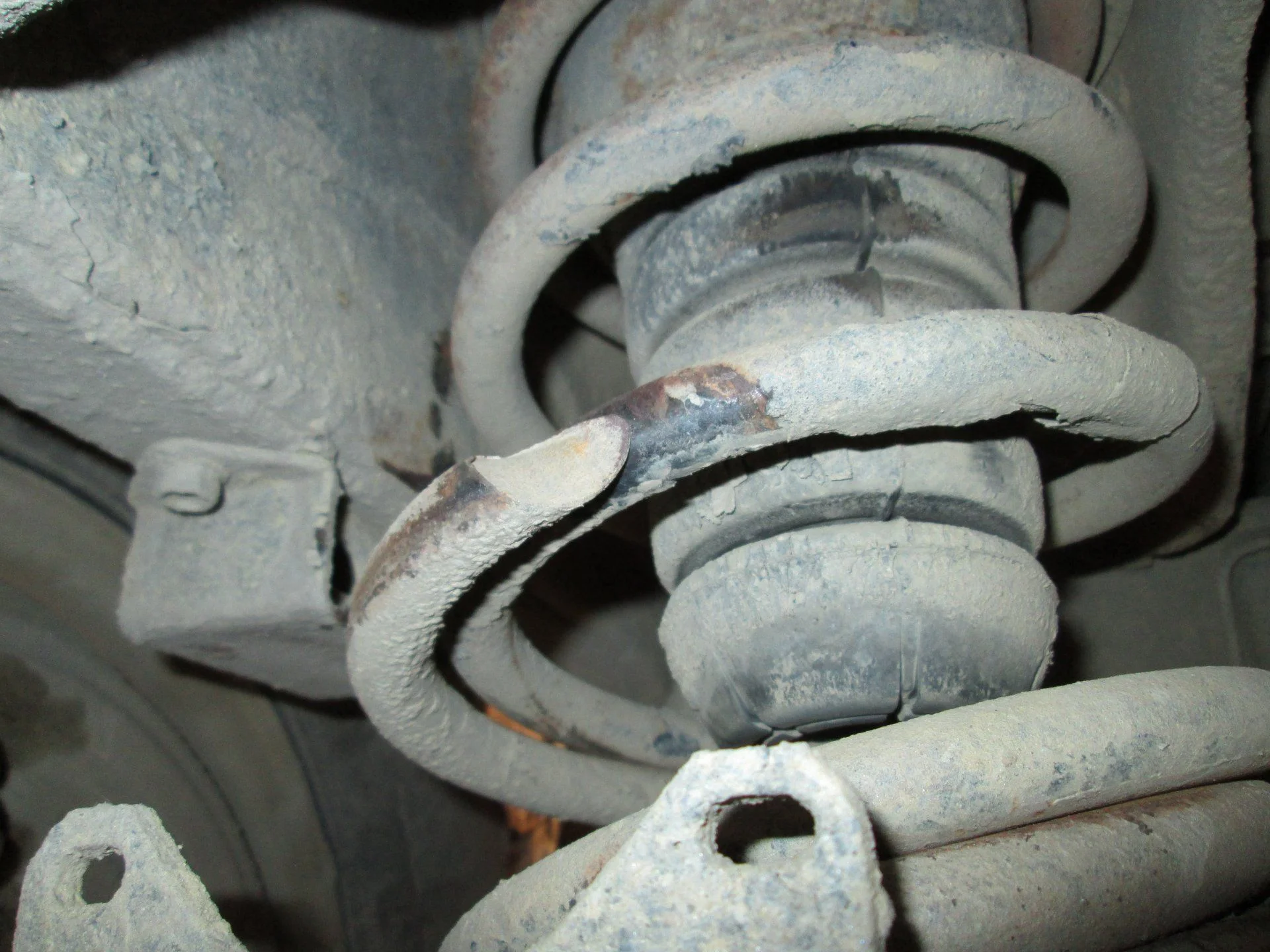

I have managed to break both rear springs at the same time without damaging the rear axle:
from the rear by Peru Darrell posted Jan 24, 2015 at 4:46 PM
Overall it doesn't 'look' bad, but I have a few questions...
Rear springs. Are they blocking at full bump? Are you running any bumpstop extension? Typically springs break because manufacturing defects ( quality issues ) or because they are binding at full compression. If both broke, I would lean towards coil bind rather than a double defect....
The extra front end weight isn't helping anything.
Are the bumpstops acting as the bumpstops....not a shock that is too long or some other hidden issue. Shocks acting as bumpstops or limiting straps is generally bad.

The rear springs broke from overloading in the rear combined with some really bad dirt roads with giant potholes. Had to ride about 60 miles on the rear bumpstops to get home, that was a rough ride, but no rear axle damage. The rear axle must be stronger than the front axle. Just to show, OME Springs can break.
