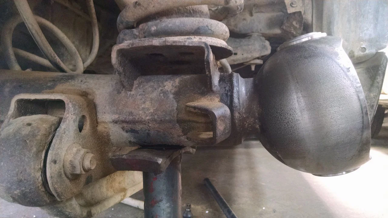

Well if the LC80 axle is weaker than my 105 I would look into a change. My FZJ105 is in the shop to straighten the front axle housing after one too many rough trails. Housing bent between the leading arms and the birf ball one one side, can't really see it in the pic
, but the camber is way off.

Well if the LC80 axle is weaker than my 105 I would look into a change. My FZJ105 is heading to the shop to straighten the front axle housing after one too many rough trails. Housing bent between the leading arms and the birf ball one one side.

Well if the LC80 axle is weaker than my 105 I would look into a change. My FZJ105 is in the shop to straighten the front axle housing after one too many rough trails. Housing bent between the leading arms and the birf ball one one side, can't really see it in the picView attachment 1314259 , but the camber is way off.
