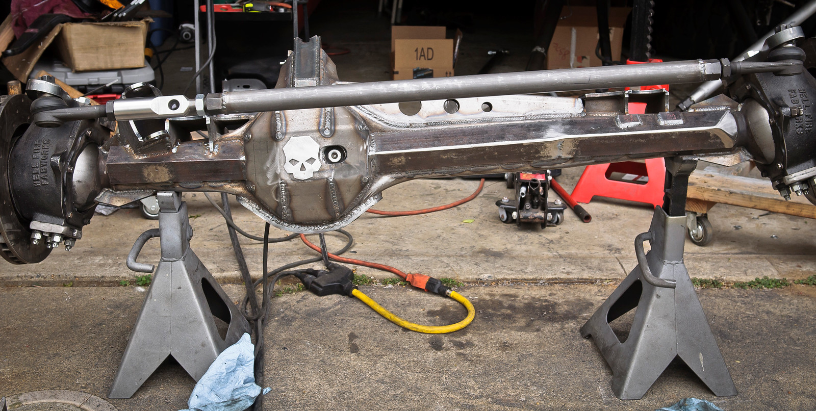

Or we could actually talk about WHAT is making the axle housings bend. Hint, it probably isn't just the axles fault....and if you stick a super stout housing in there you are only going to move the problem around. How about ripping the coil/bump towers off the frame? That sounds like fun.

Yes, run a gusset all across the front from ball weld to ball weld. Then just put some little gussets top or bottom from the housings onto the knuckle balls. Booger weldz did this when he built his won ton axles on pirate4x4. I don't have the link but not too hard to find. I think he since rolled his 80
Ummm....
Stuff is pretty tight at bump.
You might be able to build something pretty thin over the axle using some of the wasted space under the coil perches and stuff, but there just isn't much space. The front axle goes really high into the chassis at bump. If you lowered the bumpstops a lot that might make some more room, but I don't think you want to give up bump travel from ride height to solve an axle bending issue.....
