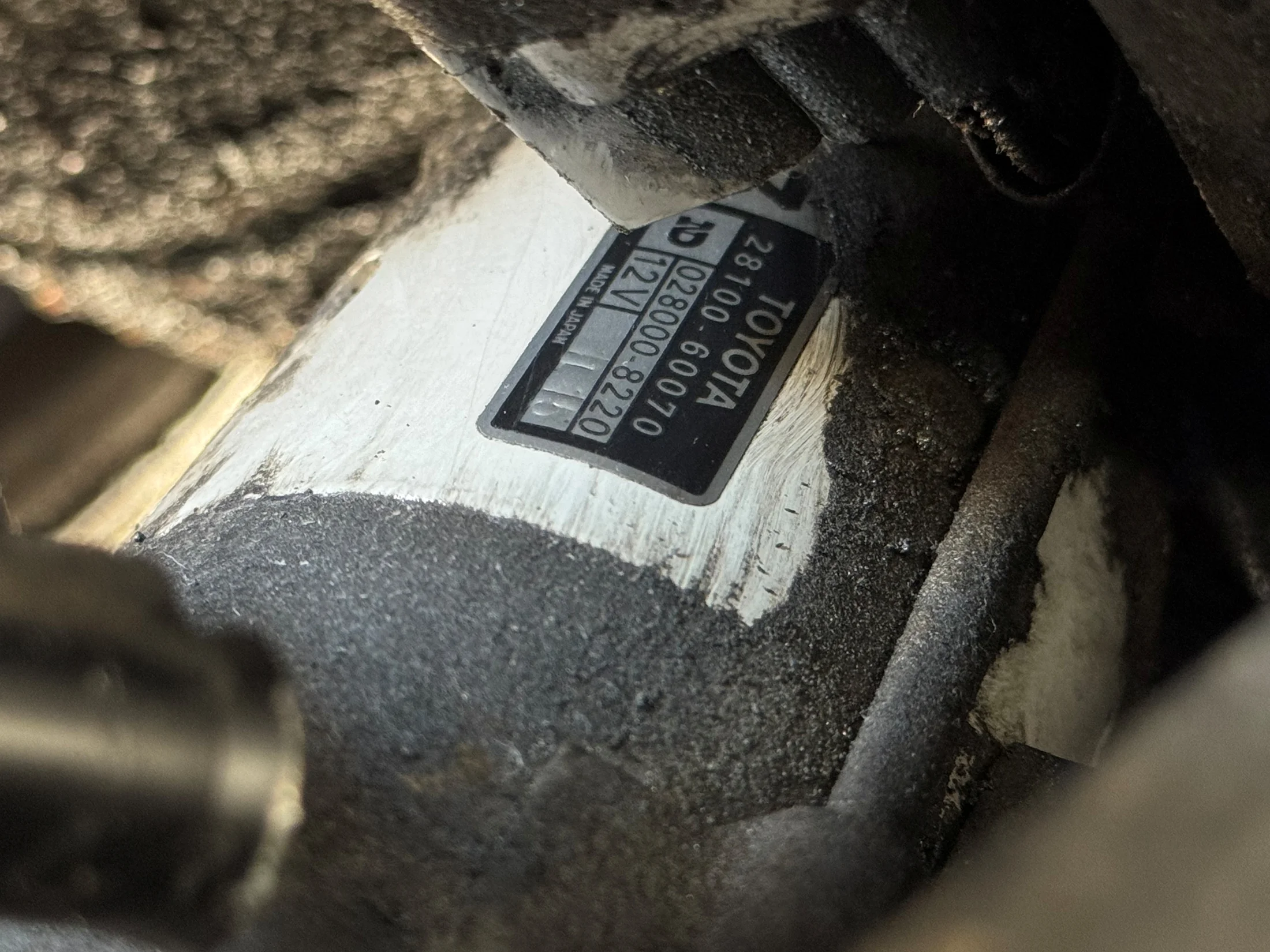

@Demonic92 : Take a photo of your current starter including the part number sticker if it's still there and post it up.

The sticker is probably still there, but my starter is so covered in grease and dirt that I am not sure where to look. Someone said look from the driver's side bur I can barely see it from the driver's side, both from the top and underneath. I guess I'll hit it with a can of brake cleaner and maybe someone here has wisdom on where the part # is on a 3FE starter?
@Demonic92 : brake cleaner (solvents) might remove any remaining letters. Just about any cleaner/soap (non-solvent), water, and paper towels or a rag would work.
Your starter (on a 3FE engine) would be located on the right rear of the engine, more rearward and a bit lower than the distributor.

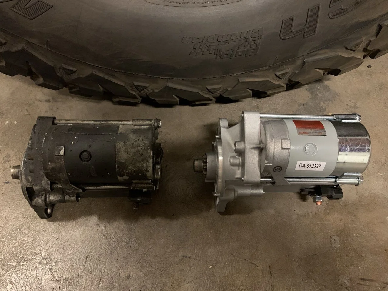

Here's an example, old starter and Toyota re-manufactured:
Finally got around to this. Have been driving less lately and it hasn't happened on my recent drives so I was almost inclined to put it on the backburner again lol.
Looks like the 28100-60070-84 is exactly what I need?

2+ months and a good bit of hammering on the solenoid later…. Finally got around to replacing the starter. Reman unit was $100 before the $60 core charge from my local dealership. It’s so shiny. Pretty cool they’re still remanufacturing starters for us and the 3FE so we don’t have to get Oreilly’s poorly remanufactured stuff. Even though we only need them every 34 years/275k miles.
People have said the top nut (which is on a stud) is the biggest bitch of the project, I actually didn’t find it too hard just using a 3/8” ratchet with a 6in extension, but it was a tight fit and the nut was on there TIGHT. Another challenge, I upgraded my battery cables with huge marine-grade custom made cables and the rubber cover that goes over the terminal on the starter was a huge PITA to slip off, perhaps because it was 30 degrees out. Then, the bottom 17mm bolt on the starter is easy to see but there is very little room to spin a socket wrench down there, so that required patience and finagling. Then just make sure you disconnected the other wire on the starter and it’s pretty easy to slide out around the other stuff around it. Installation is reverse of removal.
Took me about 2 hours with pee/beer/warming up breaks. I did not use ramps or a jack and I did not remove the front right wheel. YMMV, I have a small frame.
