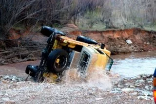

By the way here's the most recent pic of my Toyota. I had to majorly reduce the size to make it "postable" so it may be poor quality now.

Nice rig. On the bubbles in the overflow.........that's a bad sign my friend; indication of a blown head gasket. Did you do a compression test, if not i would.
