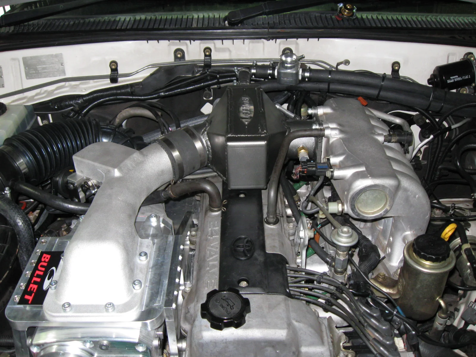

Maybe i missed it, but in Bullet cars ad you provided, i don't see an intake manifold listed in the parts that come with their kit, In the photo in their ad it shows a different intake manifold then whats on our trucks here in the states, so that may add to the cost of installing/buying their kit too,

The engine in the pic is a second generation 1FZ - different intake, wasted spark coil pack ignition rather than distributor etc. Found in FZJ105 and FZJ7# 1999 and newer.
Check that they are including plumbing for an 80, but I have seen the kits on 80s so assume they can provide this.
