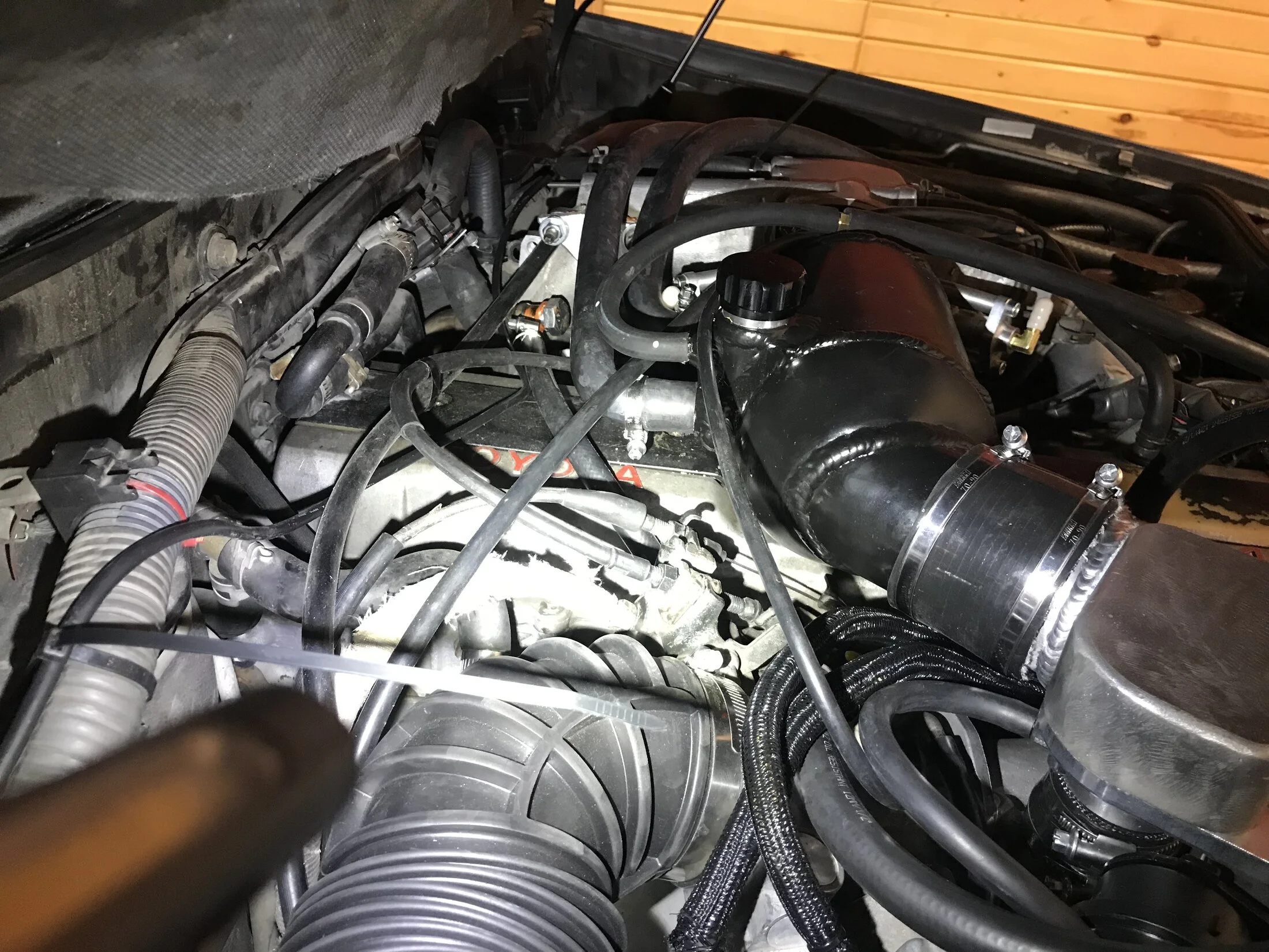

Ok guys I got the kit installed and running. Afrs seem to be just right dropping to 10-11 during boost for the most part. I have noticed if I go up a long steep grade around1-2 psi it wants to stay at 13-14. My only real issue is my long term fuel trims are +10 at idle and + 16 ish while driving. I tried to do a boost leak test but can’t figure out how to do it on a supercharger. I tried going from the intake but blew out the throttle body seal and had to pull it apart and put more gasket maker in there. Also my boost gauge only reads 5-6 at wot and this is a 7 psi pulley. It is a s***ty gauge form advanced so that could be the problem. All in all I’m happy with this kit. Boost is so instant it really feels like all motor just way more power. And it sounds like a damn hellcat at high rpm. Also the belt is super easy to pull off and zip tie the bypass valve if you wanted to run it with no boost it runs like it’s stock like that. Tried to attach a video of revving it for you guys but can’t figure it out

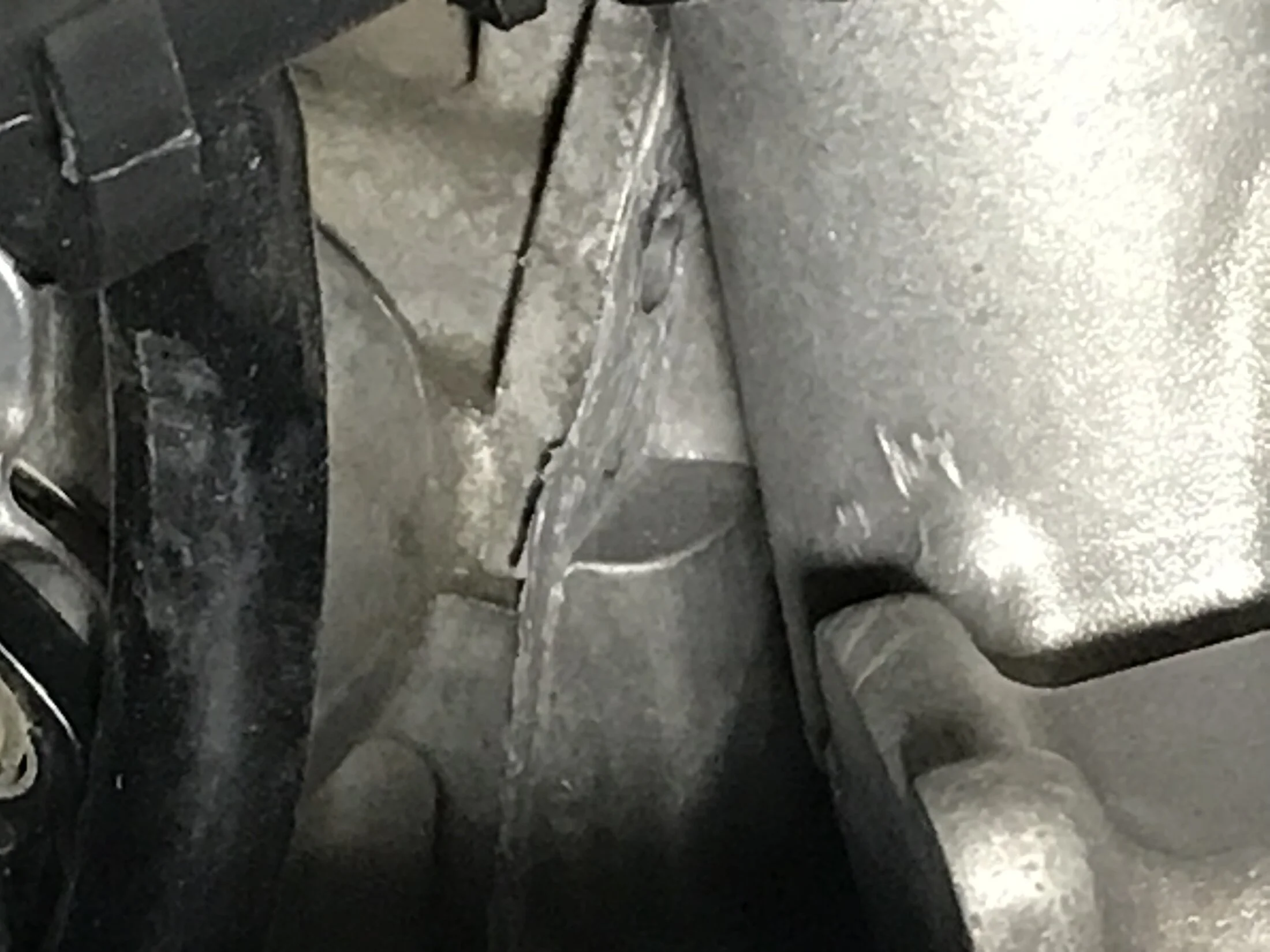

Think I found my vacuum leak and possibly boost leak? Looks like the supercharger flange the throttle body bolts to is not the exact outline of the throttle body and actually comes in enough to leave a hole from the throttle body about the sensors open. How can I plug this hole
I plugged that hole and figured out the bypass valve was hooked up wrong. It now makes 10 psi instantly. Afrs are good still but I think I can hear either detonation or soemthing rattling. I assume I need to either up the octane or pull some timing. I’m gonna throw in some octane booster and see if I can get rid of the noise. The noise occurs even at 10.5-11 afr.

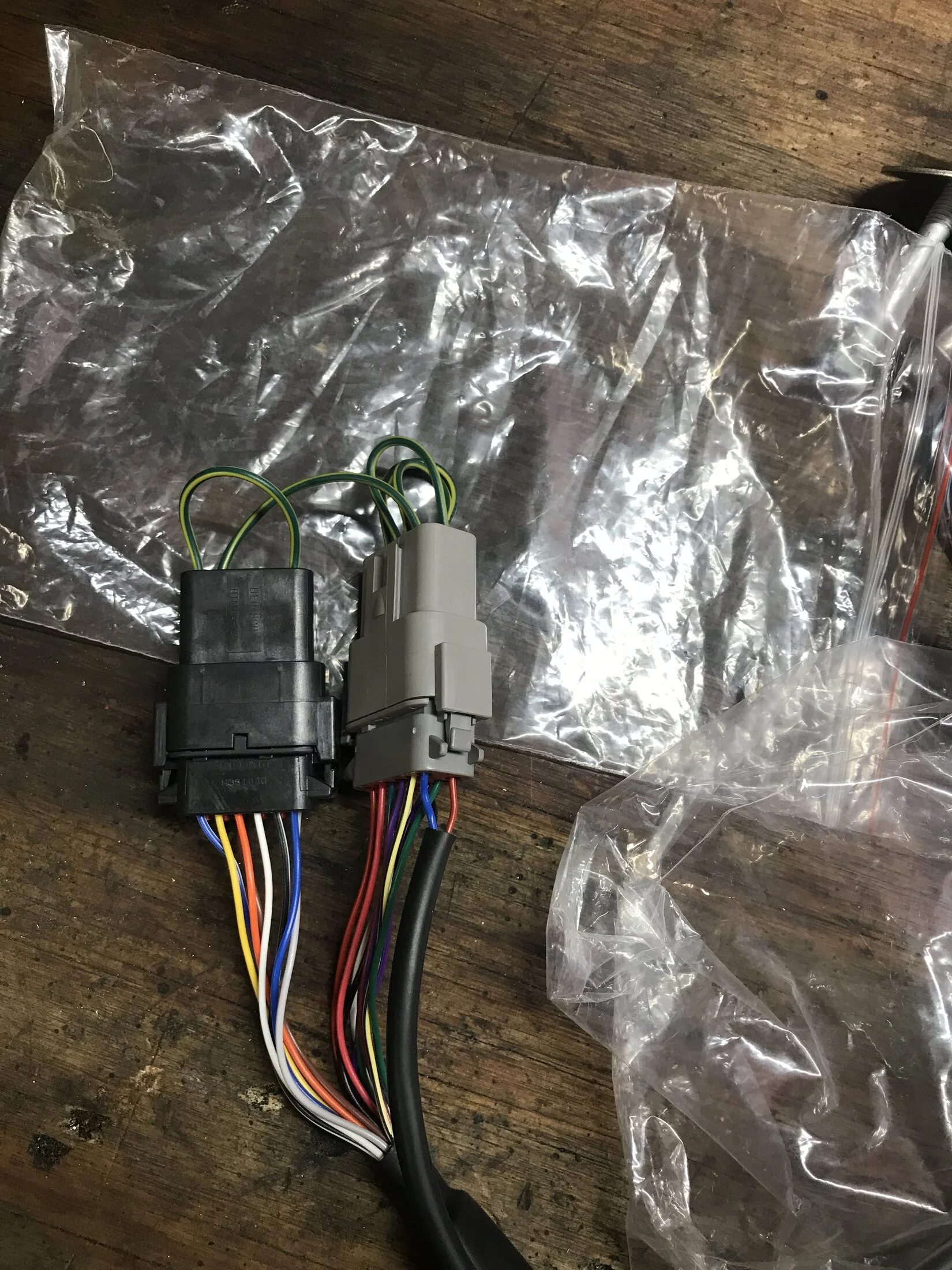

Another cool feature of this kit is This harness came with jumper plugs so you can unplug the xede and plugs these in and it bypasses the spliced wires. I assume so I could still bypass the supercharger and not have tune issues
Got the xede wired in yesterday it really wasn’t as complicated as I initially thought. It was like 6 wires from the ecu I had to mess with. Got it hooked up and had to configure the timing pattern off the website and that didn’t work so they had to send me a custom one. Maybe the Australian ecu has a different timing pattern? Got it running still trying to figure out how to flash the base maps. I don’t have the injectors hooked up with fuel lines yet I was hoping I could flash the map and at least run it with timing pulled.
