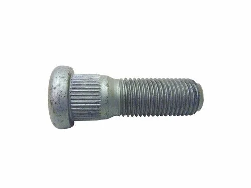

The studs are pressed into the hub and rely on ribs to prevent them spinning.
If they are spinning, you may have atripped the ribs off the studs, or wallowed out the stud holes in the hubs.
Either way, torquing to spec could be unpredictable
Agreed.

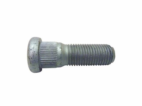

Here's another option, instead of the studs spinning in their bores, the studs may be Stretching, Remember he said in his first post that his front studs were replaced with newer studs, but are the the correct grade? I had something like this happen to me with a caliper bolt that some shop replaced with the wrong grade bolt before i bought my truck, When i went to tighten it to the correct torque spec, it just keep spinning, then without any warning it just snapped in two,
Could be.
If it's stretching, it's not gonna keep spinning for long.
If it goes round and round and round, studs are probably no longer secure in the hub.
If studs were fitted to an old hub, they are potentially gonna have less bite right off the bat because the holes in the hub are already partly opened up from the installation and removal of original studs

There are several reasons for this and they come down to something is the wrong size. Where did the studs come from? Cheap auto part stores tend to sell one size fits all parts. If your studs are too long or the spline area too small, this will be a big problem. I've installed more wheel studs than I can fathom. The ones that give me the most grief are the non factory studs.
The two biggest issues are spline diameter and length. If the spline was close, tightening it will clamp it tight as long as there isn't binding in the thread, if the stud is the correct length.
If the spline isnt tight and their too long, you can spin them too.
Any answer you get will be guessing. You need to measure things and find out what happened. Start with the stud length. If the spinning ones are the correct spline size, you need new hubs, the holes are now too big. If there too small, you "may" get away with proper studs.

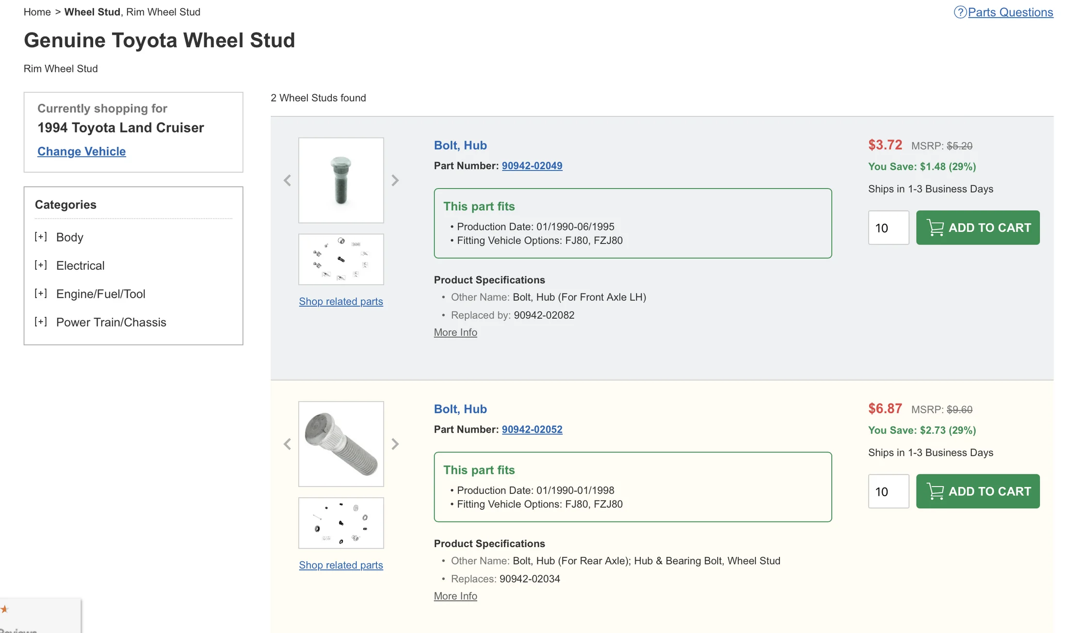

I remember something in the back of my mind where the front and rear studs are diffrent lengths but don't have time to verify that.

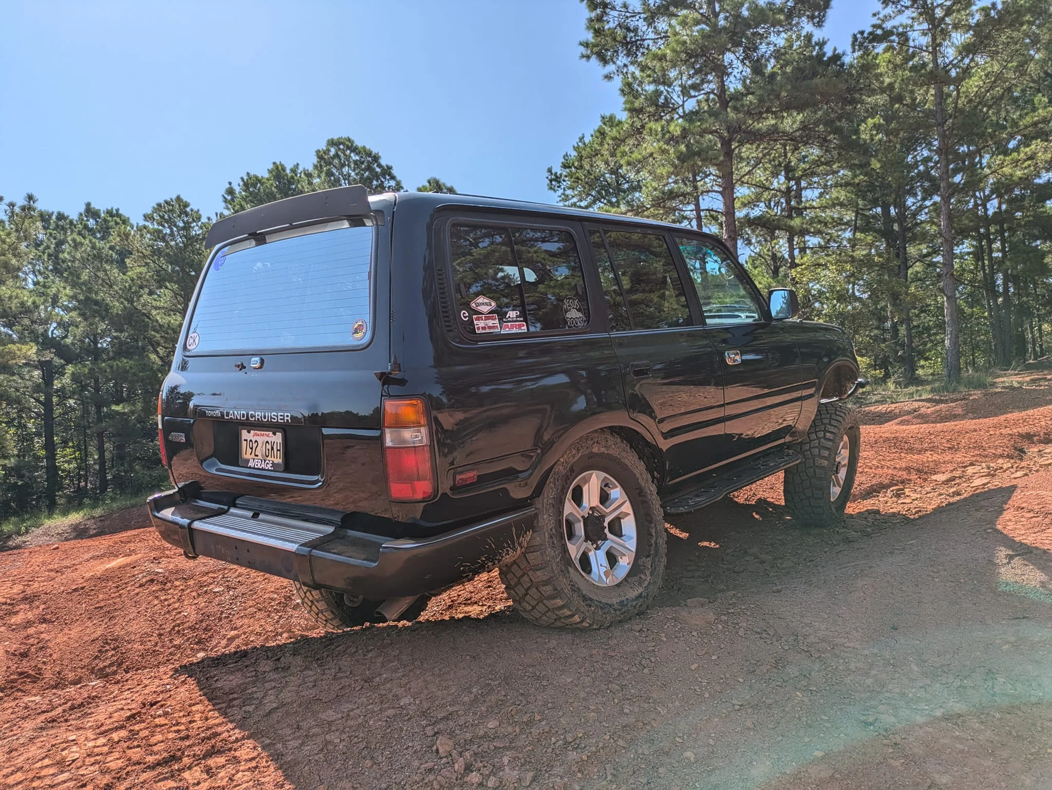

Slightly Off Topic--- those TRD wheels look very nice. Do they require spacers?
Majority of toyota wheels from this era shouldn't require spacers because they clear the hubs. I just took SR5 4runner wheels off my 80 and they fit fine.
They do not REQUIRE them, but aesthetically you might have different thoughts than me.
Once I properly adjusted the rear panhard I also didn't have any rubbing with 35s on a factory 4runner wheel, so that was also a benefit. Can't speak to clearance issues if you run spacers.
No spacers but they do tuck in, handy on 37s for flare/firewall clearance but slight rubbing in the usual spots with low backspace wheels.
To each their own, of course, but those wheels look too modern on the 80 Series IMHO. I like the FJ Cruiser wheels with the holes in them (eight holes?), but I'm not sure they look period correct, either. @mtnbiker4evr13, that is a very nice looking rig. I love the color and simple look - no snorkel, lights up front, etc. Very good looking truck you have there.
I like the OEM+ KISS approach. But as mentioned the factory wheels without spacers definitely sit tucked in.
I just just got a little tired of the stock wheels personally and wanted something slightly wider for the big tires. The SR5 have the same spec as those, as do most of the OEM 17s.
