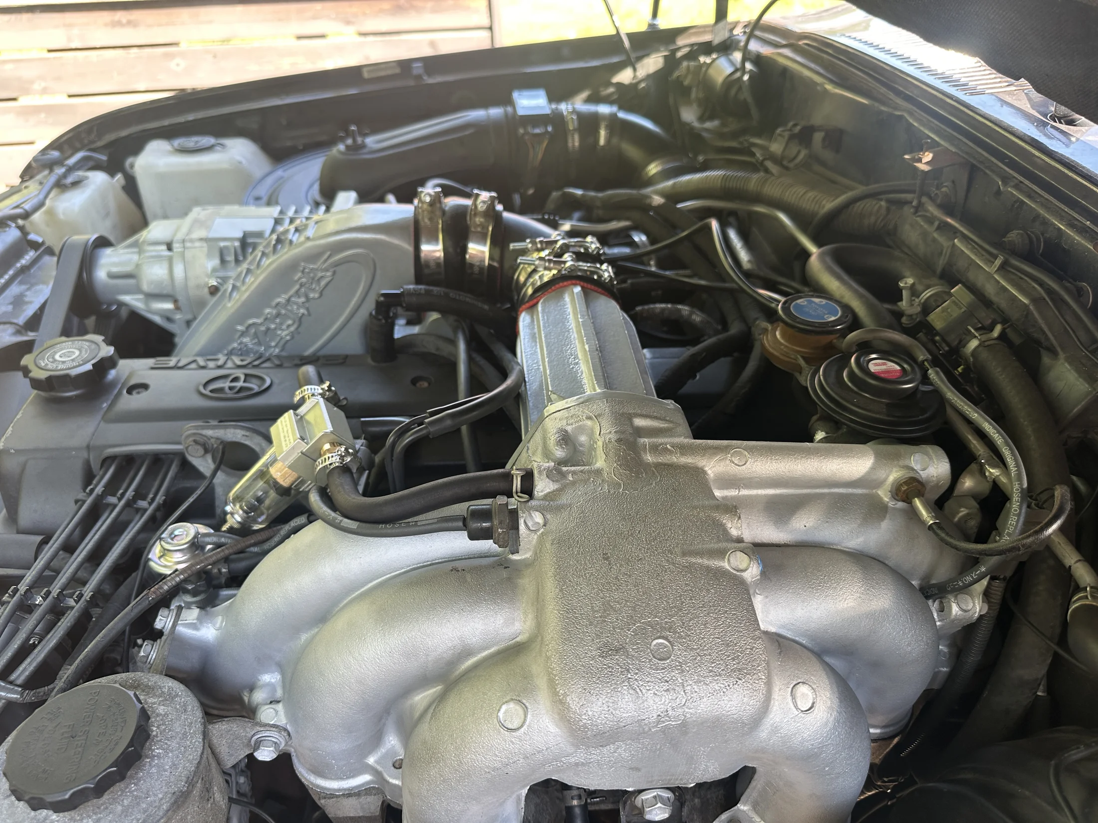

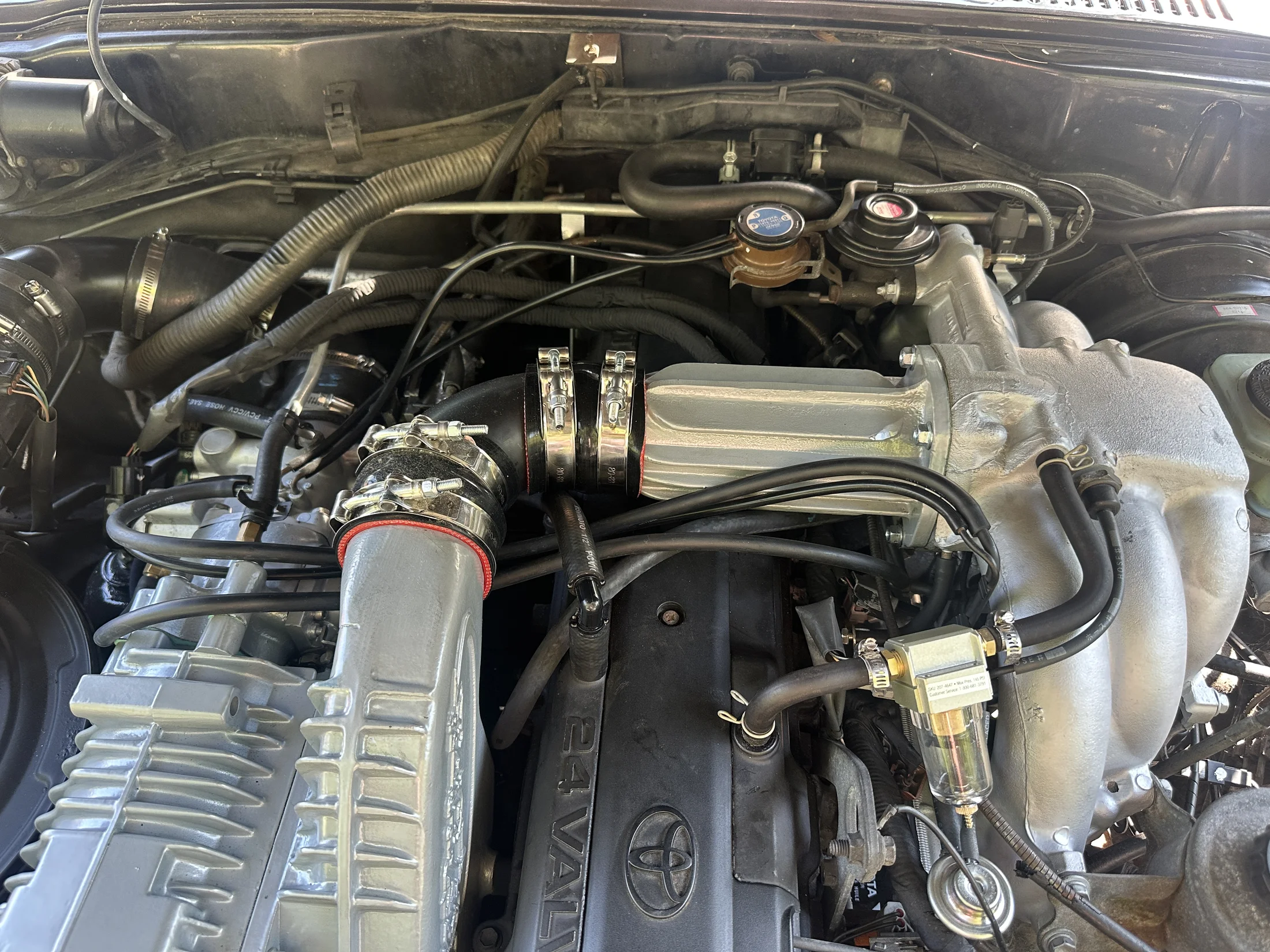

Do you have any photos of your setup installed?
