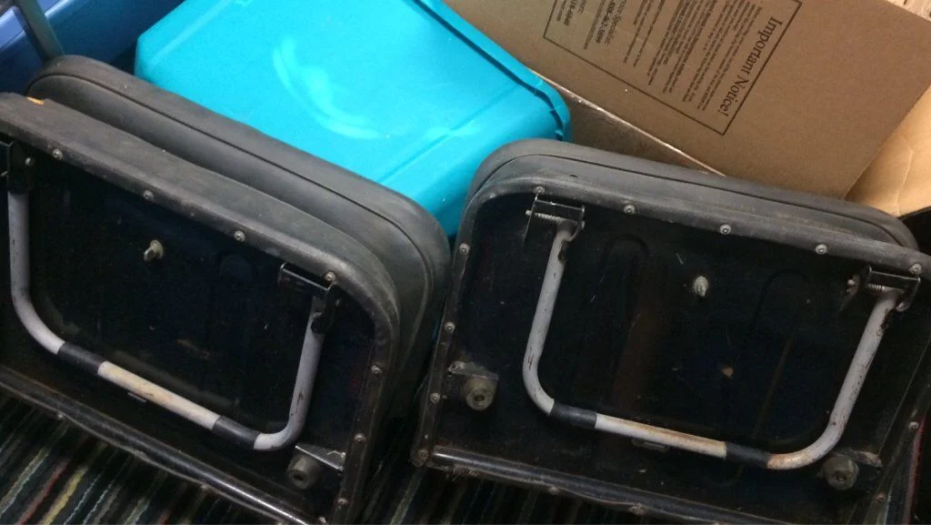

These came out of a 78 I bought from a member on here parting out a rig. I dont believe from what Ive read they were original to the truck that was a 78, they are different than the ones that were on my 78 but who knows what previous owners do to get parks. I dont mind I wanted ones with good metal.
They have a wider fold out leg than some ive seen with a narrow fold out leg. The tubing is on the outside on the bottom/but part but inside on the top/back pad part. The covers I bought from cruiser corps kinda fit them with some work but I dont believe I ordered the correct ones so that is nothing against them in any way.
imageuploadedbyih8mud-forum1409367360-234489-jpg.935750
another pic of bottoms

I have a set just like these. According to SOR the pad on the bottm stopped mid 78 model year. 74 and 78 were longer model years than other years because the next model year didn't start until January. It is also common for changed happened during the model year. While the tabs for the top of the tub started mid sixties the mounting points didn't change from two bolts to a single bolt until some time in 69. Angled bottom was 72 and 73 models. 61 Model had two arm rests like the FJ25 the 61 FJ40 were lower then the back rest. FJ25s they were the same height.

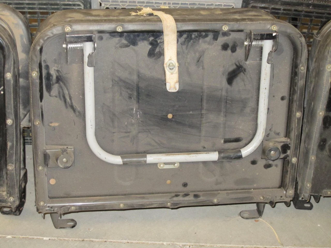

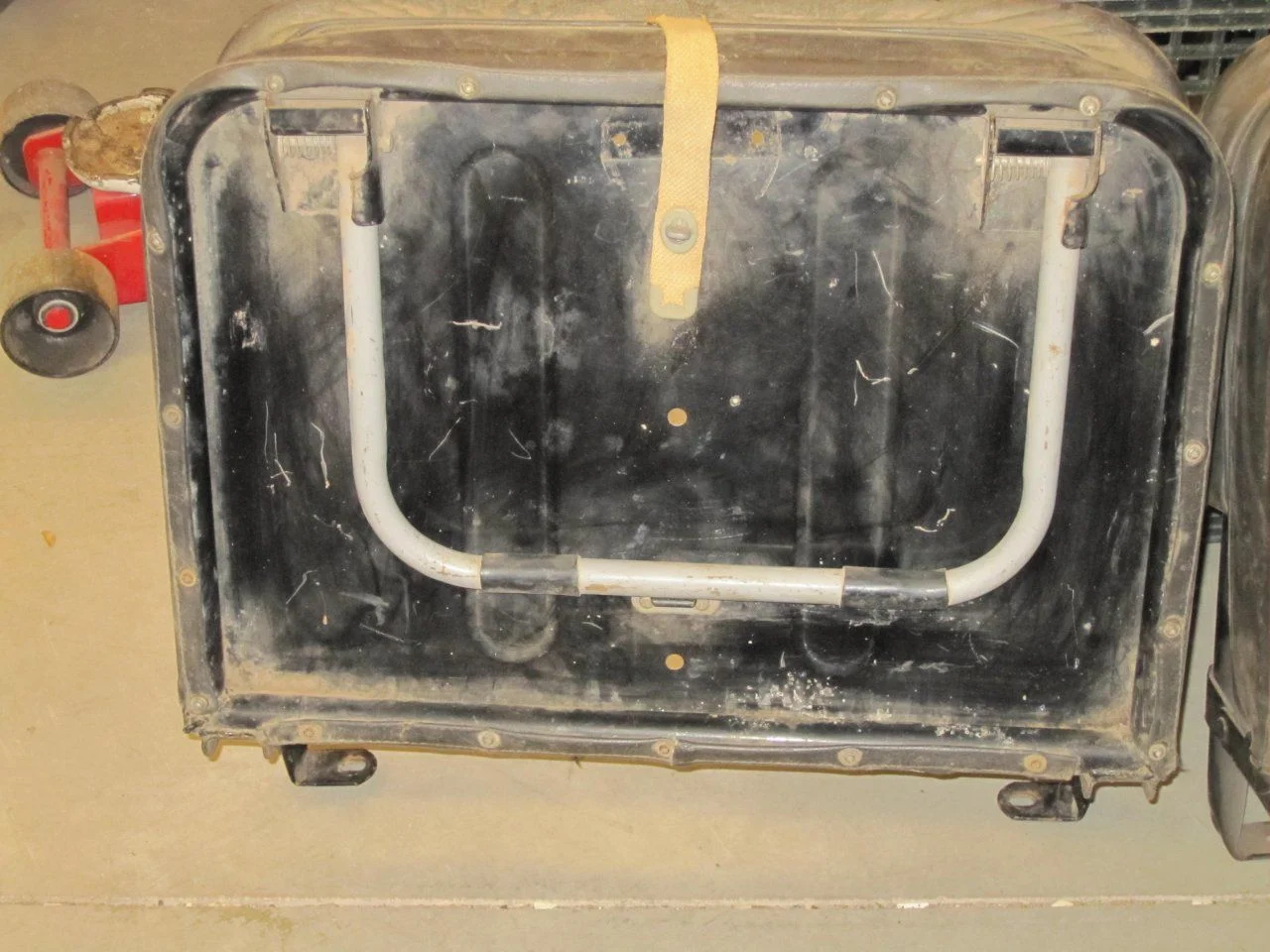

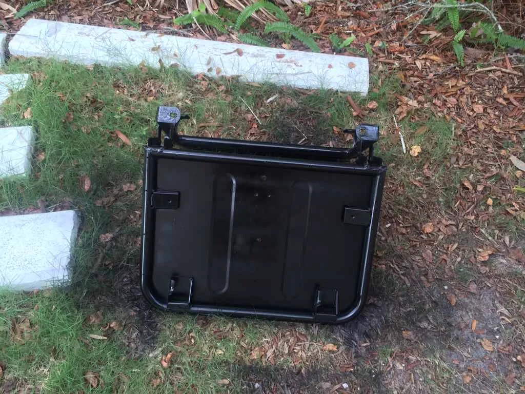

Here are some pictures of pre 79 jump seats. both types of folding legs found on 78s and another one I'm not sure the year of. I have 74 seats in my 68 FJ40 and 76 with original seats. I didn't realize the pads on the bottom were different between 74 and 75/76. Next time I around them I'll have to check it out. I believe I also picked up a matching seat for the non folding leg seat pictured here I could compare.
