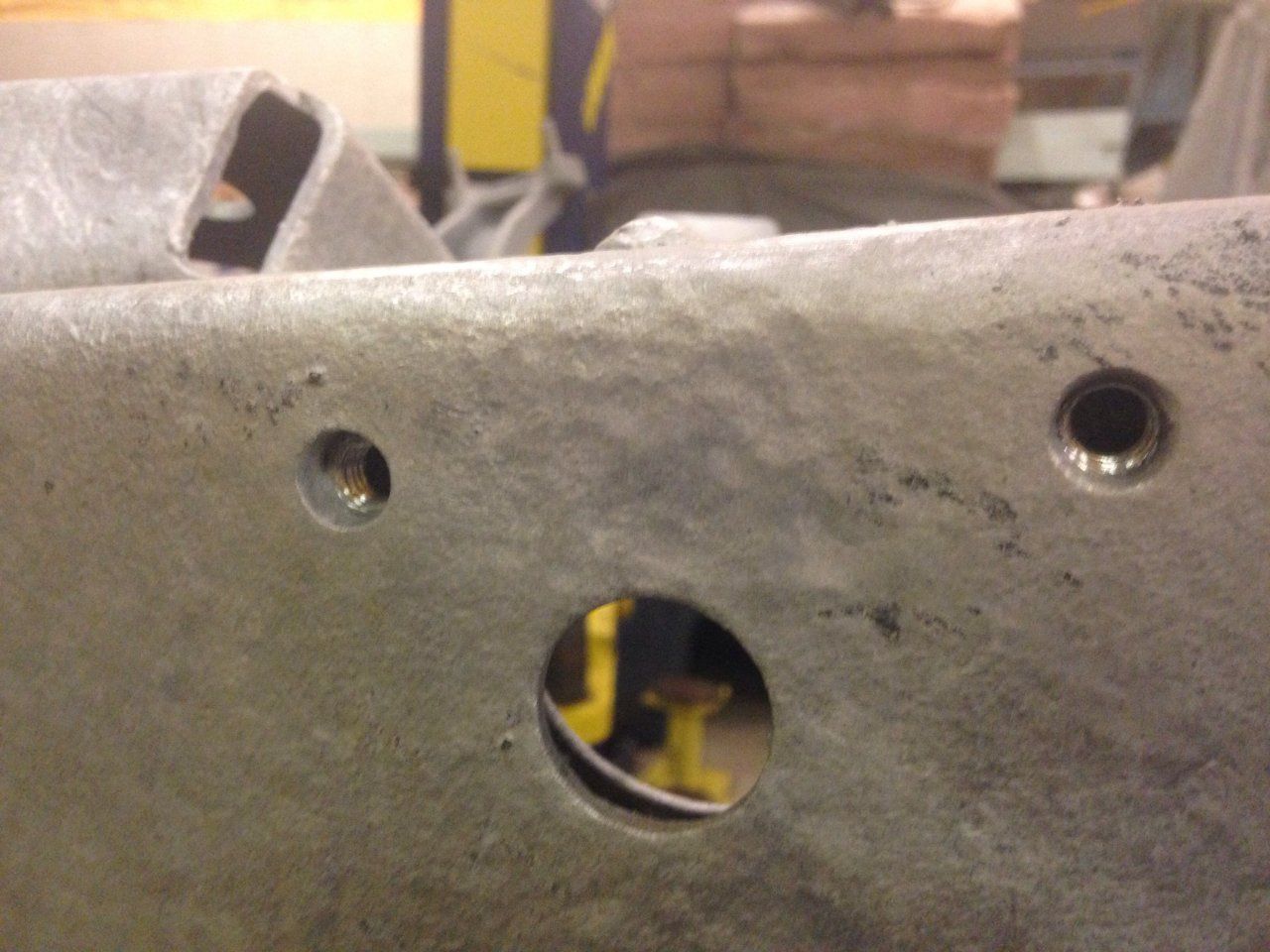

Thanks Tom, I'm glad to hear that some of this is not unusual. Interestingly today when I picked up the small parts, the guy who had this done for me showed me a few of his trailers that had been done in different galvanizing shops... Seemed to be quite a noticeable difference, though really, as long as it is coated in zinc it's protected.
Anyway, here are a few closer shots, the rear bumper came out nice and shiny!
I picked up a can of cold galvanizer today so I'll try it out in some of the areas where the zinc just didn't want to go!

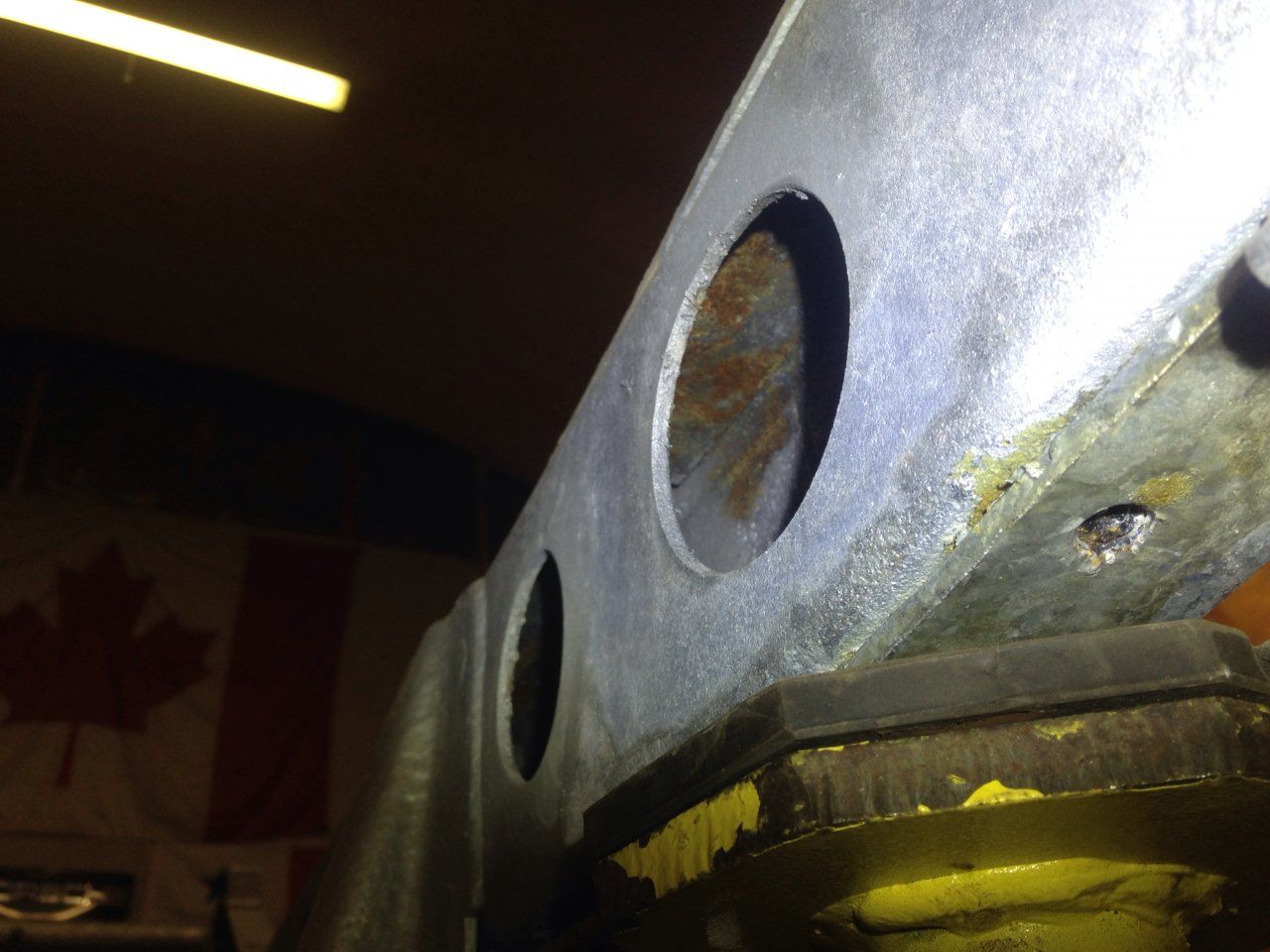

And here is the rear end of the frame with the bumper (above). These were done at the same galvanizing shop, but in different batches. You can see how much more grey the frame is and how shiny the bumper is. In time, it will all fade to the grey.
And here you can see one of the areas inside the frame that didn't quite get galvanized, or at least not as well as the majority.... I think a good solid wire brushing and some cold galvanizing spray will take care of this....
On the whole, I think this was well worth it. That said, when I move on to the 45, I think I'll knock all the rivets out blast the whole thing and do each piece individually. I don't regret not doing that on this one, but I think it would give a more complete finish, and not really a whole bunch more work.

Yeah, one area I need to work is the VIN, it almost disappeared under the galvanizing.
Surprisingly, it's pretty cheap, I may have paid a bit of a bulk rate by going through a regular customer of theirs, but honestly, it's much cheaper than painting. They do it by weight, so it depends on exactly what you are getting done - but I would be surprised if you paid more than $300.... I'm quite a bit less than that so far, including pickling.

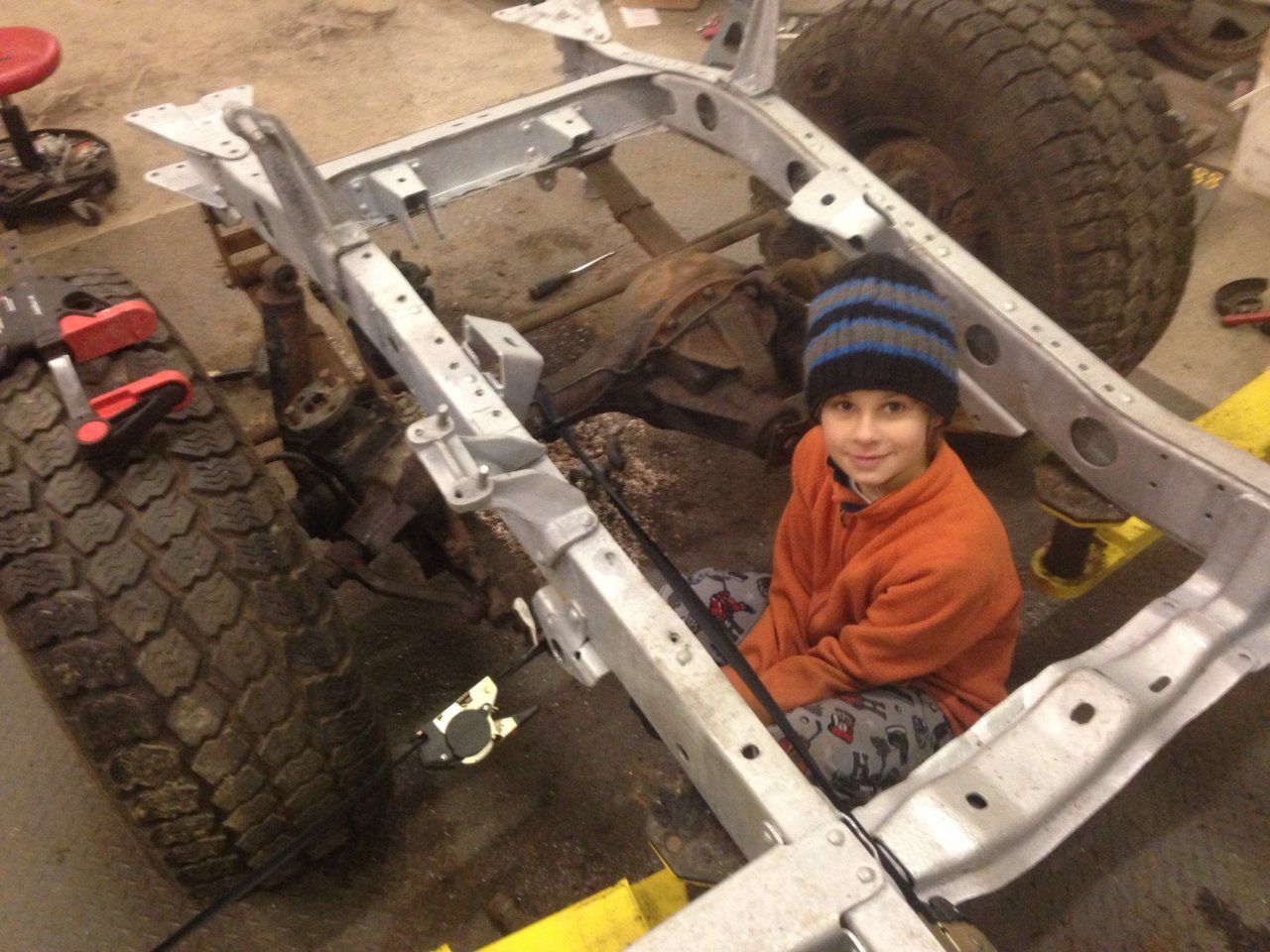

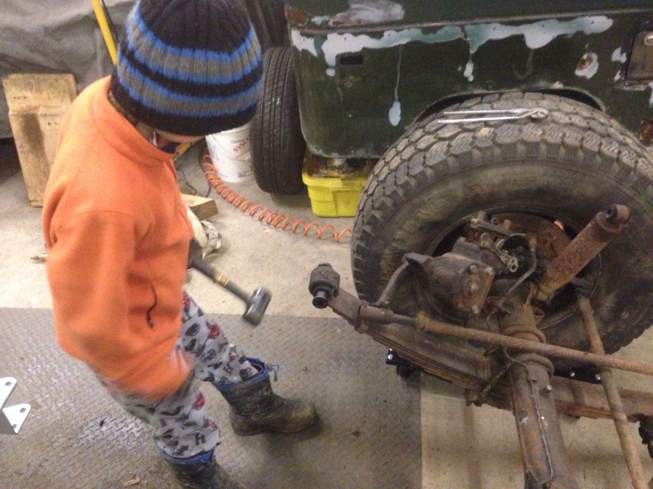

Had a little help today getting the new bushings into the suspension, and putting the axles back on the truck.
Yes, they are going back on all dirty for now, with the crap PO home brew shackles.
Plan is to get it back together and run it for a bit, then determine if I need to pull the axles apart and re-gear. At that point I'll strip and paint(/rebuild if needed) the axles, and either put a spring lift kit/shackles or tear these leaf packs apart and paint them.
He had just enough patience/interest/finger warmth to make it through the front axle (rear was already on) before having to come inside for popcorn and (BBC) Top Gear...

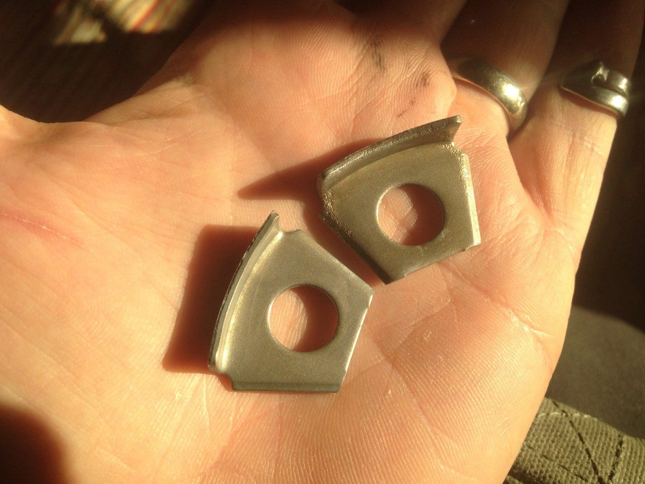

So I decided to play around with electro plating... I have so many old nuts and bolts, and little clips that I really don't want to have to source again, that I thought it would be worth a shot.
FYI, the process is really simple. Does take some time, and I don't think I would try to do every single but and bolt, but for the special ones it's definitely worth the little bit of time.
So, first thing was to blast the parts clean... (These are from the steering joint, and a random fuel line clip)
Then suspend them in the electrolyte with the zinc anode (the flat plate in the back of the tub - (just a small plastic food tray, about 6" x 4"). An old cordless screwdriver charger @ 3.5VDC 250mA with positive connected to the zinc and negative on the wire suspending the parts...
The parts start to fizz, and after a while they go all grey looking. Take them out and wire brush them with a brass brush and toothpaste (yes toothpaste), clean off with rubbing alcohol, and dunk them for another round or two.
I have yet to finish the final clean on all the parts, but here are the two clips, a nice smooth finish and satin colour!
I followed directions found here, with a few exceptions...
http://home.comcast.net/~rt66tbird/website/zincplating.html
1) I didn't use any Zinc Sulfate because I didn't have any.
2) I didn't use Karo brand corn syrup - not sure we have that in Canada - I did use glucose stuff that I found at Walmart though.
I couldn't find a zinc anode easily (didn't go to west marine, I know they would have them there) but instead used zinc sheeting that comes in a roll at Home Depot - designed to keep moss from growing on your roof. It's 99.4% pure, so good enough for me.
Pretty happy with the results - I'll be doing a few more bits I'm sure!
