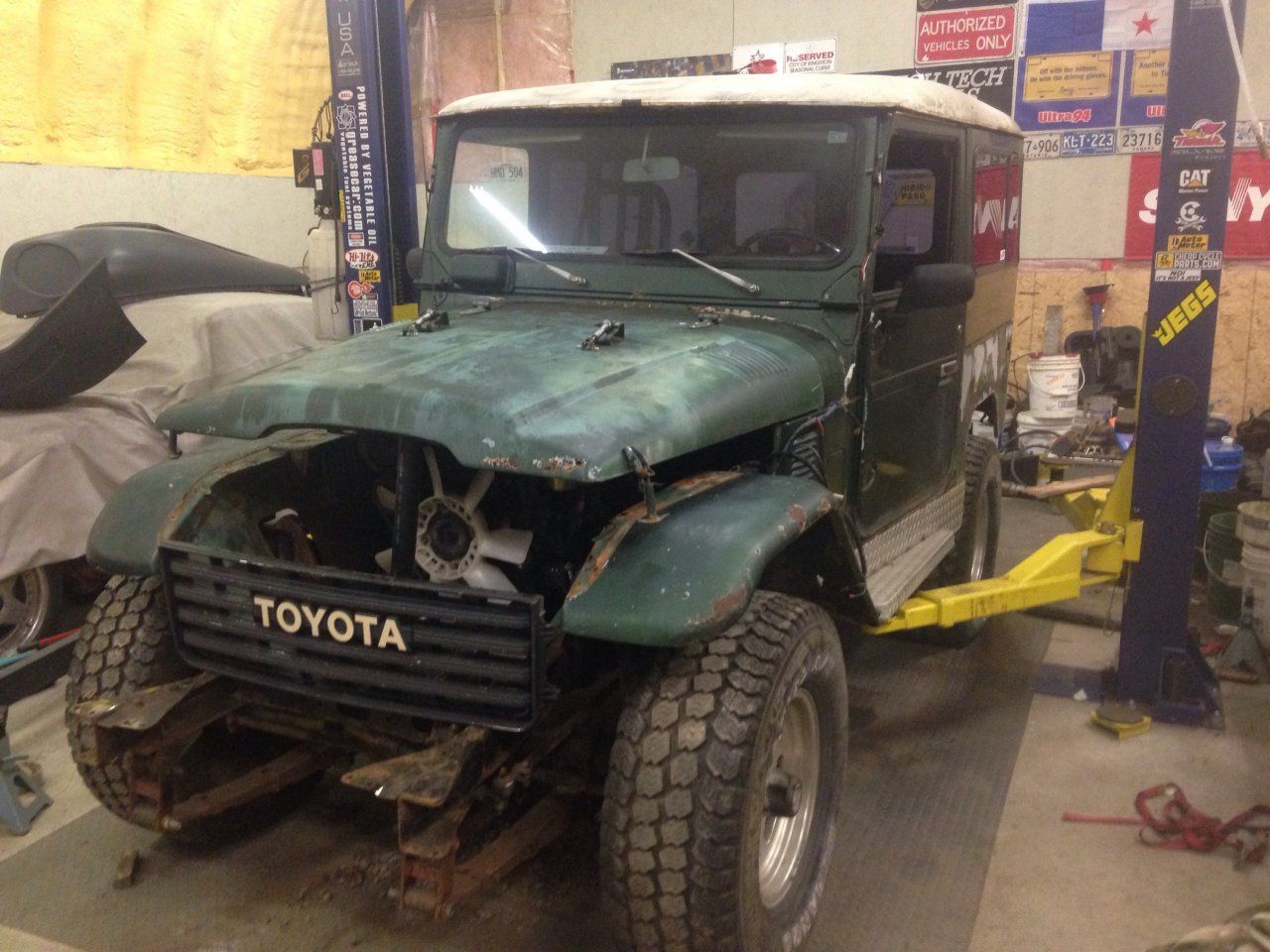

Relocated the trans mounts a little further back. Getting ready for a test fit under the body.... Let's see how screwed up I got it!
WOW! Like it was designed to fit or something! Smack bang kersplickity exacto perfecto... I guess my cardboard cutout template worked!!!

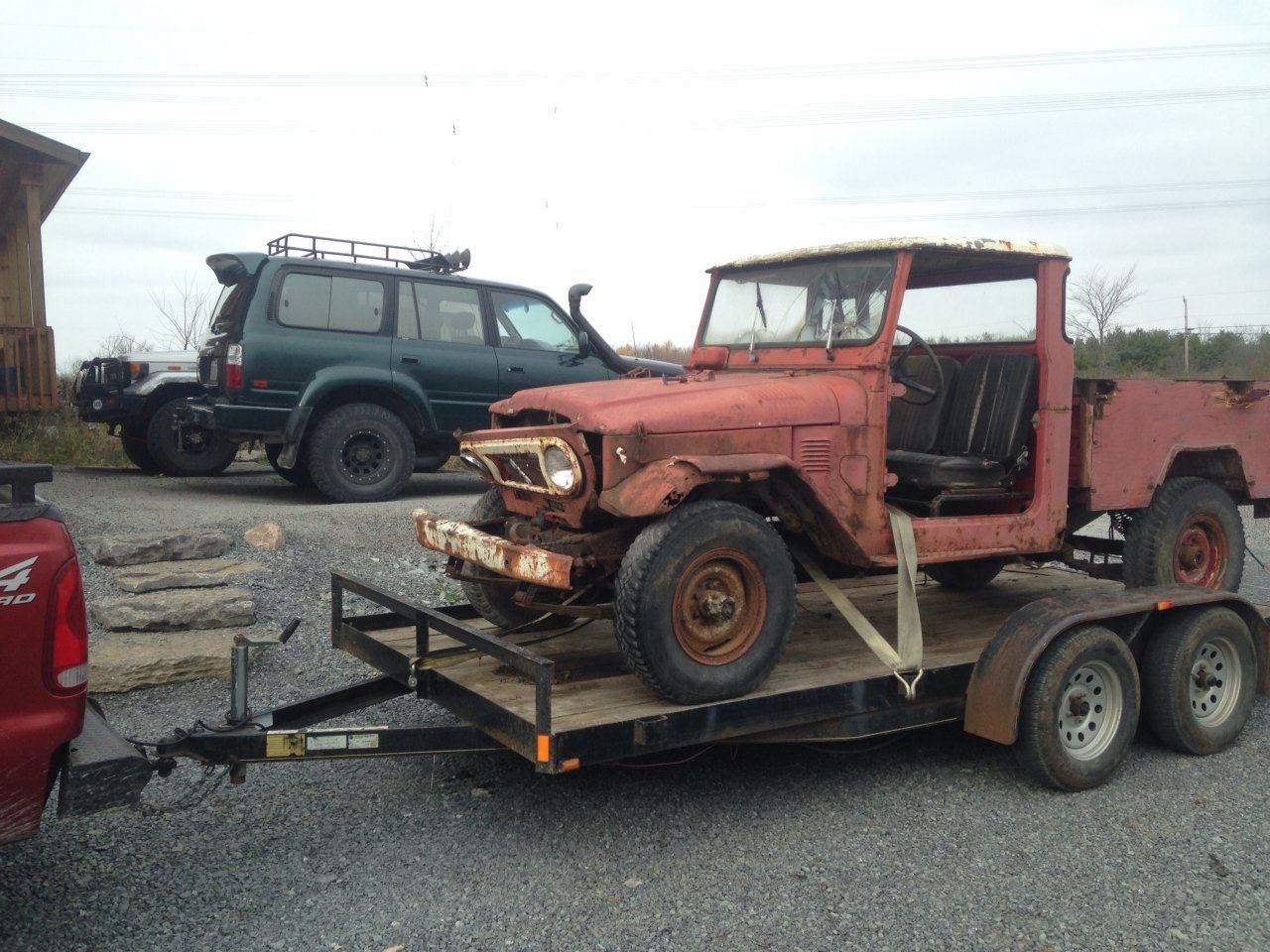

Straight traded the old 2F/trans/xfer for this puppy!!!
(Needs a LOT of work, and needs a 3B dropped in it, which I just happen to have another one of!)
January 1978 FJ45LP
Nice
Is that a cdn spec truck? Didn't realize they made them that late
Yep, from what I can tell, it's CDN. FJ45LPKK. I believe the second K is Canada. (?)
Though all the Canadian truck were semi float not full floaters cool

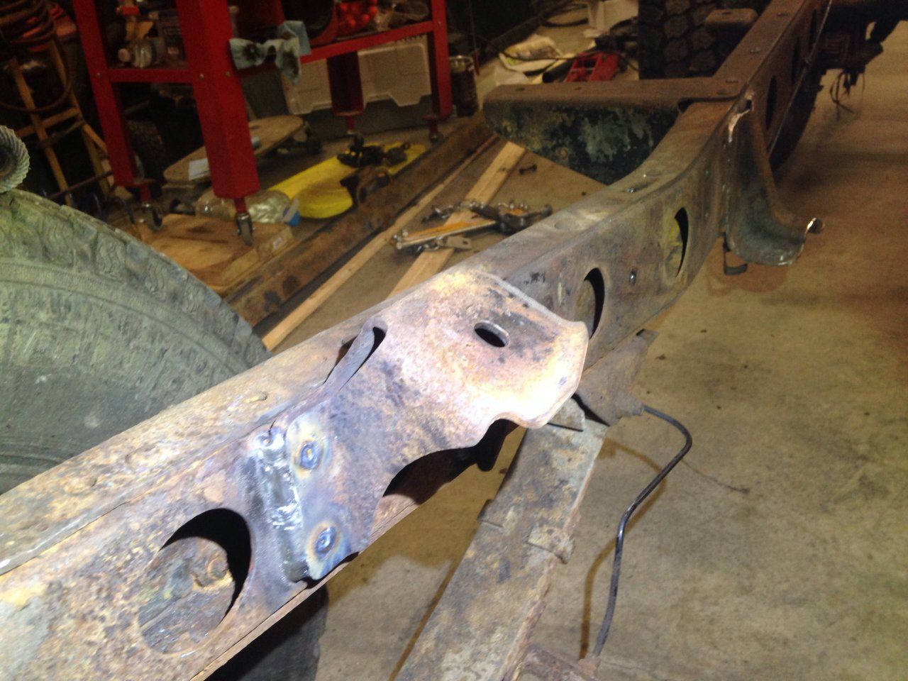

So, I got a new tranny mount from Rock Auto, I figure that at 1/4 the price I can change it after a few years... $33 compared with $120 seems worth it. Mounted that and then set the final location for on for the tranny cross member mounts. Figure it would be best to do that with a new mount rather than the old one that had fallen apart.

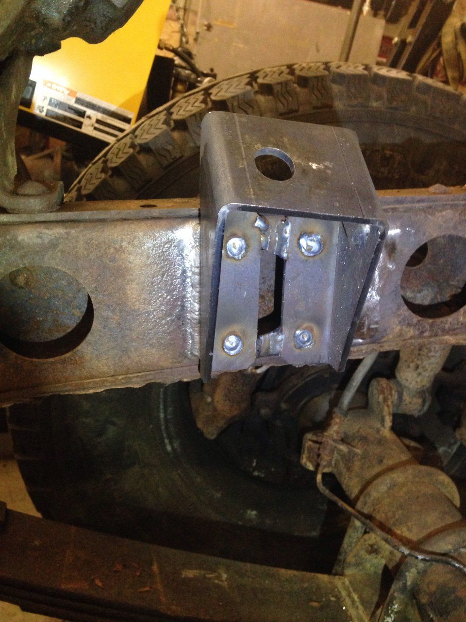

Got everything lined up, tacked in place then pulled the engine tranny out to weld it up.
Then welded the engine mounts to the frame.
So, all the bracket welding is now done...

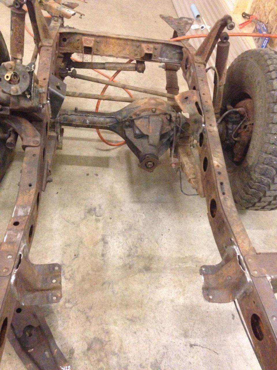

Thanks kling-on, a few more pics of the progress to come later tonight. Got it torn right down to the frame, got my busted fender bolts out, flipped it over and got bump stop pads off (that's all that was left of them!)
