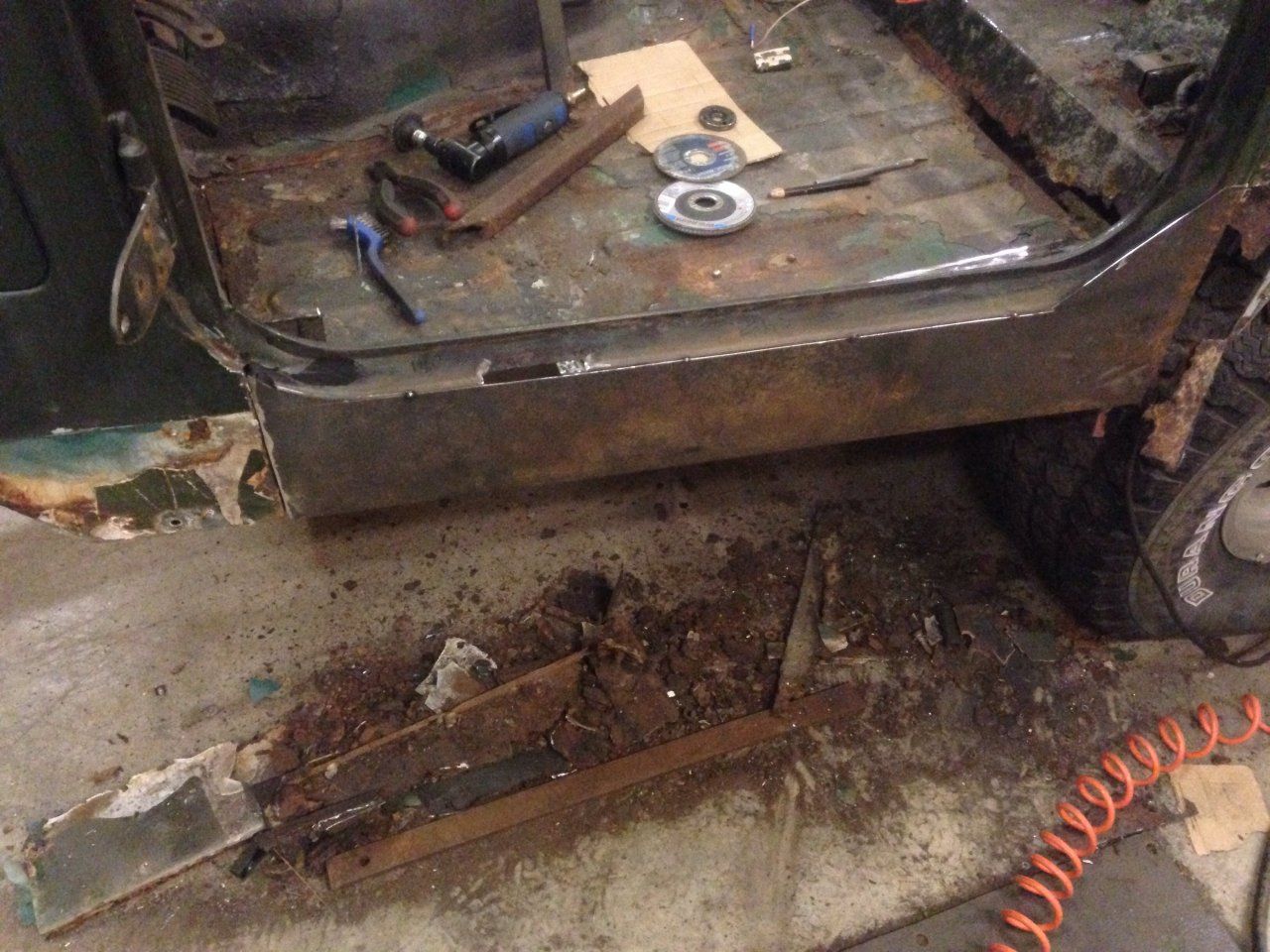

A quick zip with the grinder and I had most of it off (well, what didn't fall off on its own). Chopped the outer edge of the floor off, as well as the inside edge below the door sill down to where the floor used to be. Undid the bolt that holds it to the front and then had a nice clean blank place to start!

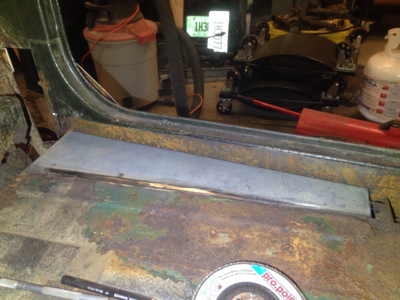

Cut a fresh panel from my sheet, welded a flange to the front and temporarily clamped it in place at the front, with a few tacks to hold it in line - so I could line up the new floor section for the back, to be able to attach the floor to the outer skin. (Once everything is fit the outer skin will come off so I can paint the inside, then weld the outer skin back on)
Still need to shape the back radius and weld on the rear flange, and lower flange.
Cut and fit the floor section, floor flanges down to match what was there before. Upper inner piece will flange in and land on top of the floor. Still need to put some patches in the mid section of the floor, and the front.
Floor from above. Back lip of the floor is going to be replaced further in as a separate piece, as is the lower portion of the main beam.... But that's another day...
Quite the pile of "OEM" steel on the floor... Any bidders? Think I might put it on eBay with the OEM rear sill, and the contents of my shop vac when I'm all done.

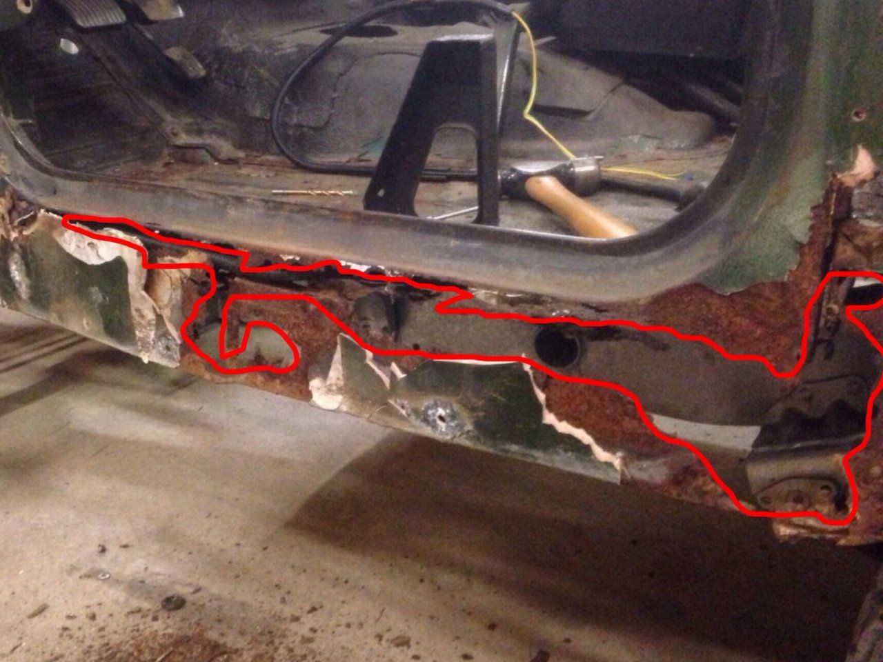

Just noticed that in the pic above it's hard to tell the difference between the rocker and the frame in the background.... Just to clarify, the red circled below is what was completely missing from the rocker, most of the rest was just made of/held together with bondo!

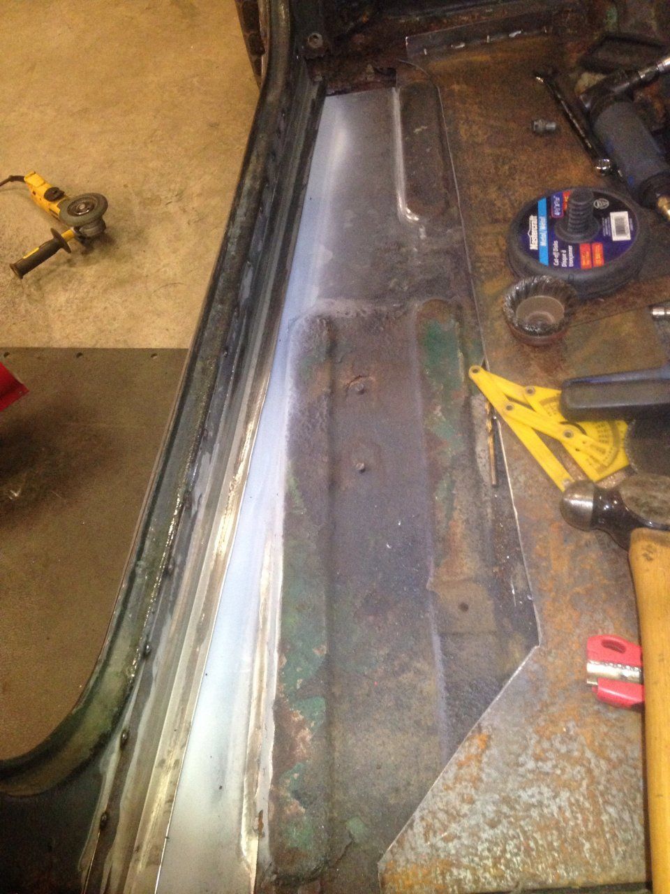

Decided to take a bigger chunk out of the drivers side floor in the front outer side. Still needs the very front taken out, but I now have enough to finish the inner sill - which is what I was originally hoping to get done today.. New meat is from the C-clamp forward, from the sill, and in as far as the first "hump". Left about an inch at the front as I am going to run a new piece across the entire front. I drilled out the spot welds to the channel below (still in perfectly acceptable shape?) and welded the new patch back down to it.
The angle clamped to the floor is the start of the inner sill - need to weld some meat to it to make it taller to reach the top. Can also see it from the outside, as I have now removed the outer sill I temporarily attached so I could get the floor flange in the right location... Clamp is just holding the angle to the floor, at the support channel.
From the inside:

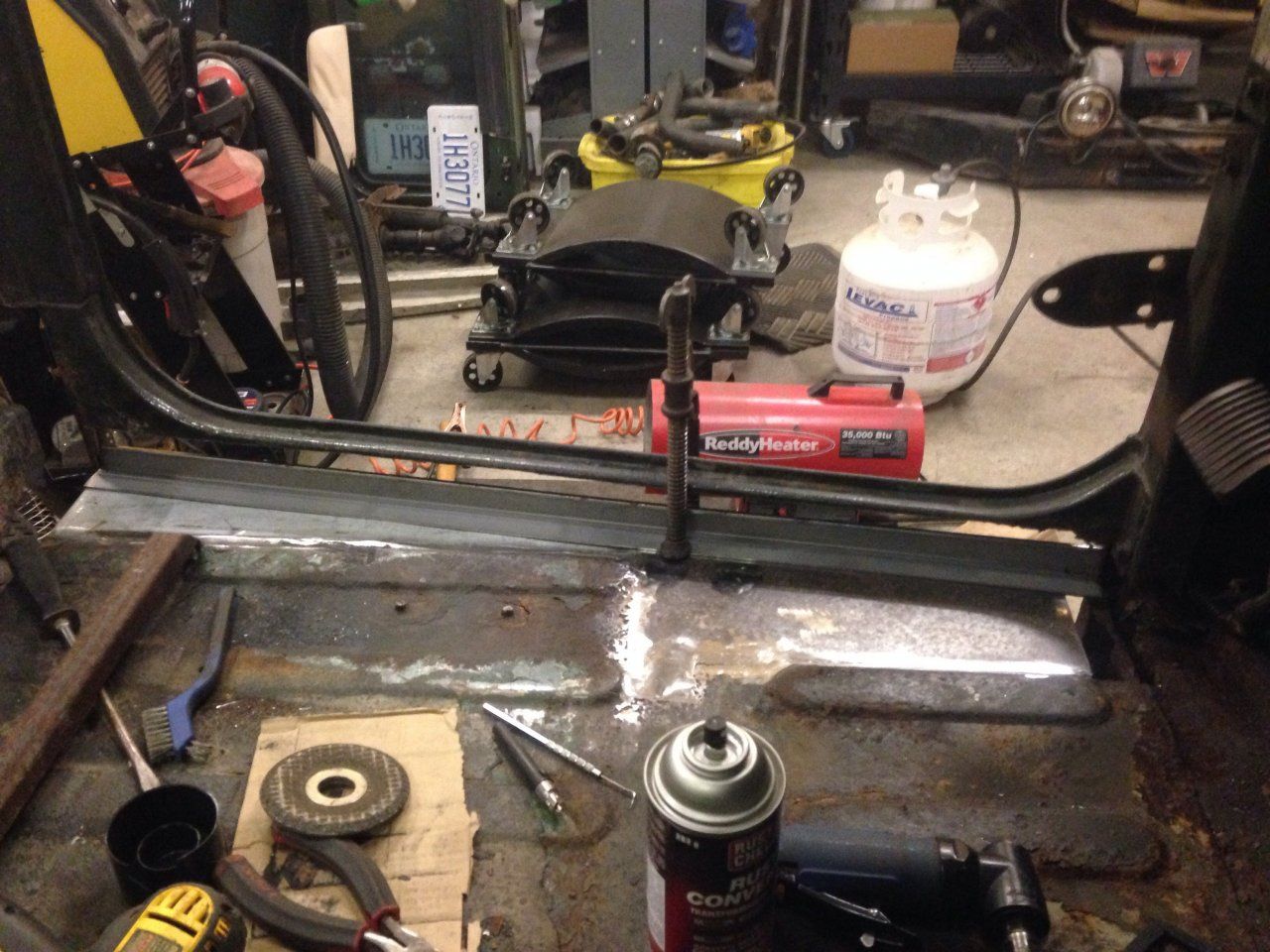

Got an hour in tonight and managed to fab up a quick inside sill to floor section. It's actually made up of two parts stitched together, an angle and a strip of sheet to make up the height. I have a bunch if this angle stock but it has a rolled lip on one edge, so I had to trim it off prior to fitting the finished part.
Hit the bottom of the angle and the floor with some Eastwood self etching weld through primer so it's not a rust sandwich in 6 months. Got the part in place and tacked it along the top edge for now. Hopefully will get it welded up, and spot welded to the floor tomorrow
Again, hard to get a pic showing it properly.... But here are a few crappy pics....

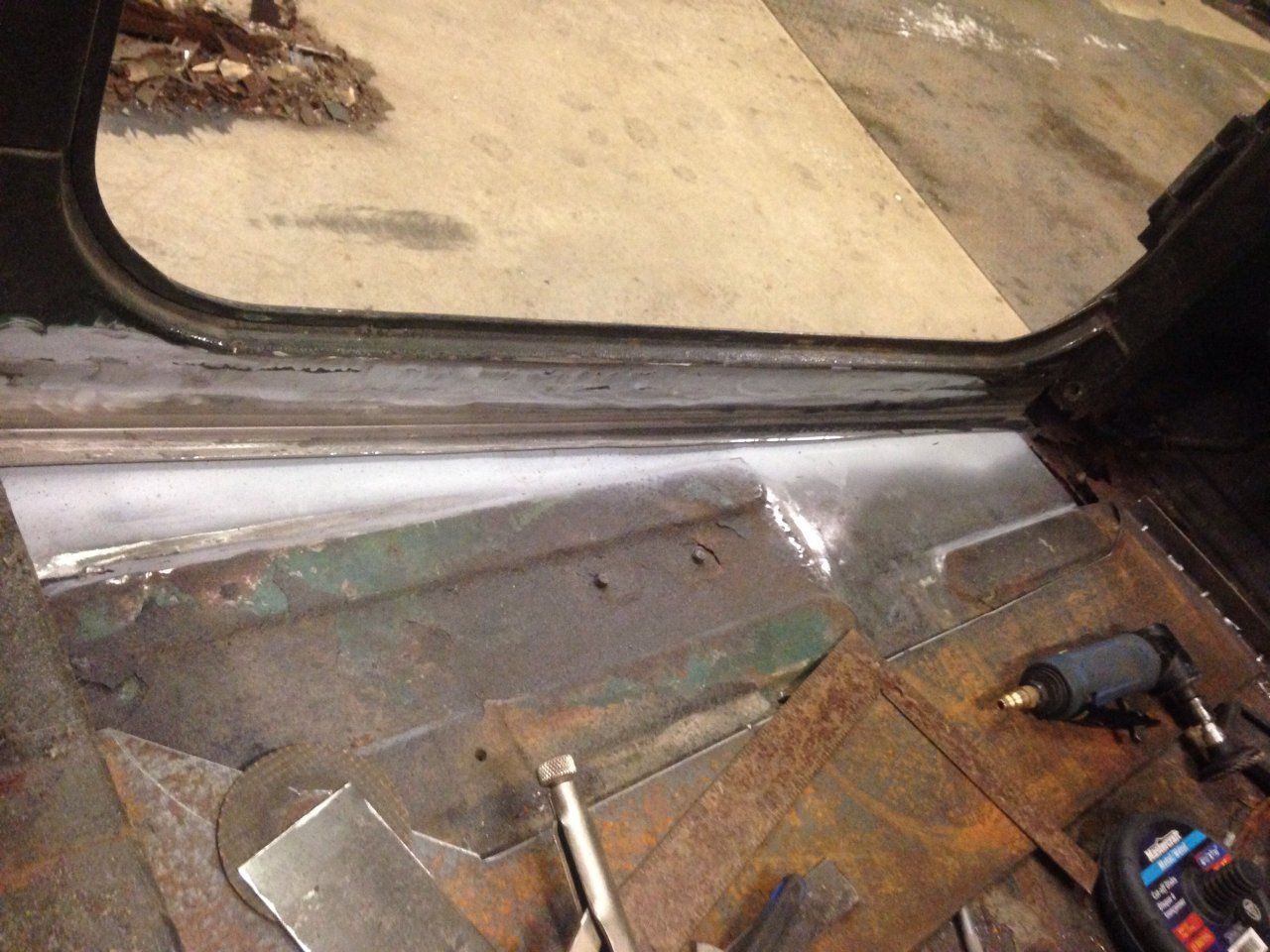

Well another day goes by with little progress, but progress none the less. Managed to get most of the inner sill welded up and buffed down - need to go over a few spots a little more but running out of decent flap discs.
Next step is to drill a few spots and tack it to the floor pan, then coat the inside of it all with paint. Pop a few "OEM" located access holes for the wiring in, and then weld the outer panel in place.
Starting to look like a floor again!
