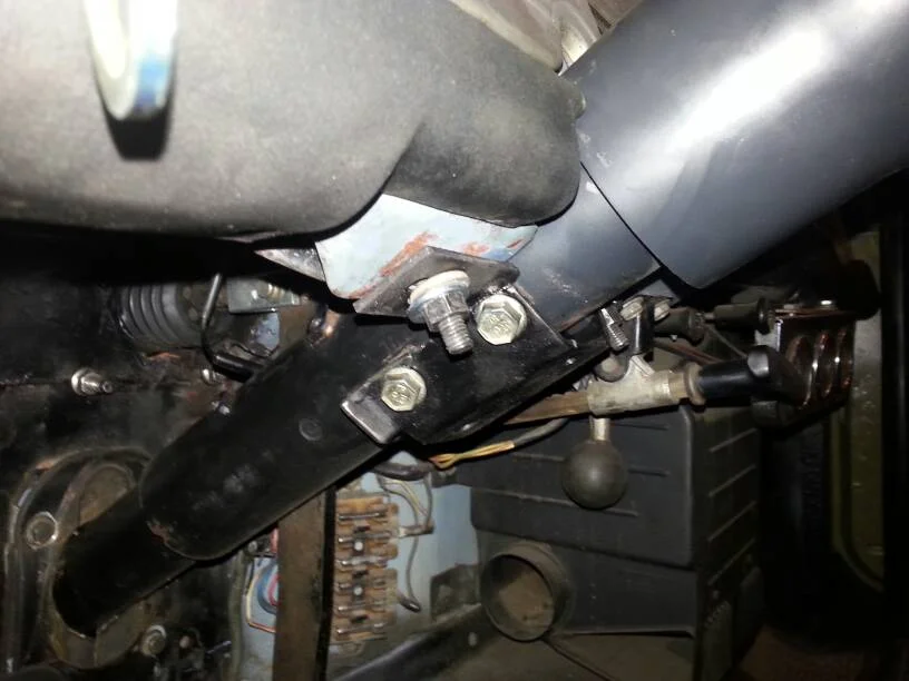

I put in a Chevy S10 tilt today from an 85 pickup. Seven bolts and thirty minutes to get it out and a couple hours to get it installed enough to get the truck back in my garage. I'll fab a proper bolt in mount for it tomorrow. I also need to figure out why I'm stuck in 4wd when everything was working fine yesterday.

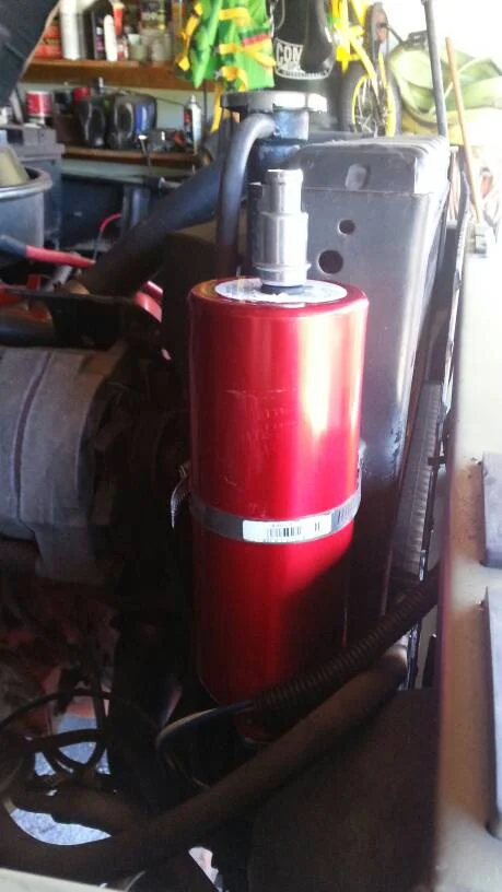

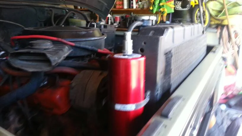

Some quick pirate style cheap ass catch cans in progress.

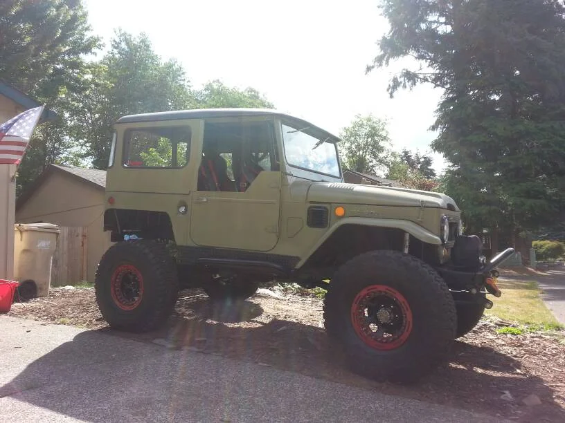

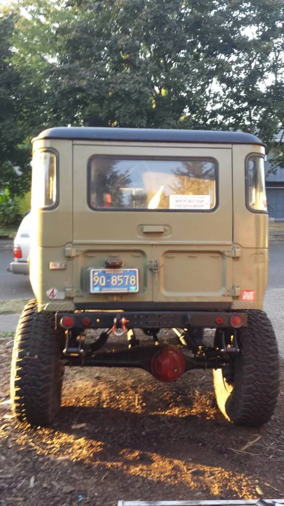

I finished up the top over the last couple of days. 6 coats of satin black xo rust paint followed by 8 coats of black plastidip and 4 coats of the plastidip glossifier.
I did the liner with an indoor/outdoor carpet in a dark grey attaching with a 3m industrial two part glue.
I didn't bolt the top in in hopes of being able to wheel the next weekend and cruisin the woods topless. If needed I can bolt it right in though.

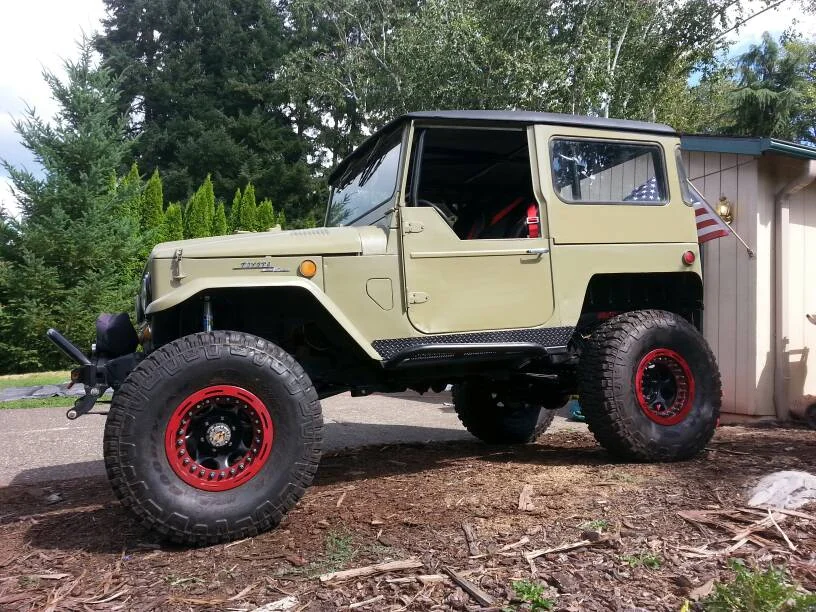

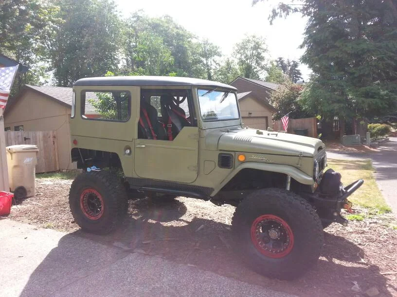

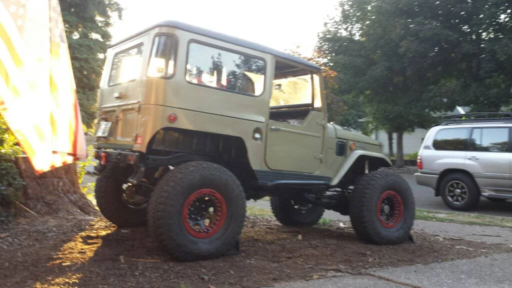

The top turned out awesome! I also like how your front fenders turned out. I don't really like how u did the comp cut in the back though. The front fenders look well thought out and really preserve the fj40 look, but the back fenders dont quite look right. Just stating what I see, not trying to be a jerk. Comp cuts are tough to make look right. I like the one here in post #8: https://forum.ih8mud.com/threads/need-comp-cut-and-wb-stretch-pics.764411/

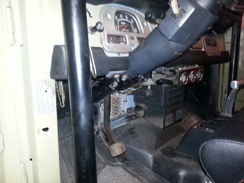

At the beginning of the run I had to remove the brake pedal and adjust the booster mount as the brakes were dragging, but most of the rest of the day went pretty well. The reason I say most is that mid trail late in the day, the truck would keep leaning out and dying. At first I thought perhaps the angle was starving it, but when I got it level again it would do the same. We got the rig back to the bottom of the trail and tested to see if fuel was getting to the carb (it was), but I noticed the fuel filter on the Qjet was clogged pretty bad. Now, there was maybe ten hours on this filter so I think I need to drain the tank from the bottom and filter the fuel. The bigger issue though was that as I was trying to reinstall the filter housing, the threads stripped (a common Qjet issue) and I was unable to restart the truck. My friend graciously towed me back to my trailer and I was able to get it home without issue.
