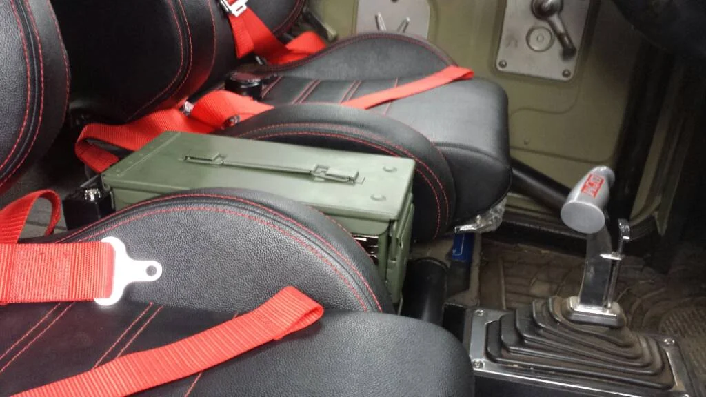

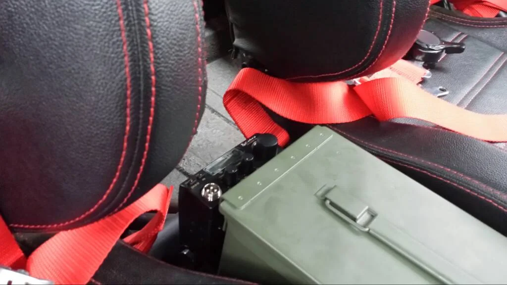

Added an ammo can center console and used it to mount the cb. Out of the way but still easily accessible.
