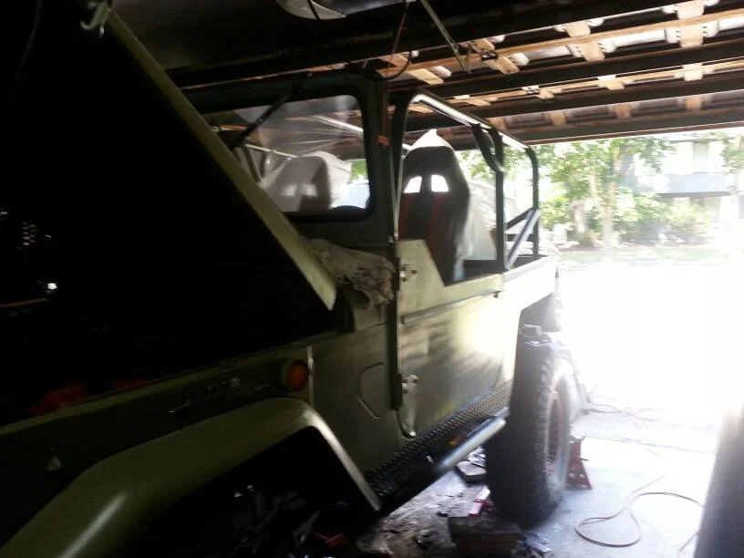

I had to notch the crossmember I made to accommodate the new driveshaft angle, so once it's painted up (had to let it cool) I'll take some pics.

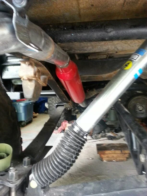

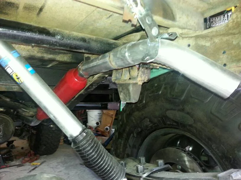

I finished installing the shocks along with the antiwrap bar yesterday. The exhaust you see in the pic is being replaced by dual 24" cherry bombs.

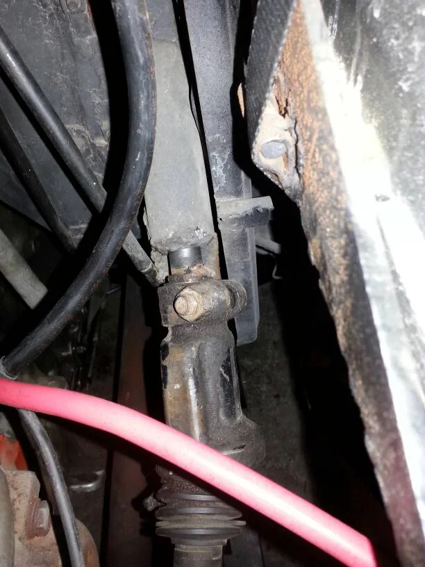

Installed the front shaft today and was finishing the steering stuff when I found that the steering wheel wouldn't turn the tires.....
I discovered that when the original Saginaw conversion was done, that like a lot of the non existent conversion crap in the 70's, that things were pretty redneck to say the least. The tiny tack weld connecting the Toyota steering to the saginaw stuff had broken when trying to turn the bigger tires. Thank god I found this now than when I was bombing some fire road with the kids.

I got the exhaust installed today. Dual 24" cherry bombs with tips turning down just at the rear shackle hangers. The sound is amazing! Not too loud, but definitely that old school hot rod rumble.
Pics to come tomorrow.
