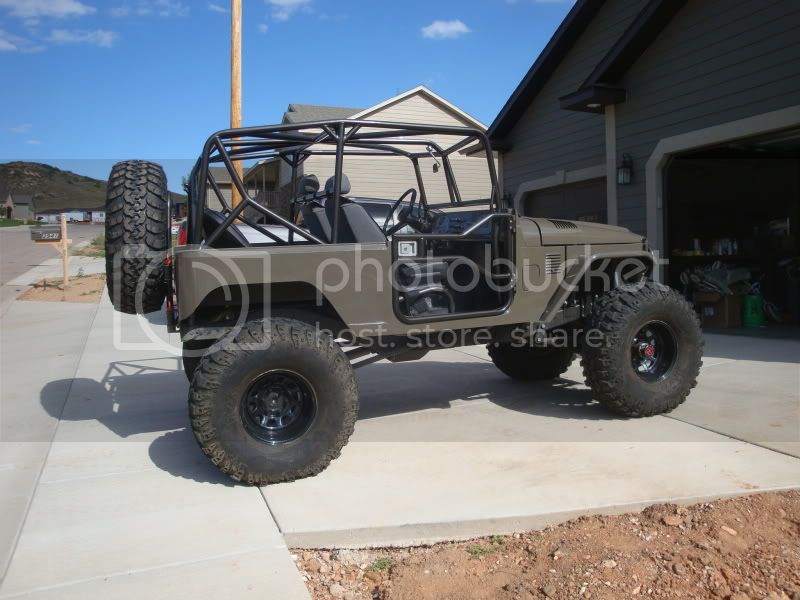

If you dont want to shorten the 80 frame Id start by test fitting the fourty tub onto it and centering the rear wheel well over the rear wheel. You could then move it forward bit by bit till you get what youre after. I know that after pushing my front axle forward 5" and the rear back 3" Im only at 98" (stock was 90") for wb so that 112" sounds like a lot. Youre gonna end up with the front axle sitting centered w the bezel and the rear sticking out way beyond the rear wheel well. May have to delete the wheel well all together and just have a small cut out at the back of the tub for the front of the wheel?
Just for reference heres a pic of mine. Not a huge fan of comp cuts by any means btw.
Dont have a great profile shot but at least youll get an idea. 14 more inches would be interesting to say the least..... What about stretching the cargo area by adding inches between the rear door pillar and wheel well? With the factory length top youd end up with an avalanche lookin mini box..
