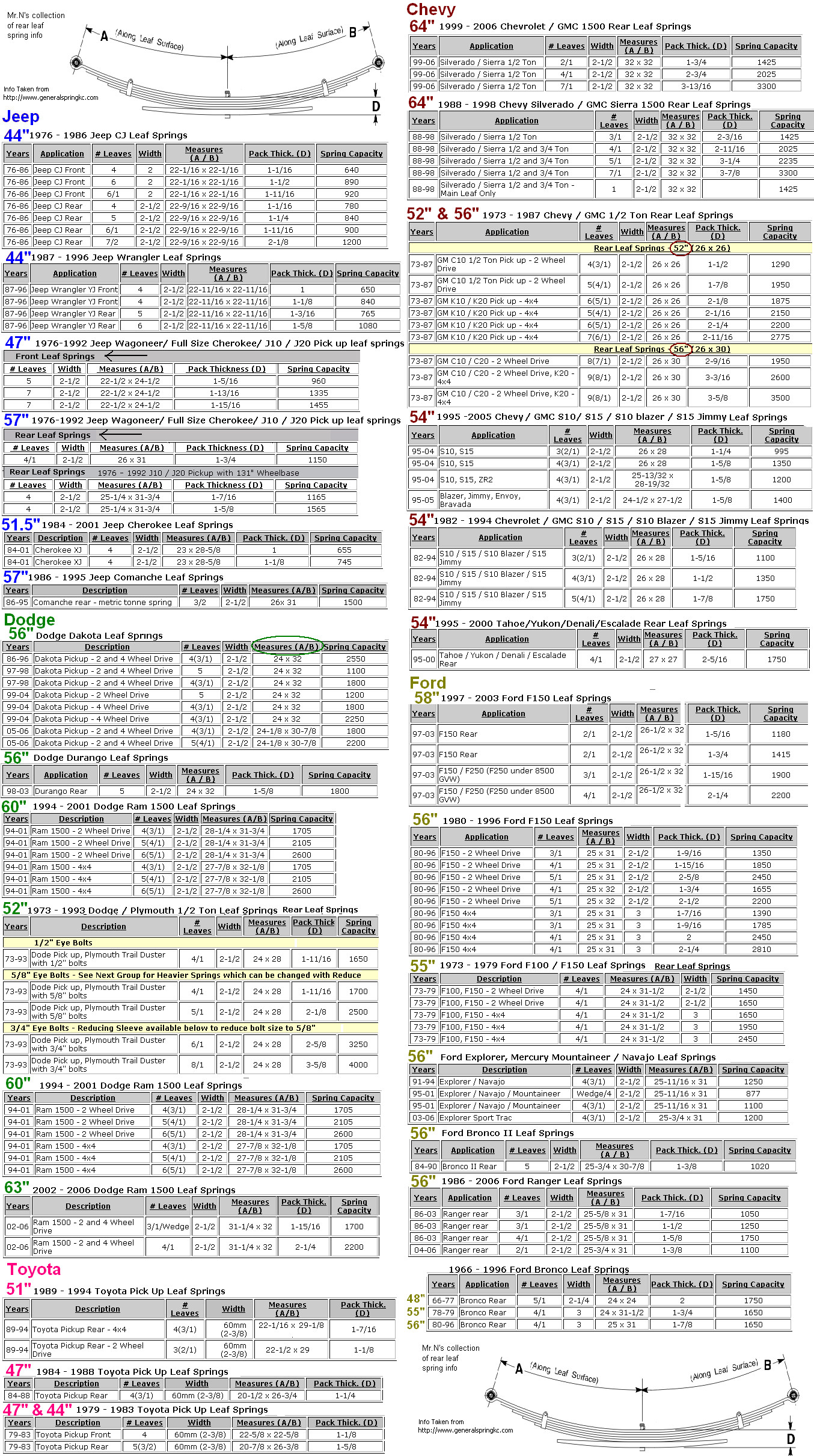

why not just ue the centered 52" chevies? they were centered from the factory. There are multiple options for centered leaf springs tho. (kinda after the point but)
This is an awesome reference right here. Thanks Mace :cheers:
I swapped in the chevy springs today and it looks like there'll be a huge difference in ride quality. They still have a good flex, but are firmer in action and more robust in construction than the Dakota leafs. I'll build the front springs tomorrow and take some pics.

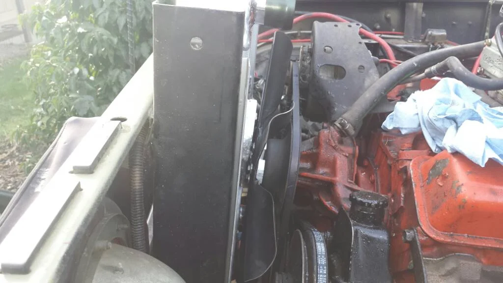

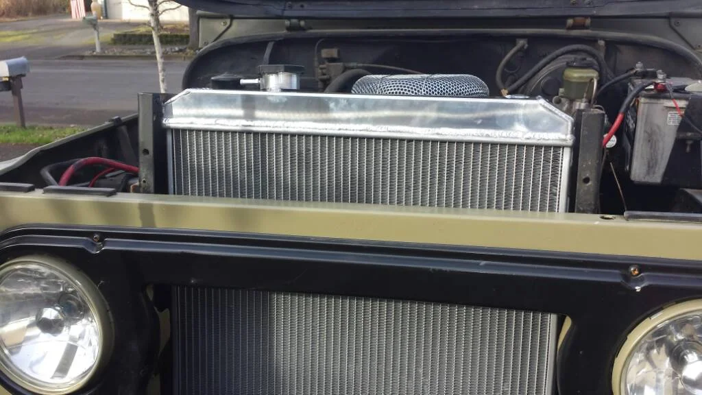

I also got the radiator pulled in preparation for the new one. It looks like I'll be keeping the waterpump that is in place, but use a flexilite glass/nylon fan in place of the steel oem piece. I'm also going to find a way to stiffen the upper portion of the radiator to limit radiator flex.
I didn't look back, al or brass radiator?
I'm curious why you need to strengthen the radiator?
Be careful, too rigid and it'll leak over time

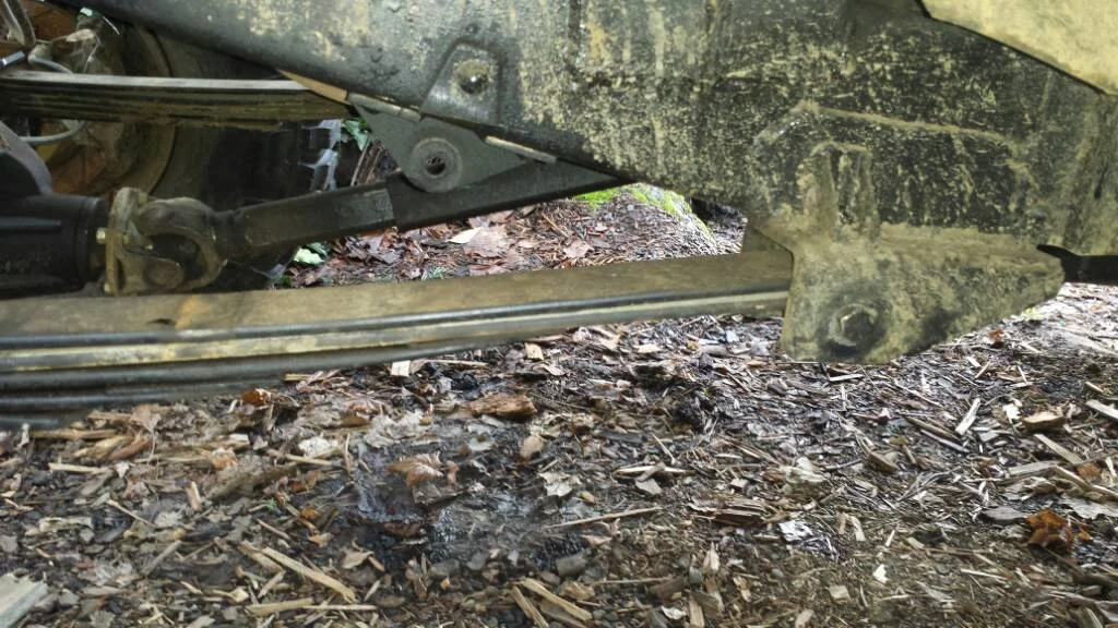

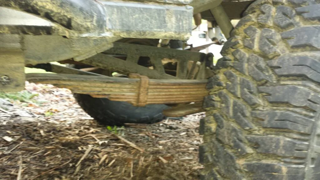

I finished swapping out springs today. It looks like a possible 1/2 inch increase in ride height, but things need to settle before I know for sure.
The body is definitely firmer in regards to spring rate which was the intended effect. I'll know for sure after the new radiator arrives and I have a chance to drive around a bit.
To recap; I added one full leaf with mil wraps cut off into each front leaf pack, and swapped in the re-centered 56" chevy springs in the rear.

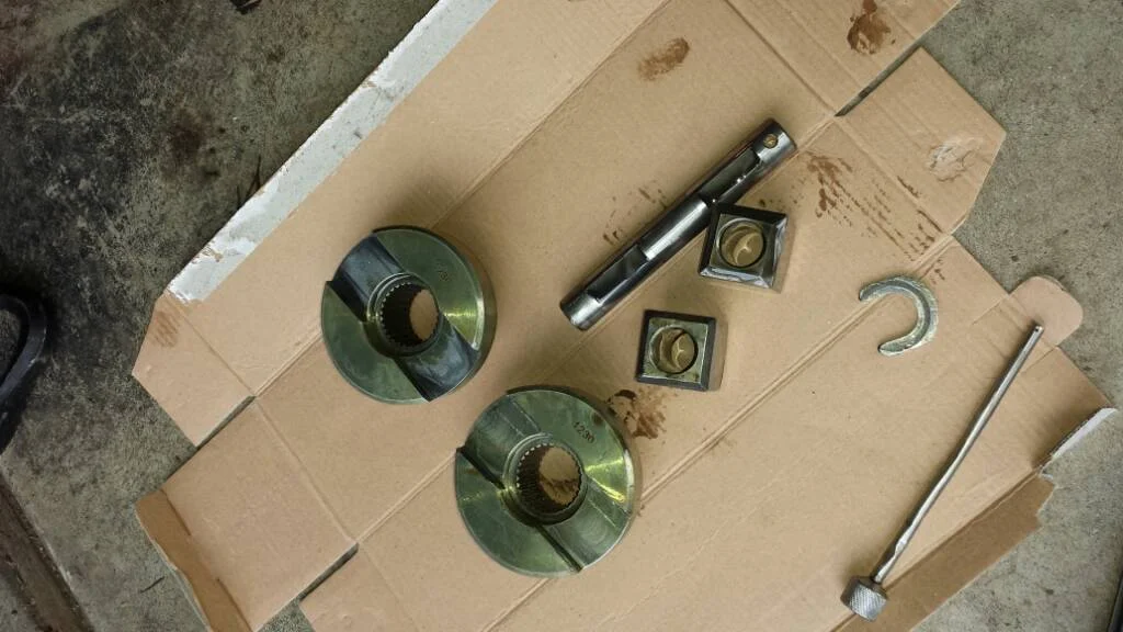

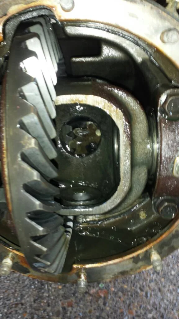

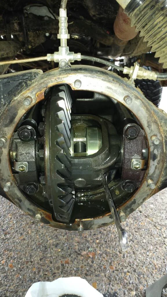

One final piece of my chapter in Oliver's book is the replacement of the spool for a spartan locker. The new owner is deployed and part of our agreement was my installing the new part. I'm not doing a full write up because these things are simple, but I am including photos.
