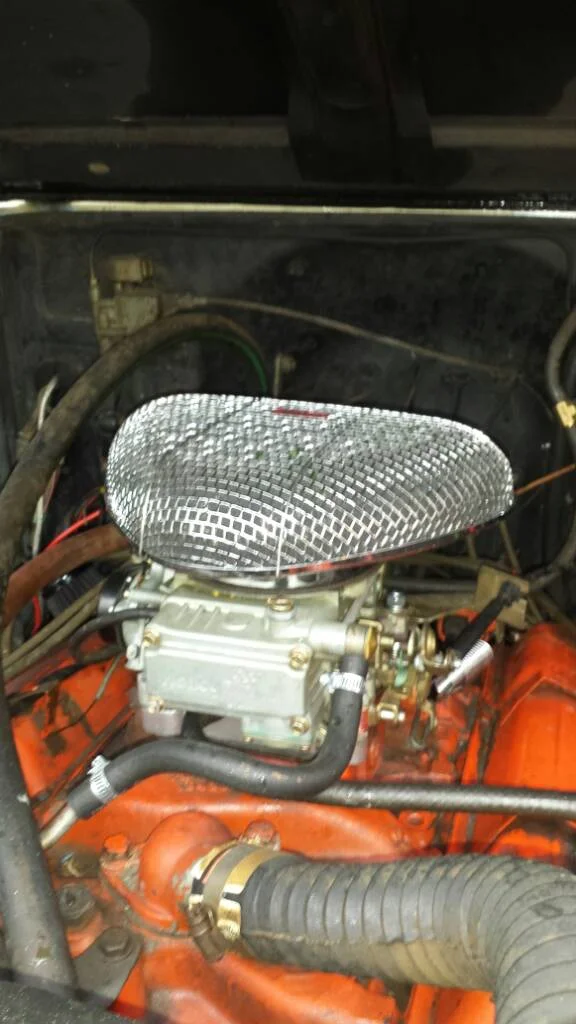

Oh, I added a new 2nd gen Holley truck avenger 670 and then had it tuned at The Carburetor Shop (literally the shop's name) here locally. They dinked around with it so the floats and everything were properly adjusted and the difference between having the new carb vs the old Q-jet is unreal.
I could never get the Q-jet adjusted properly and the truck was just a dog with it on. It's now an entirely different machine and I can even roast the 37's on dry concrete.
