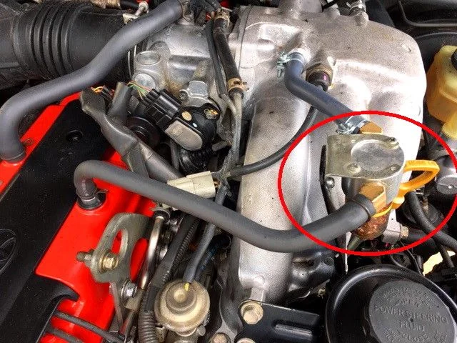

I had one installed on the firewall
Thinking about mounting one of the units with the clear bowls (Jegs, Kobalt, etc) to the firewall near the brake booster. Anyone done this?
I had one, it was on the firewall on the exhaust side. for me it was a sign of a bigger issue and after rebuilding the motor I took it off... Even before the rebuild, it didn't capture much oil..

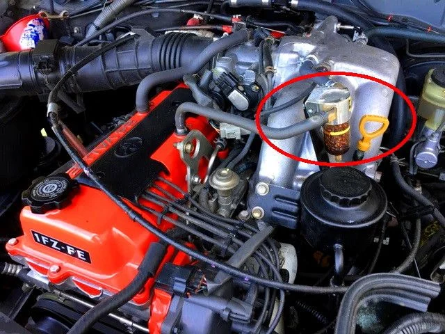

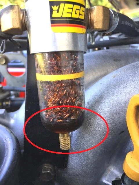

I put one on mine and was surprised to see how much oil was present in the first 150 miles or so.

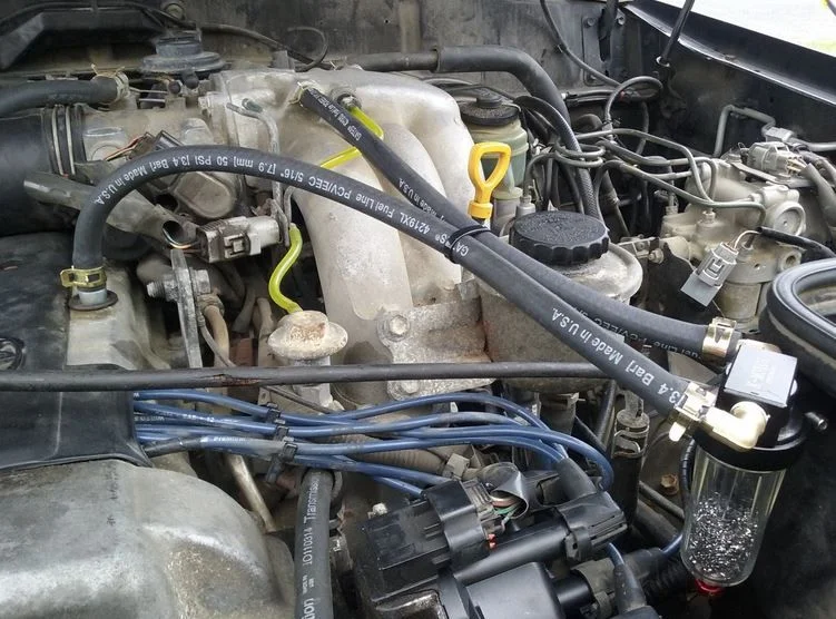

That's the model I'm thinking about ordering. What's the purpose of the steel wool? Did it come with it?
The only thing the filler does is add a little more surface area for the splooge to condensate on and fall out of the breather air.
The one pictured looks like a copper pot scrubber (if you use steel wool make sure it doesn't have a cleaning agent on it i.e. like a pot scrubber pad.
Correct. The unit comes with a very fine (too fine looking for me) filter screen, so I removed that and added my own media (had no cleaning agent on it) to allow better flow and increase condensate area.
