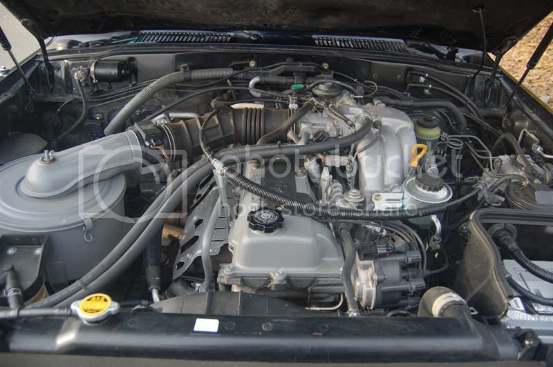

installed a oil seperator on my 80

had it on my mustang, before i ended up putting everything back to stock. it kept a decent amount of oil from recirculating back into the upper plenum. took me about 5 minutes. i used an oil seperator from lowes, and i used two barbed fittings to connect the hoses. i put a new pcv valve in while i was at it.

been on my 80 for about 45 minutes. havent driven it yet. it did collect a boatload from the mustang it was on before.

the oil seperator was 8
the hose was 3
the barbed fittings were 4
and i had the new hose clamps in my toolbox.
total of $15

You basically put the catch can in between the PCV valve and intake manifold. One hose goes from the PCV valve to the CC and the other goes from the CC to the intake port.

The PCV valve throws a lot of oil into the intake manifold. This combines with carbon that is drawn in through the EGR valve and builds up on the insides of the manifold. When I was doing my head gasket there was about 2mm of gunk on the runners.
Adding to my never ending 80 list.:rolleyes::D 93yotasr5, did you secure the separator in any way or is it just "hanging" there?:)
i zip tied the hose on the pcv side to the lift hook. thats all. its not going anywhere.
