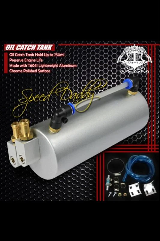

This is the one I bought but haven't had the time to install yet.
$17 delivered, site window/tube, metal, drain valve, install hose included and a easy mount. You can also order in different colors from same seller.
http://item.mobileweb.ebay.com/viewitem?itemId=190626546819
Side shot shown but you get the idea. Brass inlet and outlet go to the top. Lol.
Have you installed it? If so any pictures?
I just bought one too but now some what regretting because it's bigger than u thought. Good thing is I won't have to drain it for years.
You don't wanna let it get anywhere near full :oops:
It would be fine on a level surface, but as soon as you hit a grade the oil will get sucked into the intake :eek:
yeah exactly why I emptied it as soon as I noticed it!!
that could've been bad news bears
