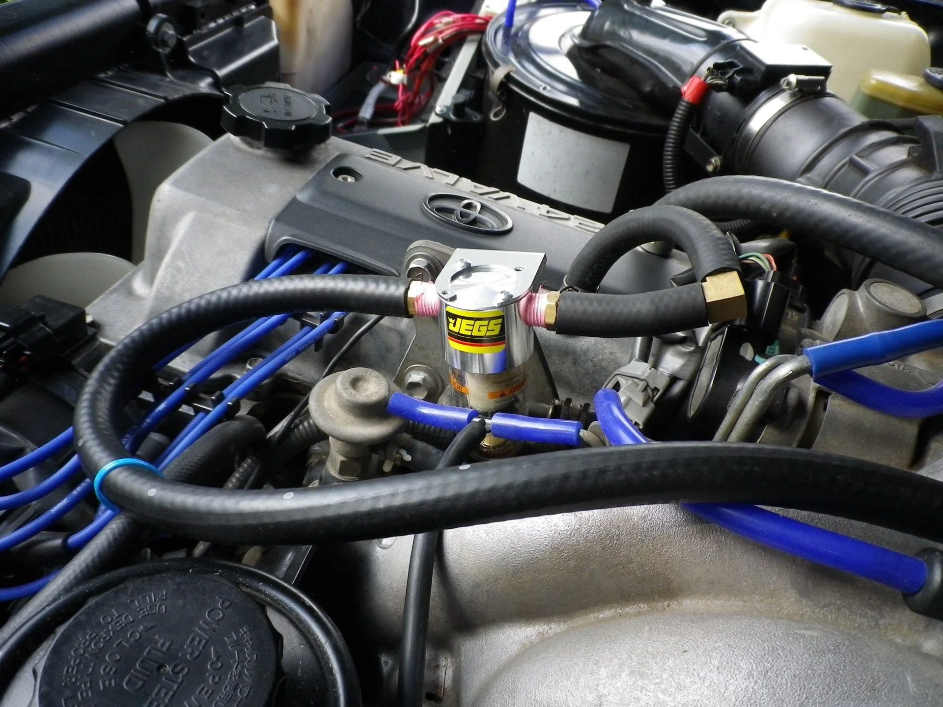

It's very possible. Mine is still holding up great! I empty it about every other week. I use one of the fancy nice aluminum ones on my cobra mainly because of the way it looks under the hood. Doesn't seem to work any better than the cheap one in the cruiser.

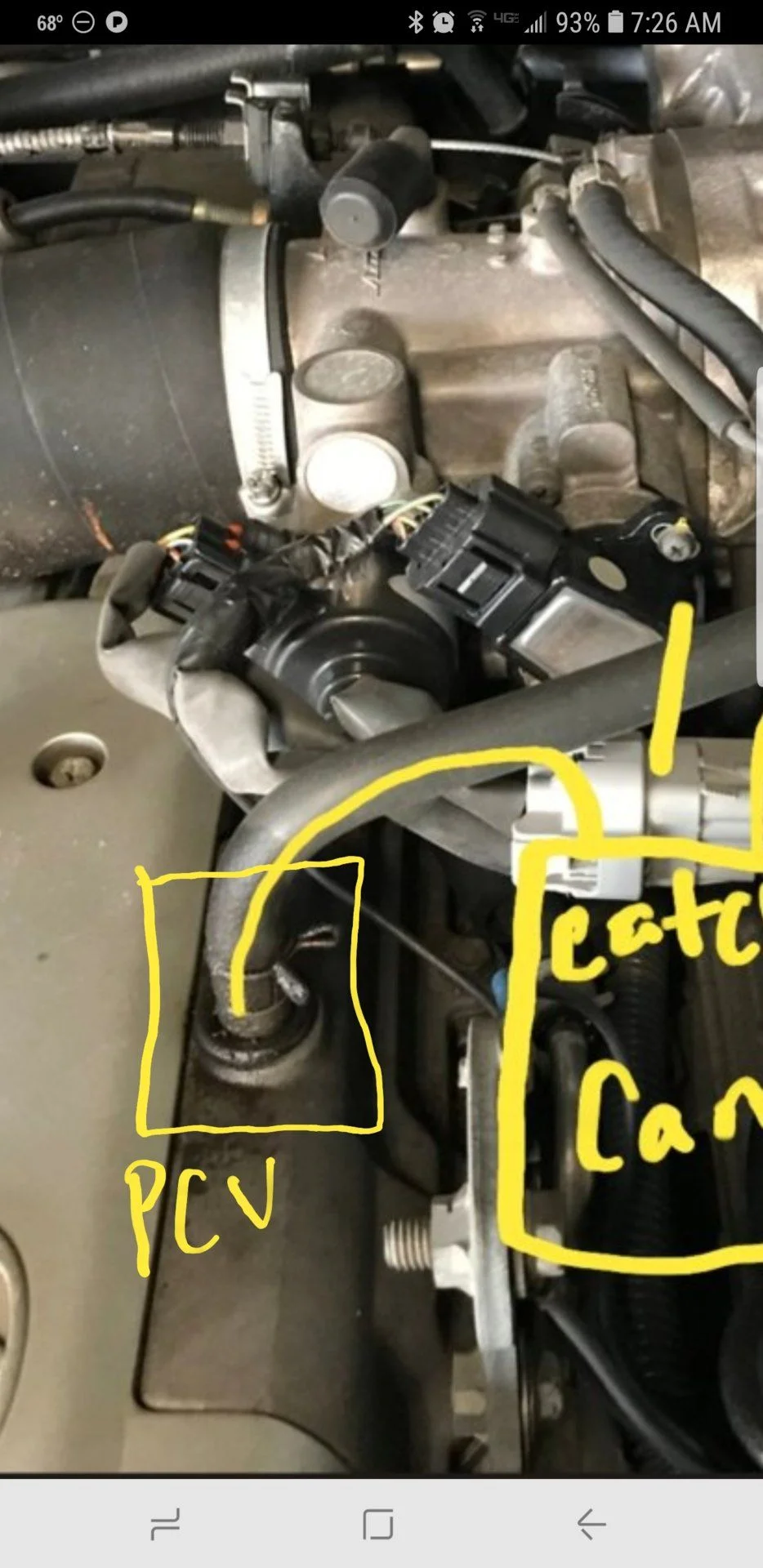

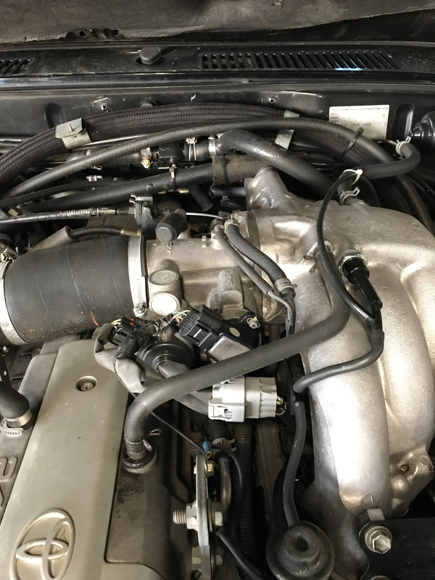

Hi all.

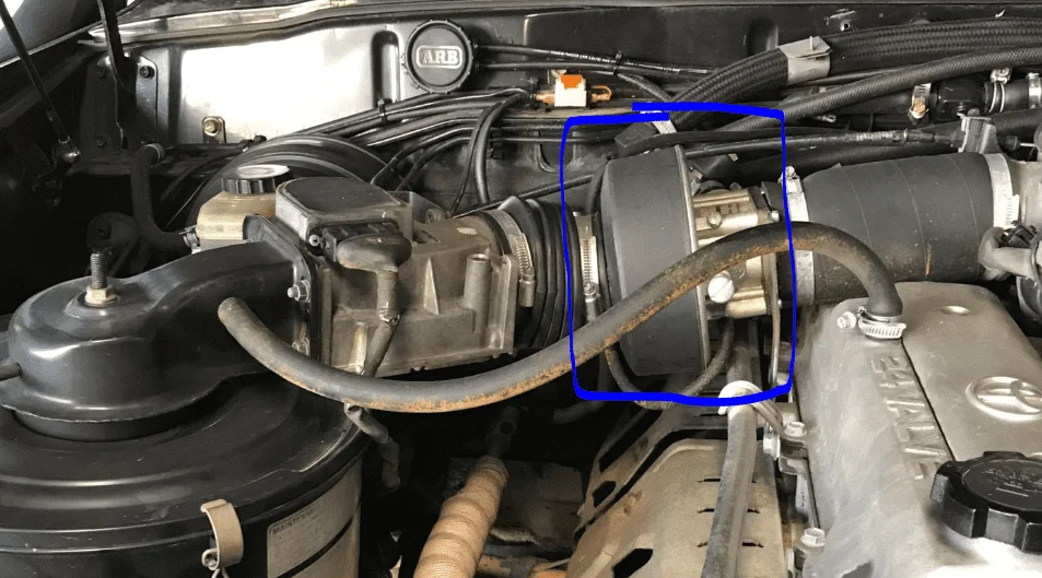

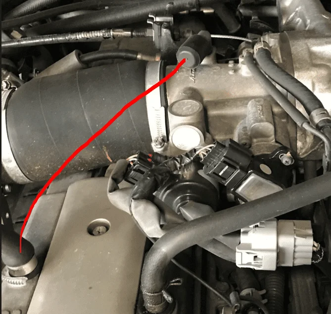

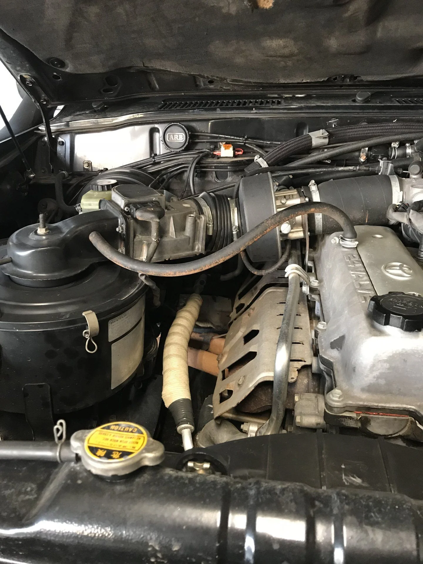

Very new to the landcruiser scene. This is currently how my 1fzfe on gas is setup. I want to run a catch can. Can someone guide me one the best way. And possibly why my current setup is very different to everyone else’s.
Hi all.
Usually these are connected by the red line. Not sure why yours was routed differently.
Also what is the thing in the blue box? Never seen that before.
Yeah don’t understand either why it’s different.
That’s the Gas Mixer. My car is dual fuel. petrol/LPG
I think that's your answer. Did you install the Gas Mixer? Purely speculation, but I'd theorize that running crankcase ventilation into the intake after the "Gas Mixer" somehow screws something up. Again, purely speculation.
Yeah I think so also.
But I still want to run a catch can. So do I just put it inline with the other hose coming from the valve cover. Keep the hose on throttle body blocked?
I was also told to change the cob. But I don’t even know where that is.

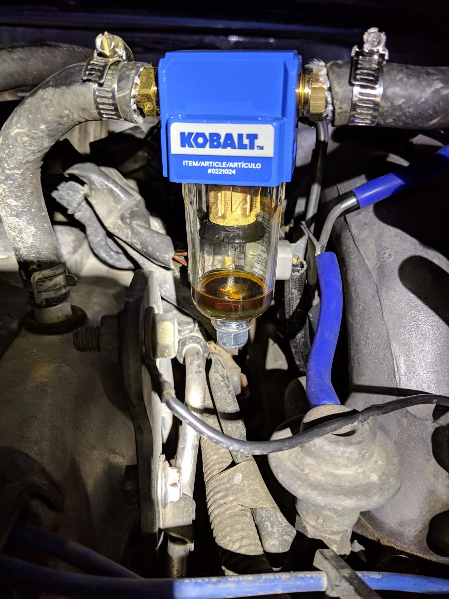

I sliced my new factory hose and reused it. Fits nicely.
Parts I used.
Kobalt 1/4" Mini Air Filter p/n221024 (79686-00169) $12.68
2x 3/8 Bard 1/4" MIP Hose Barb Adapter p/n27970 (48643-07449) $2.44 each
2pack #4 hose clamp p/n/62508 (35119-07404) $1.04
Thanks for the information! It does what it needs to do and I installed it after I cleaned out the upper plenum trying to fix the P0401 and P0402 error code. The ERG port was clogged up with carbon deposit and hopefully this will help.

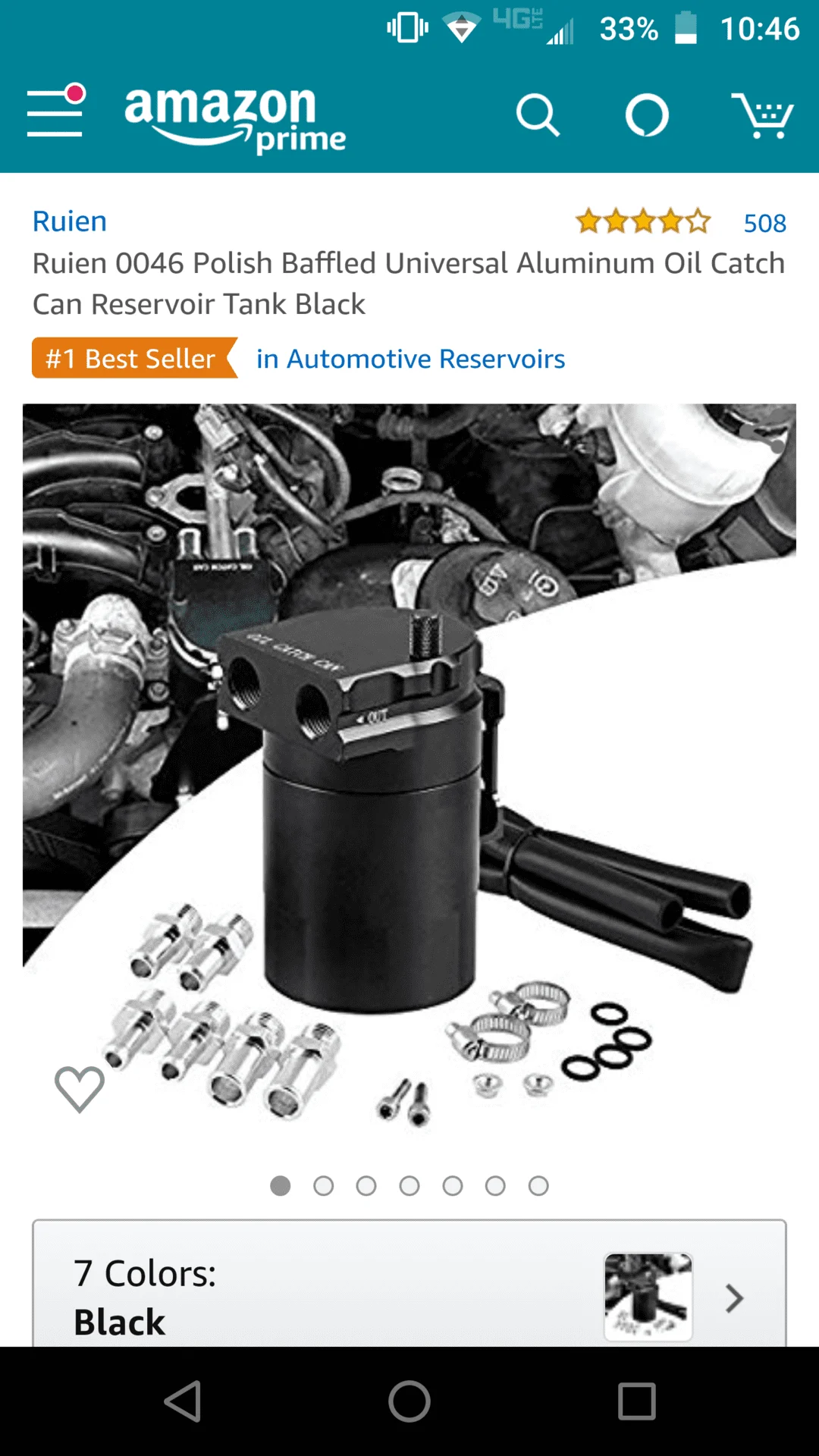

So reading through all this and my question is why are people putting plastic clear air compressor oil separators when there are real catch cans that are baffled available for automotive application?
Happy New year
We all know there are fancy expensive aluminum catch cans out there, but some people use the air compressor versions simply because they cost less then the anodized aluminum types and function about the same (the plastic does deteriorate). The cheapies are easily replaceable at your neighborhood hardware store. I don't run either so :meh:
