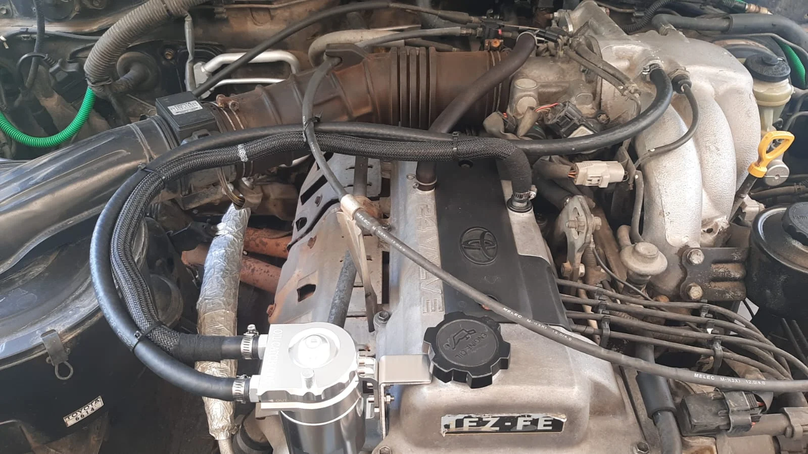

installed a oil seperator on my 80

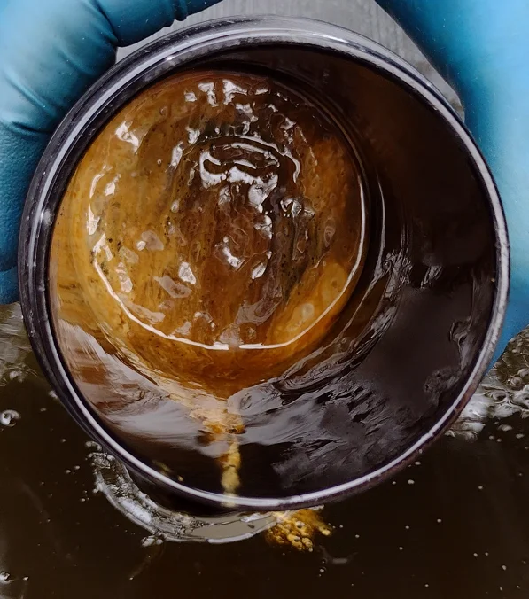

Looks nice! Like The Offspring advised, you gotta keep 'em separated. This was a very worthwhile project for me and bet you're surprised how much oil ends up in the can.

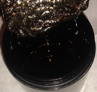

I think the most important variable is the amount and type of filtering material you use inside the can.
Stainless scotch brite netting 1/4 cup every oil change. 52g from 3k mi today, thick bottom layer

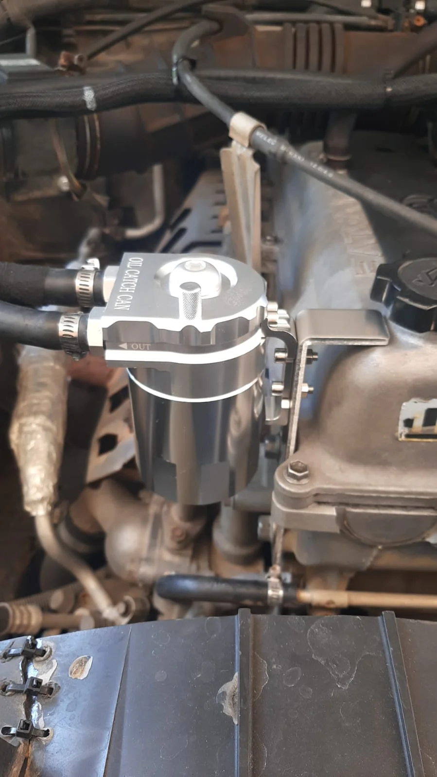

So after 12 years, I finally retired the original oil separator. The plastic was getting brittle,
o-ring was rock solid and the hoses were cracking. Went with an eBay special. It was sold as a unit for a Hellcat. It came with the bracket and fittings. I simply bent and twisted the bracket and it fits perfectly!
