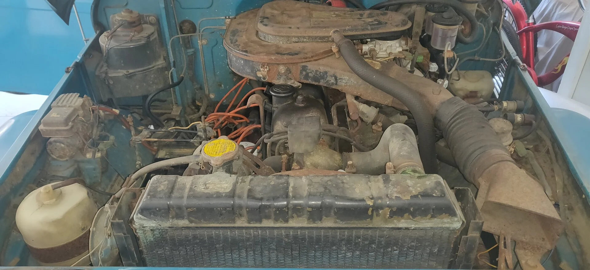

Pull the spark plugs and put a few cc's of Marvel's Mystery oil in each cylinder. I would put a big crescent wrench on the crank pulley nut and turn the motor over by hand 2 full rpms. If every thing goes well, change the oil/filter and use the starter to whirl it over until it shows oil pressure - might take several 30 second grinds. Then put in the plugs. Fully bleed the brake system to change out the old fluid. Same for the clutch. Drain the old gas (an electric fuel transfer pump is very handy for such tasks). Put a few gallons on new hi-test ethanol free in the tank. Pull at least a gallon of fuel threw the line right up to the carb fitting. New fuel/air filter. Drain the radiator/heater hoses - fill with water to flush. Drain and fill with new 50/50 mix. Clean the fuse box with the battery disconnected. Check the gear boxes for oil. If the brakes work you should be ready for a start and a a test drive once it has warmed up and you check for leaks.

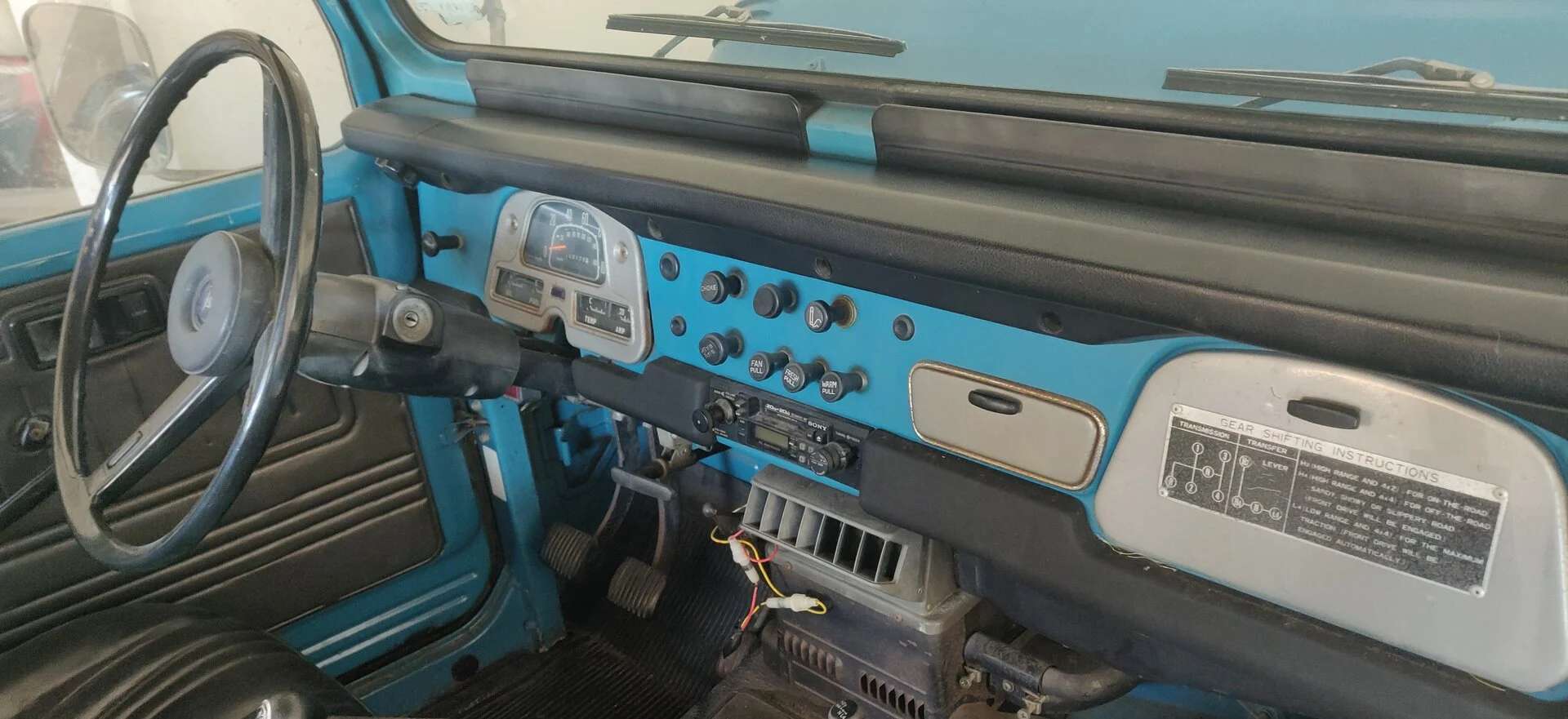

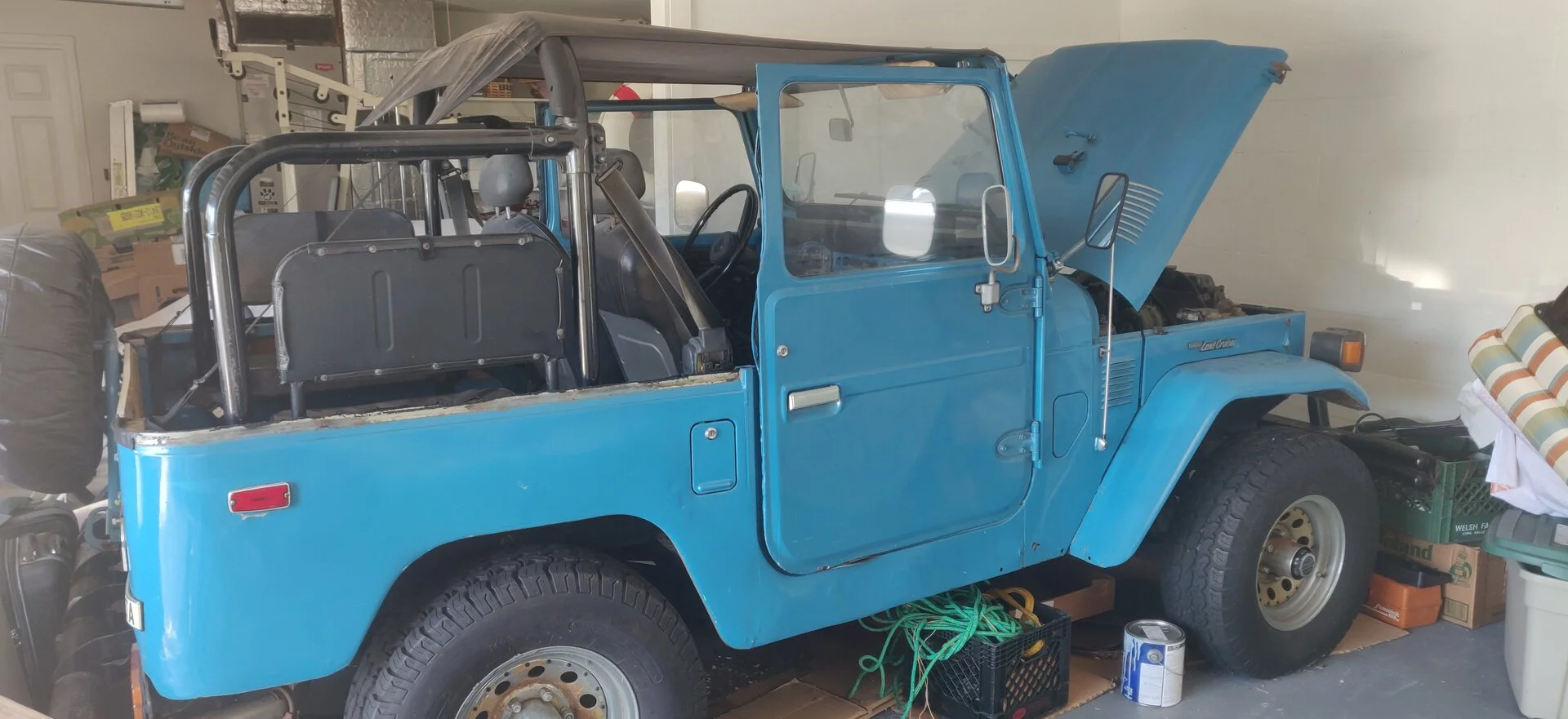

Congratulations…Before you head down the “Restoration Highway” I’d think about the “Spa treatment” first. That looks like a very nice 77 Original 854 paint code LC. I’m going to go out on a limb here and suggest that once you confirm spark, air, fuel and it it starts and stop’s, you just clean/shine/polish it up head to toe. It looks very solid and original. There are several good threads here that can get you started. @wngrog thas some very good threads Ref: “preservation vice restoration” that can get you started. Good luck with this…:popcorn:

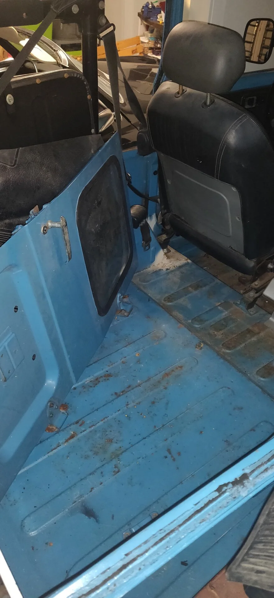

When you have time, post some picks of the front floorboards, rear sill/bumper area and the rear bed.
Do you have the hard top?

Body condition doesn't match the engine condition. Paint is too nice. The seam in the B pillar disappears at the bottom. Bubble at the bottom of the A pillar. Believe using magnetic you will find bondo. Would evaluate the tub and go from there. Thinking about restoring might be opening up a can of worms. Replacement tubs from China don't look too bad. Could be cheaper than repairing the current tub. For now would get it reliable and drive it and do your homework on which direction to take. That could be just work on maintaining what you currently have. You didn't go looking for this cruiser but inherited it. May not want to invest a bunch of money into it.

It looks like a pretty complete 40. You have most of the bits and pieces. I think 1st you need to nurse it back to life. Get it running, driving and stopping, then drive it for while and see if you like it. To get it running I'd approach it similar to @charliemeyer007 's suggestions. Squirt oil in the cylinders and turn the crank by hand 2 full revolutions to make sure it's clear, b4 turning a key. Build oil pressure and setup a separate gas can.

1F and 2F are notoriously known to run hot so pay close attention to temp guage. Replacing the thermostat would not be a bad move while checking the cooling system. The fan clutch is pretty easy to check, when the engine cold the fan clutch will not spin if you hold in place with screwdriver before you start the engine or at least that is how i do it. This will be a good excuse to buy a remote starter. If the engine has met the heat threshold, the clutch will grab and will lock in place to spin the fan.
