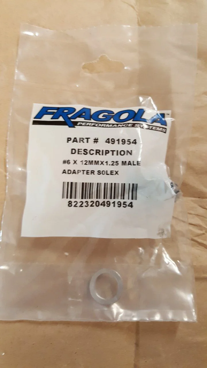

M12x1.25 is thread for top of pump to pressure line. Trouble is, building something that is low profile to clear the access cover....
