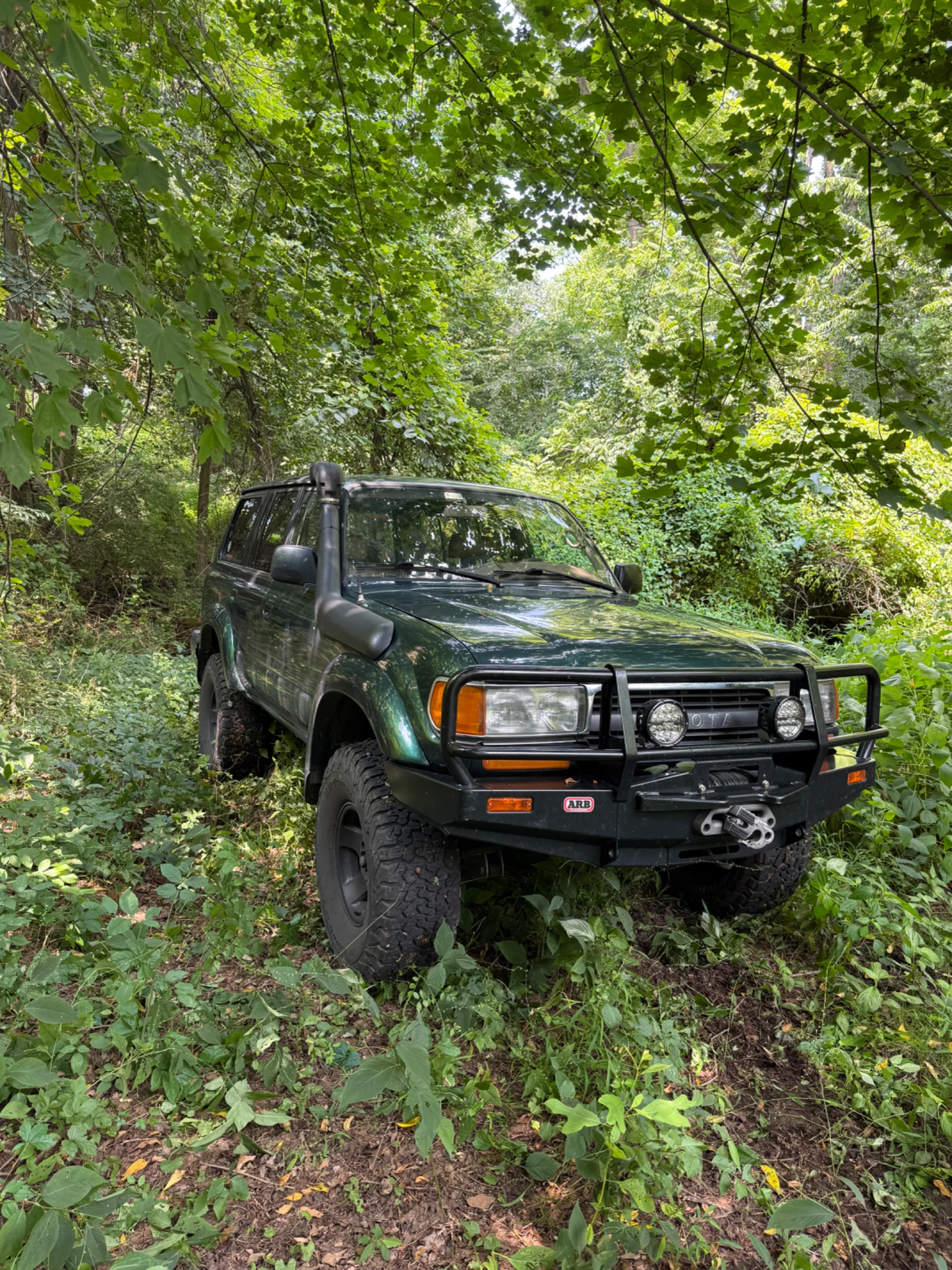

Hello all,
I’ve recently got myself a 94’ FJ80 and I’m looking into potential motor swap ideas.
Everyone I see recommends LS this, 1HD that, but unfortunately, I do not have the budget to go all out on a complete motor and transmission change. (Nor do I want to have to deal with cutting, wiring harnesses, fabrication etc.)
However, I have entertained the idea of buying a lower mileage 1fz and throwing a turbo onto it. I feel this would save me time, a little bit of money, and prevent me from possibly getting to far over my head and leaving me with an ls3 and a formerly-functioning LC.
I ask this:
Would a turbo 1fz help me in reaching my goal of gaining more power without possibly leaving me without a vehicle?
Has anyone documented their 1fz turbo build in depth?
Are there any other better options that would meet my criteria?
Any and all input is appreciated. Thanks!
