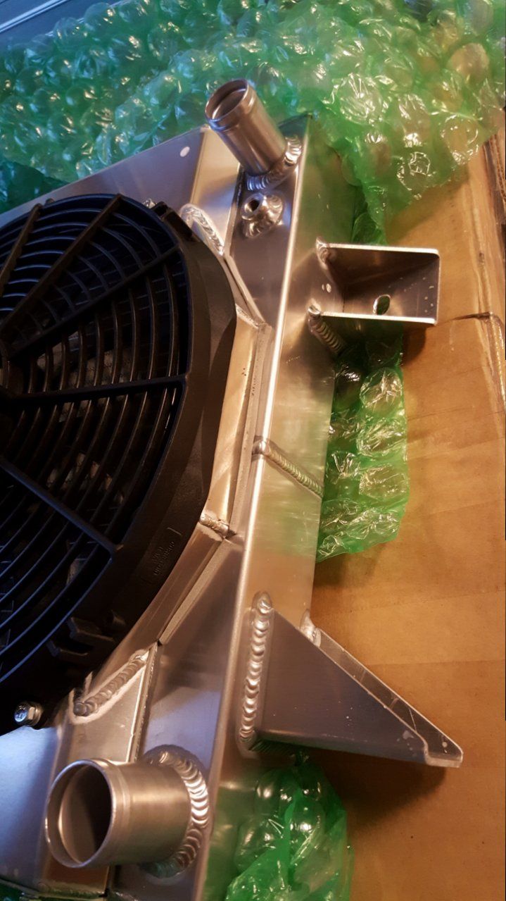

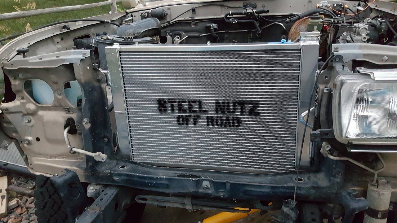

Steel nutz rad is in.... Did a quick fit and a
few pics....

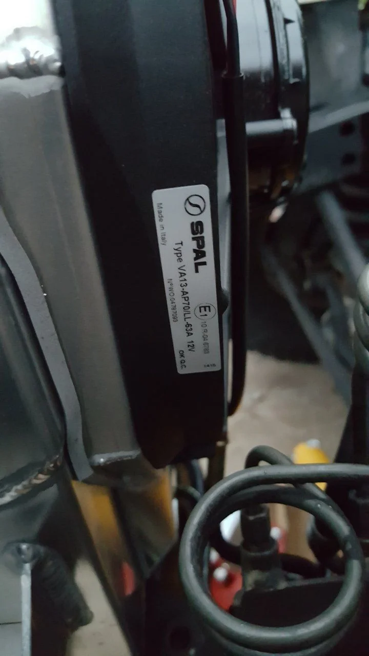

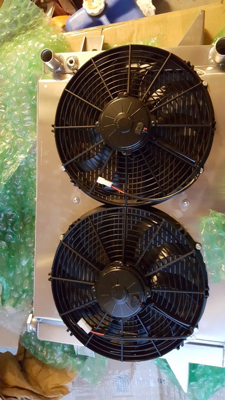

Looks like a nice setup, are those dual 14" fans? I could look up the part number but I am lazy and on my phone. lol.
*Edit I became less lazy and looked it up. They are 13" roughly 20A draw and 1710CFM at 0" H20

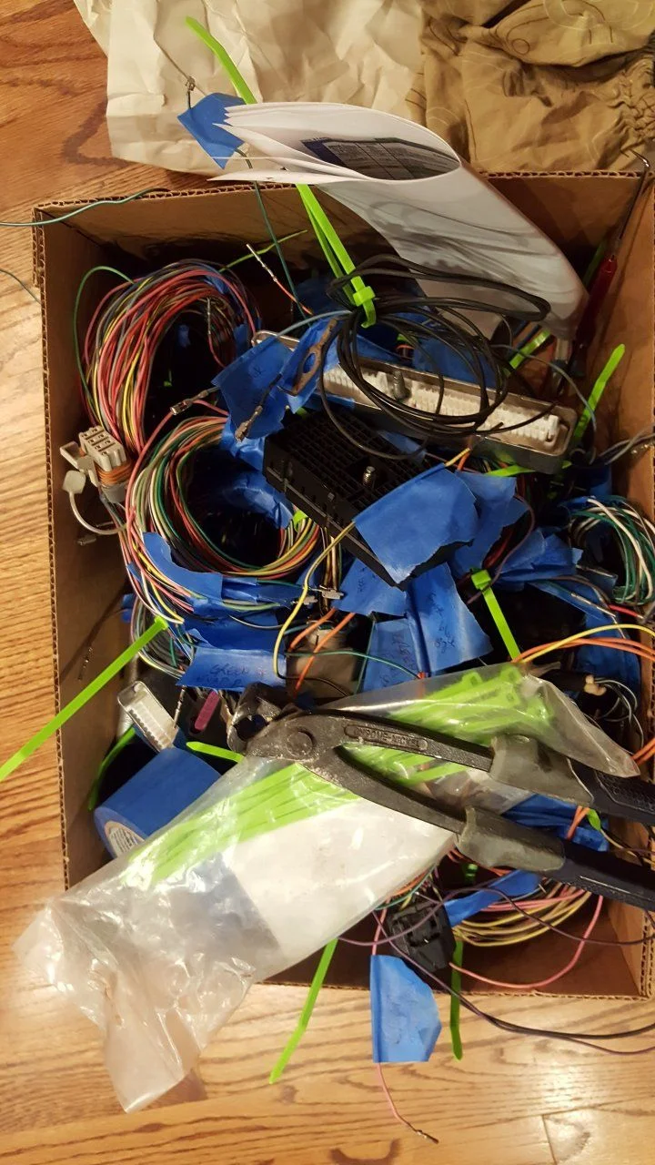

Going the unpin everything route.... Took about 3 nights to totally take it apart. Hopefully it speeds up the trouble shooting in the long run....

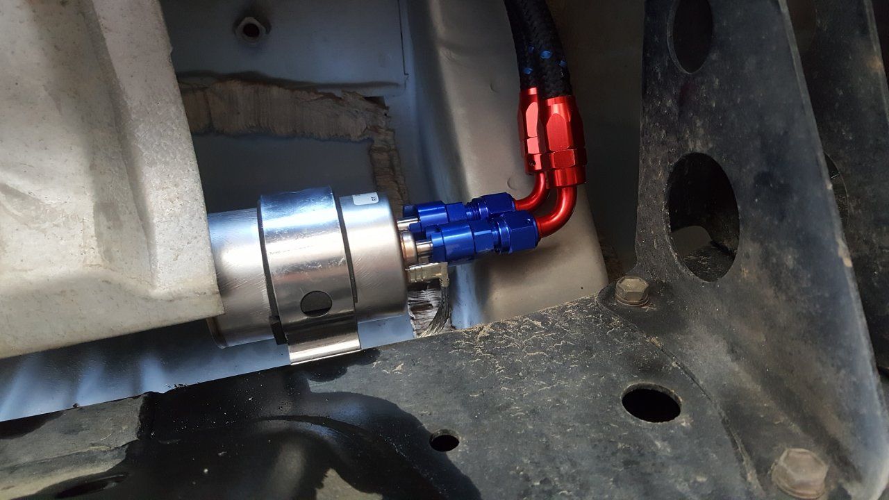

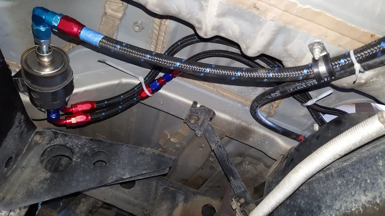

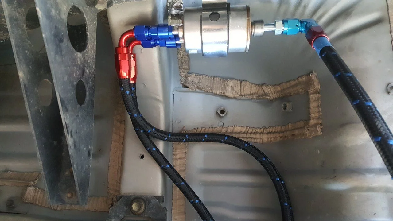

Got the fuel filter set. I think it should be out of the way enough to change if needed...
Looks like a nice set up!
Also looks like you have a return line on the intake (can't see) and your using the return less fuel filter.
Any details?
I have never seen how to properly plumb that fuel filter set up.
no return at fuel rail. just an input. I can't remember what year the gen 3 vortecs went this route. I think it also depends on if it is e85 as well....
the "corvette" filter also regulates the pressure.
1) Pump to filter, 2) return to tank, 3) filter to fuel rail.

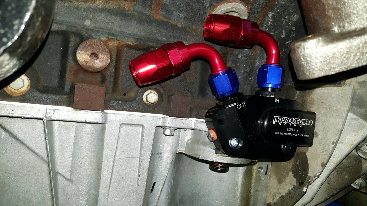

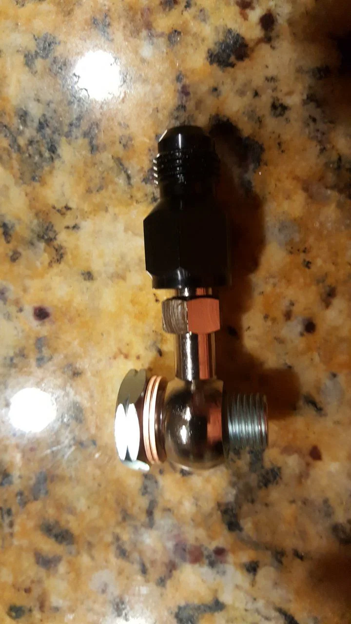

Some random fittings arrived.
That banjo to AN fitting is cool, I had not seen that before. Good luck with Summit helping you too much on the pushed dates. I had those Whiteline sway bars and the date kept getting pushed for months. They weren't all that helpful which I was surprised about because they are usually really good.

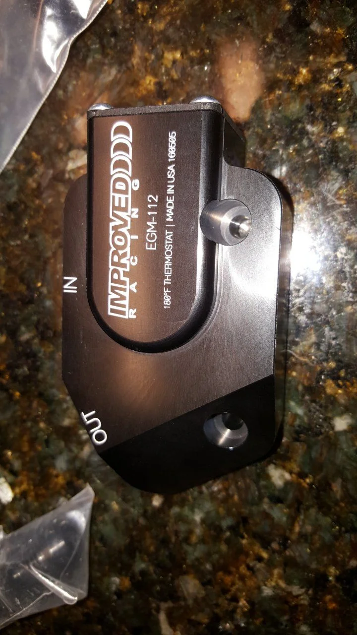

A few goodies showed up today....

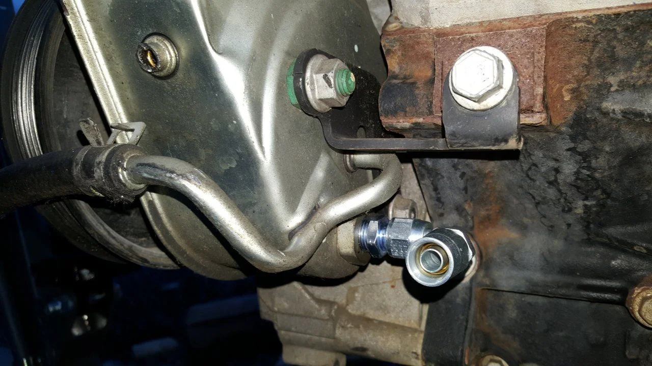

Will be tough to drain the block on this side....
My eBay fitting is just right :)

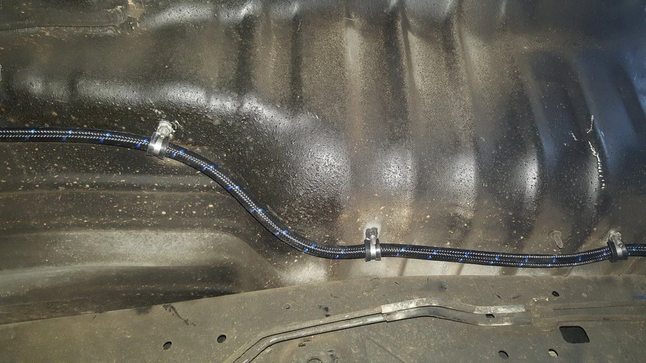

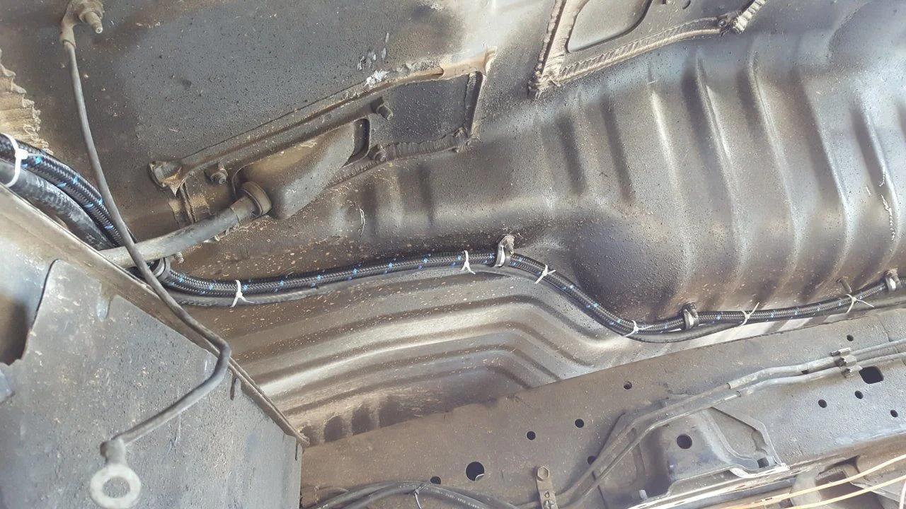

Ordered some stainless P clamps for the fuel line. Zip tying the evap line to the fuel line should be ok?

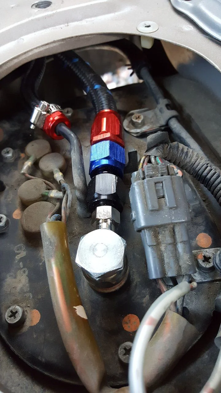

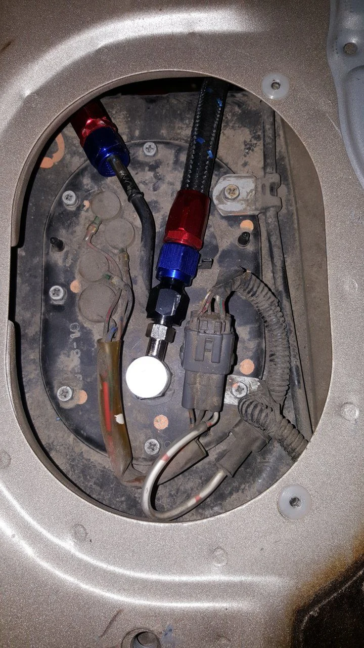

Fuel system is buttoned up under truck....here's to hoping nothing leaks.
