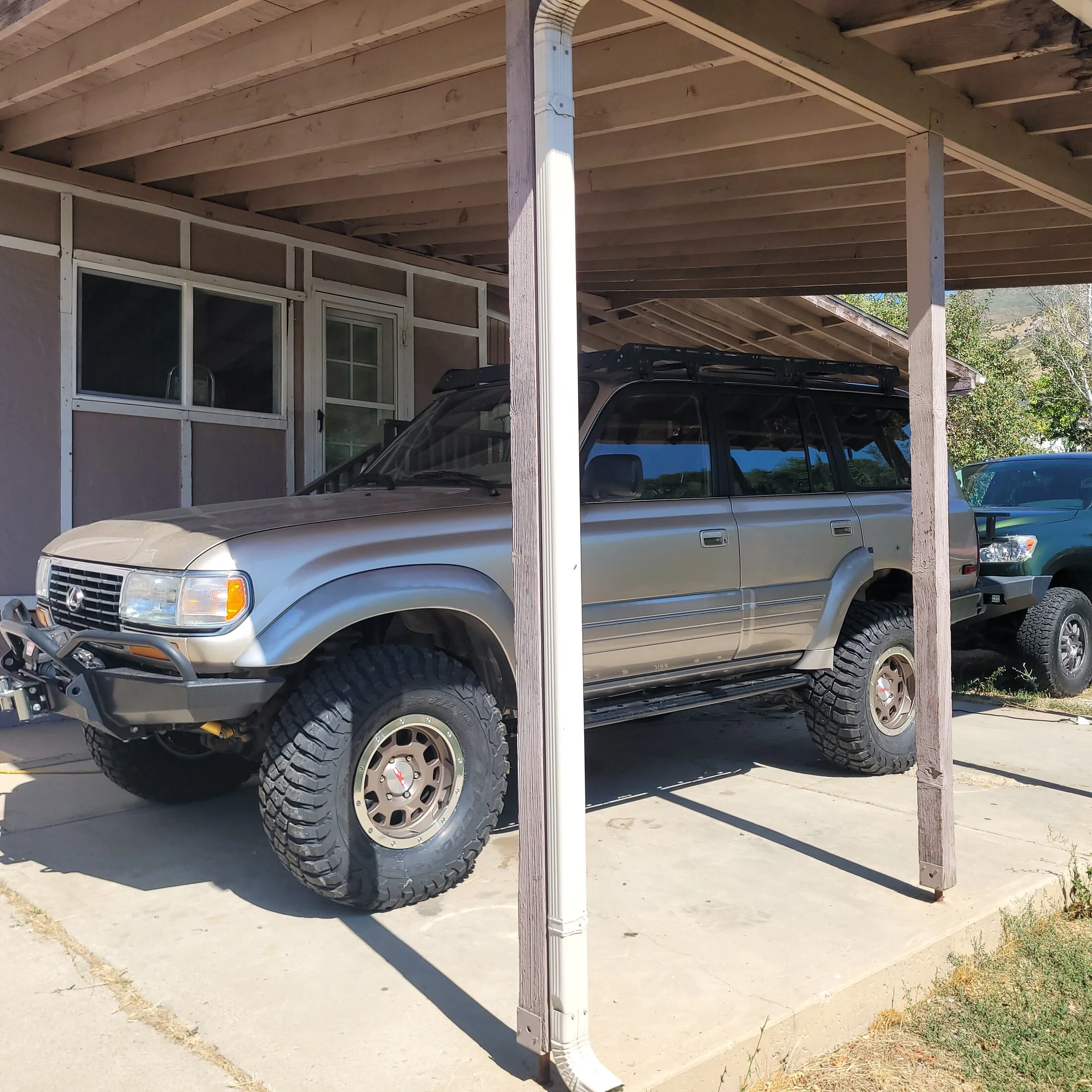

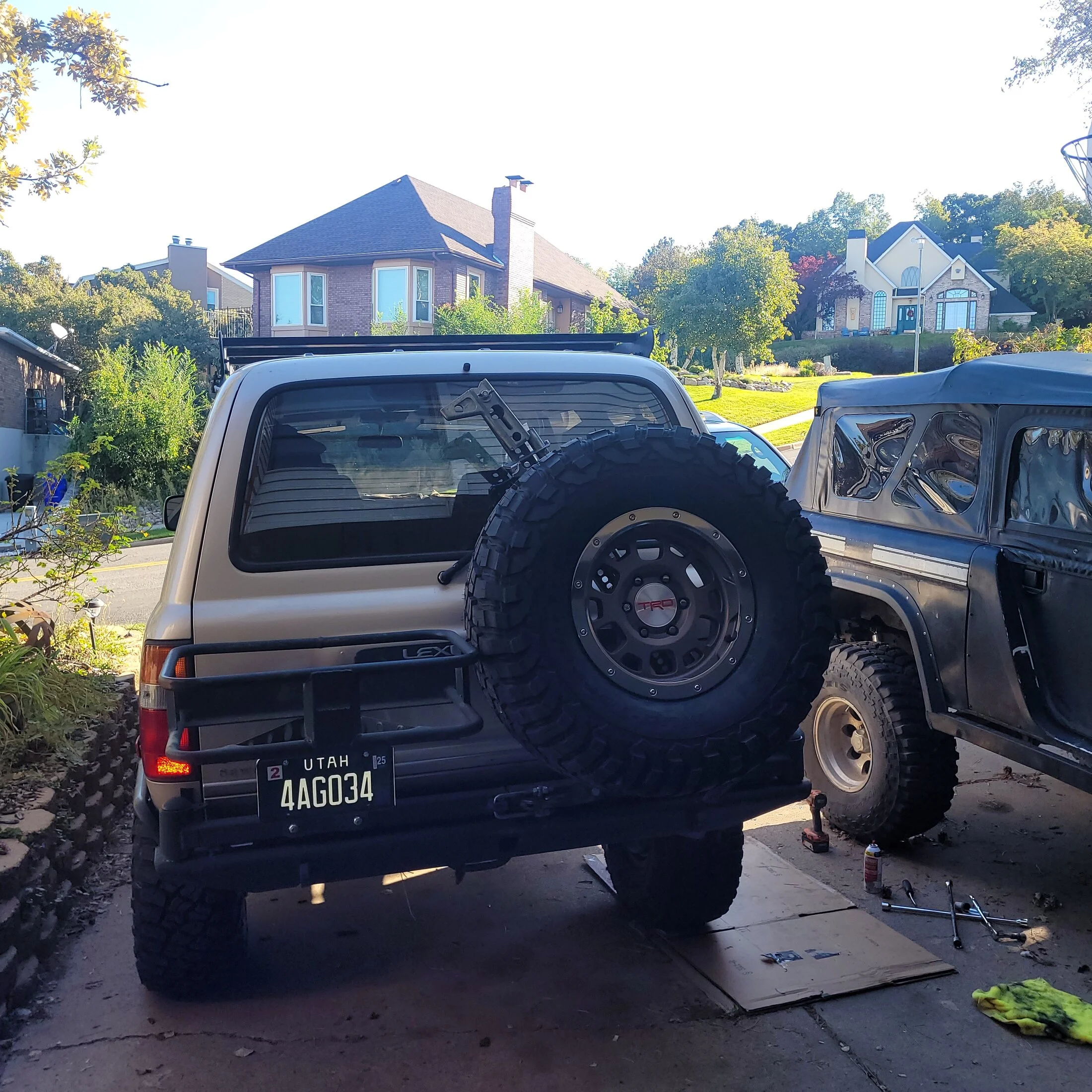

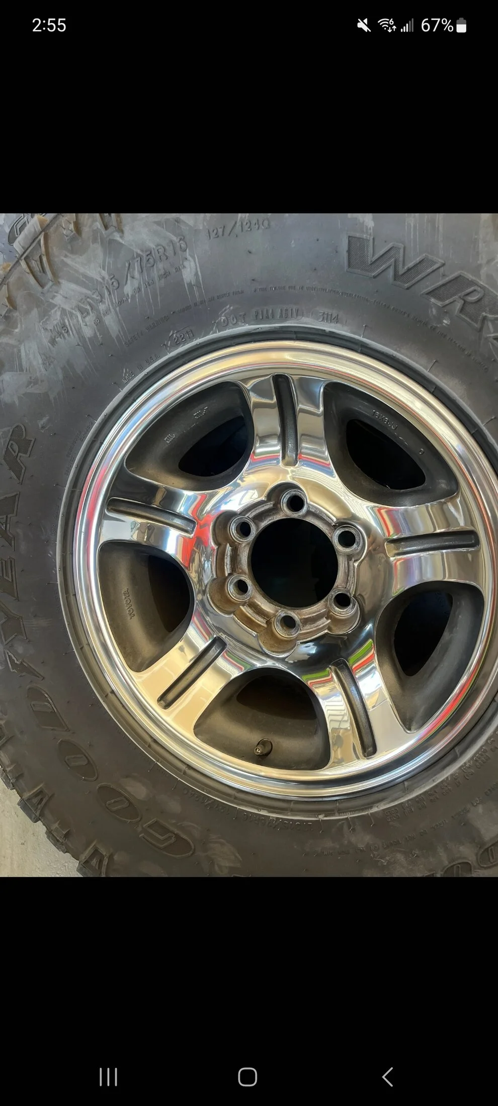

Put on some fj cruiser trail team bronze wheels with some 315x75x16 km3. Had to run 2 inch spacers to clear the center caps. Also got the stock wheels polished. Found a local guy that polished truck wheels dropped them off and had them back a week later, turned out great. Have the same wheels on my 87 Ramjet Fj60 and my 77 Fj40. Next up I need to find some skid plates debating on some delta skids or also open to some other options.
