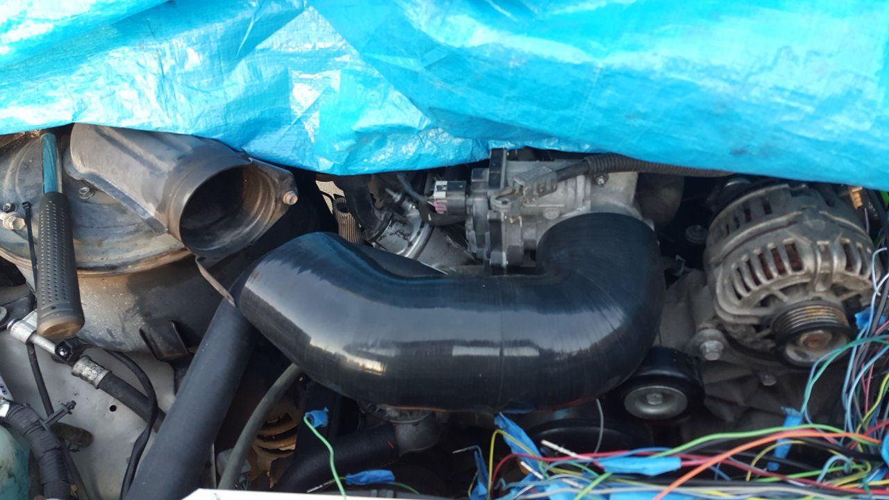

I'll need to trim some hoses, but looks like the intake will fit well in terms of angles. I've got a 4" to 3" reducer to go on the other end. Used eBay silicon fittings and was surprising not as expensive as one would think.

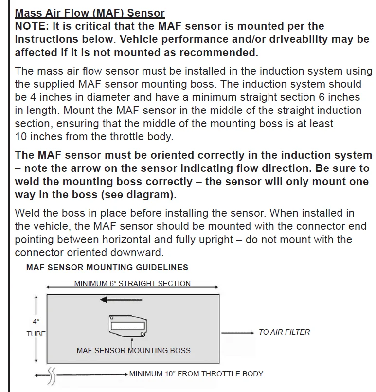

Why not just set it up with a mafless tune so you dont need to run the MAF sensor? I did that to mine and its good
is that one single hose or is it a 45* and a 90*?
do you have a link for that hose?
i imagine for emissions reasons, I know myself I intend on not running one, its going to suck in cold start applications but ill live with it
I don't really see the logic in this as the MAF is used to measure airflow and fuel calculations while constantly adjusting to improve performance. Maybe I am incorrect but IMO doing a "mafless" tune would be the same as just running a carb (in theory).. or am I missing something?
