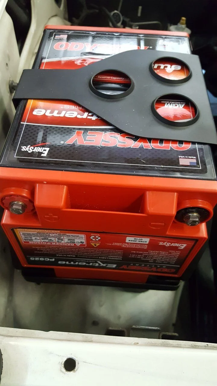

Some where in the 80 series production run, the battery box switched sides (1992?). So there are OEM battery boxes for either/both sides. Maybe your relays, PCM, fuse panels get a box of their own ?
So, what's the point of these huge and bulky plastic trays? Why can't we have something like slee makes for 200 series. Mike at steel nutz who made my radiator makes these at least for passenger side on the 80s.
you dont need a battery box, it is just there to make you feel better. mount it up how you want it. you can even move them to the rear if you need space up front.

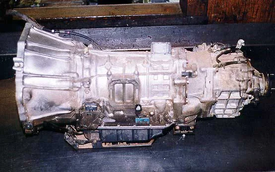

Ok, I emailed them, then I realized the issue....my lx450 has a a343f transmission and mark's looks to have built their things for a442f transmission....
The battery box is supposed to help seal the heat from the engine bay from the battery. They are actually pretty nice with the rubber seal against the hood. Heat kills batteries and the 80's engine bay gets so damn hot! But I think with a vortec swap you will actually be cooler than with the 1FZ.

I may have an A442F with only 82k miles for sale very shortly and I am only 15 minutes away from you!

he doesnt need a trans lol
I got that after we spoke in pm's. I was up late last night trying to catch up with his thread when I came across his shifter problem. I should have read a little being that looking at all of the pretty pictures didn't tell the whole story. I remember as I was typing that response, I wonder why he is using that trans!

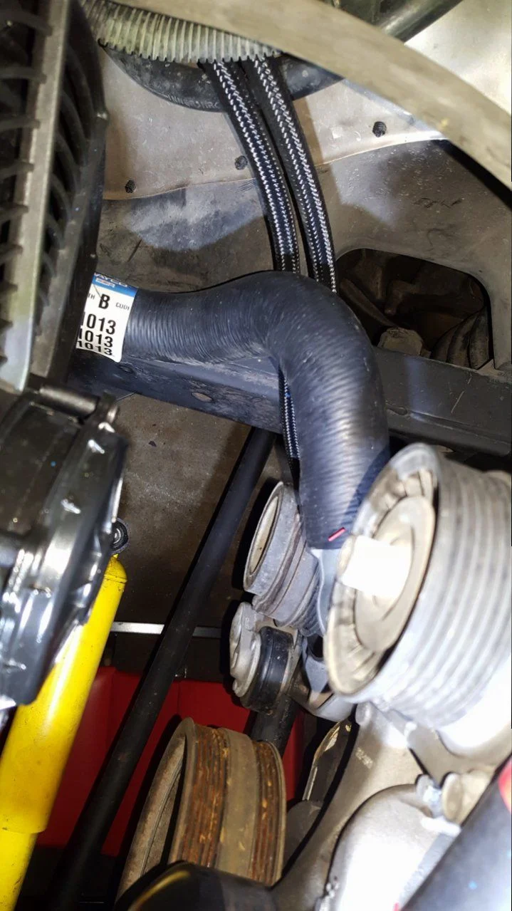

Found some radiator hoses that fit....
Dayco 71013 for lower, 71965 for upper, upper needs to be trimmed and it will get pulled down a bit to make room for intake.
