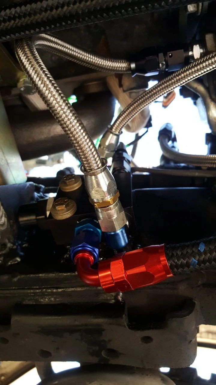

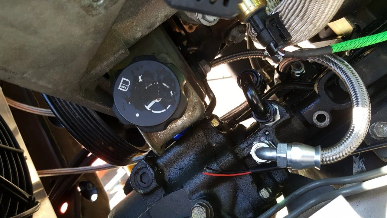

I'm going to regret the heidts regulator on power steering system, but it is in and plumbed. Working on the oil/trans/power steering coolers.
What was the purpose of the heidts regulator? Does the Toyota box need pressure reduced from GM pump?
@bloc, I believe the GM pump is much higher P, steering box will be fine, but can candy cane the steering link? I can easily remove if I don't like it.

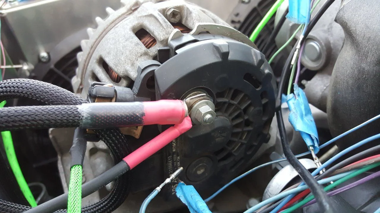

RE: wiring alt and starter - I plan to run 8 ga fusible link from battery to alternator (pretty short run), then 4 ga from alt to starter. Any reason this shouldn't work. That way, I just need to replace the fusible link from the battery to the alternator and everything should be protected??????
whats nice about the power steering regulator is you can fine tune your steering feel to your liking! I know myself Ill be running a hydro assist while im at it to help with my 37s lol
You'll need to work on the hydro boost return line, passenger side firewall and the steering box. I had to cut my hydro boost line, tap and then welded bolt in. It is a very tight fit and if you retain hydro boost you may need to relocate pump.
i plan on tapping my steering Box, for the hydroassist, the hydroboost off the pump im hoping to retain and switch to hydroboosted brakes

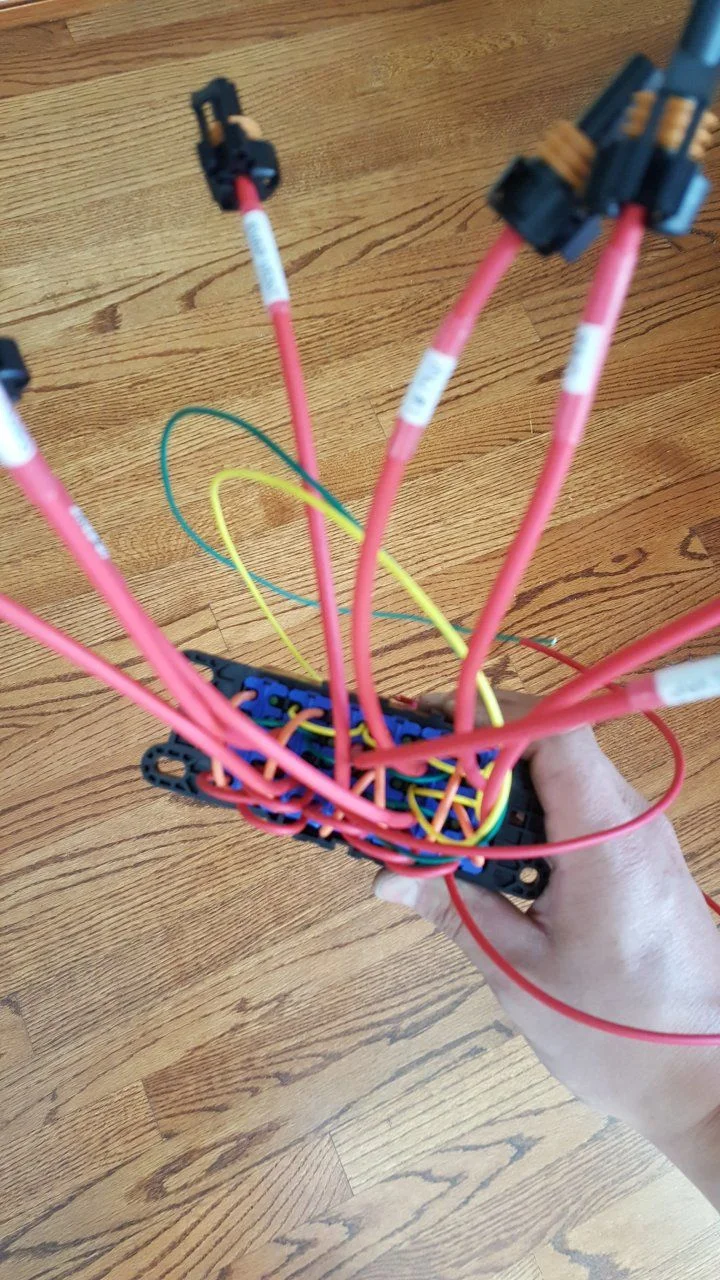

Finally finished my Fuse block.

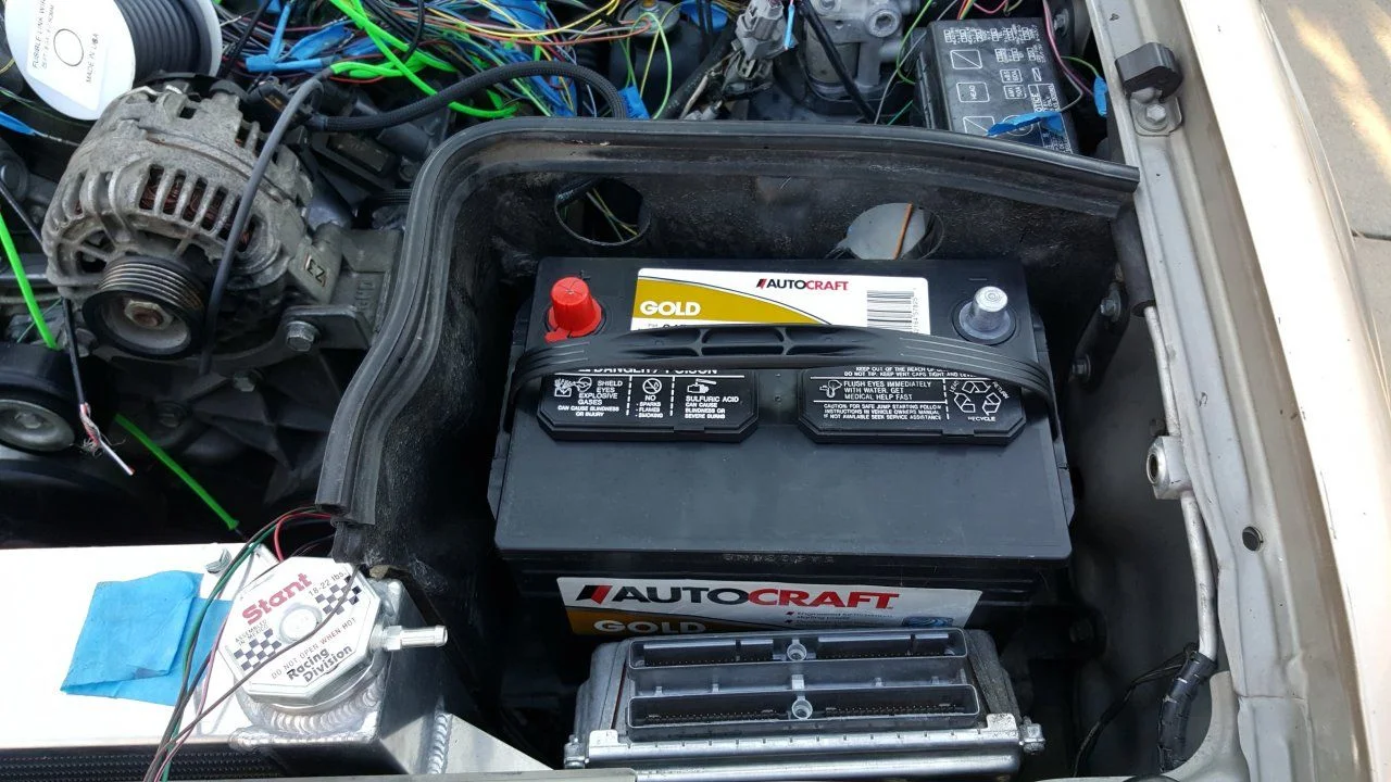

So, spent about 2 hours last night and an hour this morning trying to figure out why I had no juice in the cab. Everything checked out when I grounded back to battery. Note for noobs like me, battery must be grounded.

Alternator wiring. 8 GA fusible. Battery to alt. 4 GA alt to starter.
Battery with pcm.

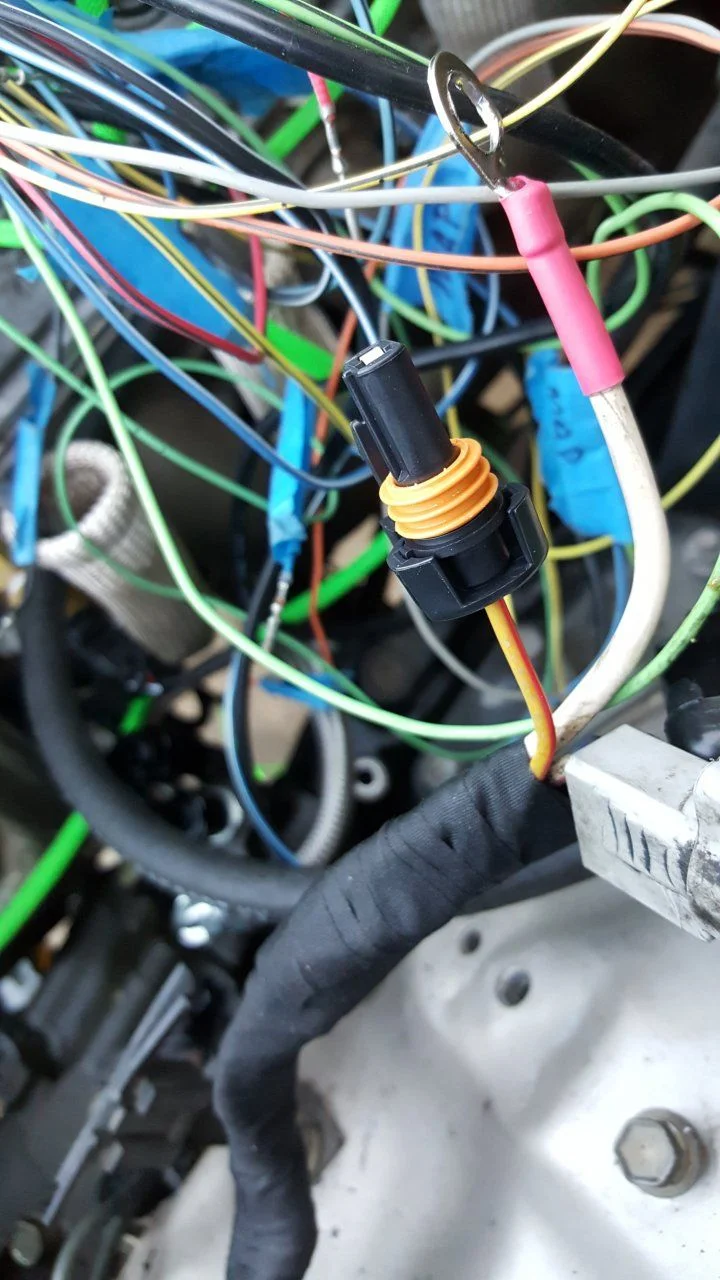

Metri pack on Toyota efi wire. This feeds juice to my fuel pump.

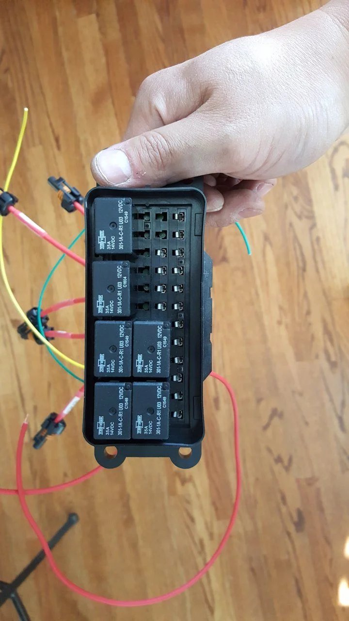

The fuse block I built vs current performance fuse block. I have a second I will add, which will add 6 relays and up to 12 additional hot all the time fuses. My 2 blocks will be about the same size as the current performance. Not quite apples to apples, as current runs 2 fan relays, starter and fuel pump relays. But, my relays aren't as loaded and I can easily add with my second block, plus a few extras. My block will also be ip66 water resistant.
Are you labeling your wires, you probably are but this one is a favorite one of mine: Cable Ties and More Just a FYI.

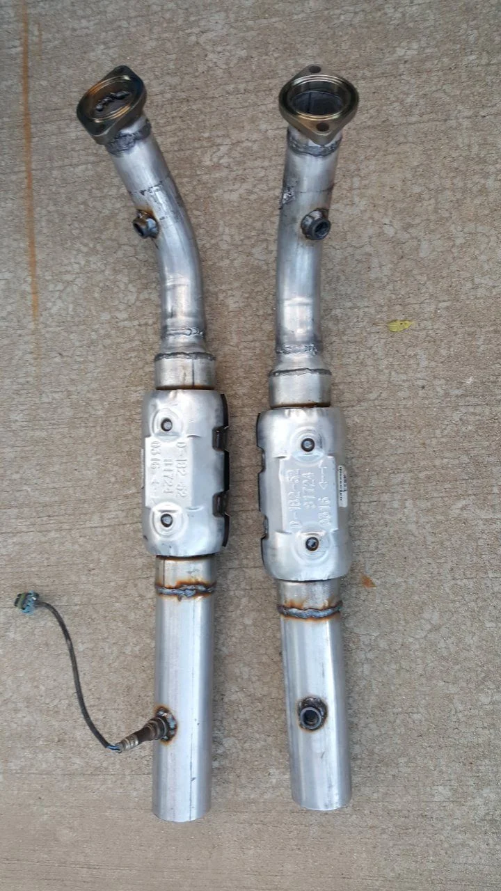

Spent the day doing exhaust to the second o2 sensors. I'm really bad at welding, but it is passable. Curious, anyone know what flange gasket for the hooker 8501 headers? The bolt Size is 10x1.5 for those looking around for such info...
Just need to run a few more wires and then rerpin everything. Then the moment of truth....probsbly at least 2 more weeks...
Starter cranks. Finally found the correct oil filter for the F body pan. AC delco pf48.
Hooker 8501-5HKR Hooker Exhaust Manifolds - Holley Performance Products
  • 2 bolt exit flange configuration matches 2010 Camaro (also the same as the E-rod exhaust manifolds) which can be used with OE gaskets and fasteners if desired, for an OE quality seal
